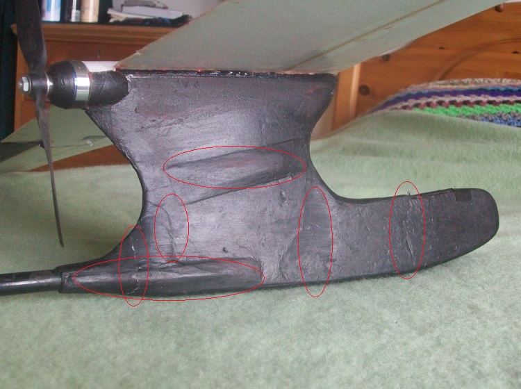

This embodies quite a bit of what Depron building is all about.
Light & low powered (100W) yet with a sparkling performance and a substantial cruise duration (45 minutes).
It is probably my most reliable flyer (yes its 35mHz!) and despite its light weight it is fast enough to handle quite a bit of wind.
But it is getting rather old for a 'foamy' (over 3 years) and the fuselage in particular has been repaired and patched many times.
So keeping the same dimensions it will have a new fuselage and tail but hopefully incorporating some improvements in its construction.

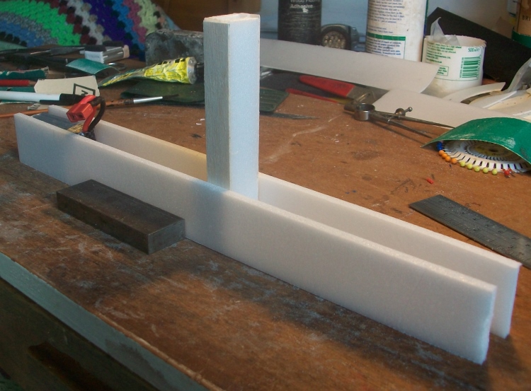

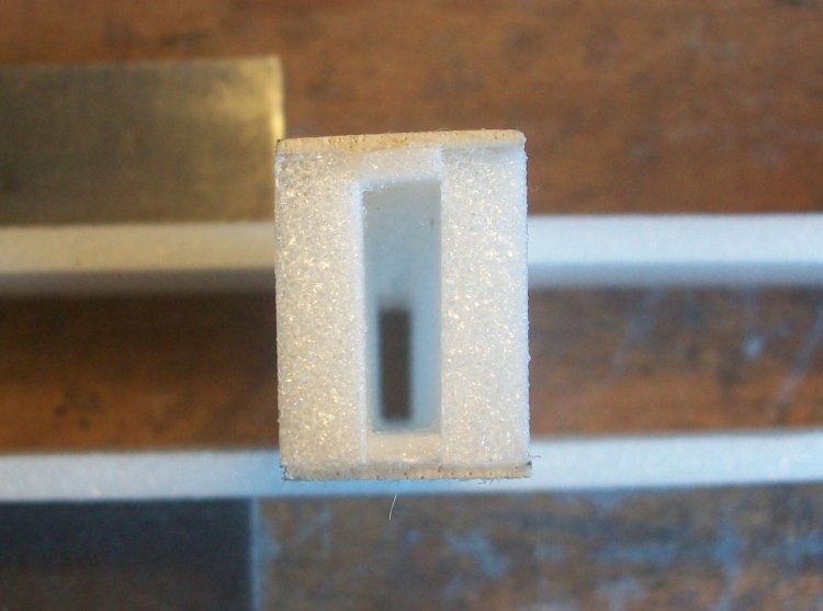

The basic fuselage.
The wing pylon will have a substantial balsa/Depron/balsa spar which the original did not.
A wing pylon does not suffer anything like the bending loads of the wing root but does suffer a huge twisting force if a wing tip hits the ground in any sort of 'arrival' landing.
The fuselage sides will use 6mm Depron rather than 3mm and is sized to exactly hold a 1500mAh 3s but with no other reinforcement to allow the Depron to give a bit in a less than perfect landing.

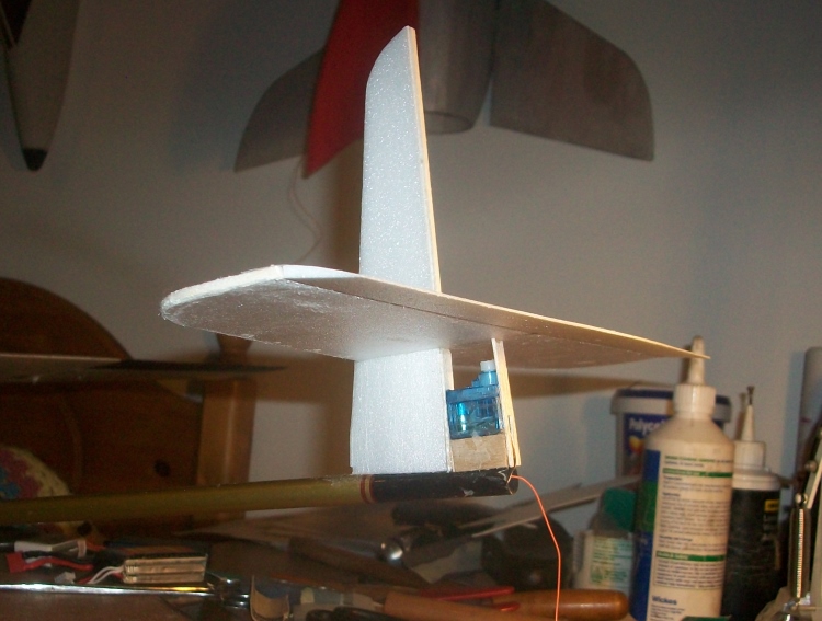

This where you think I had a perfectly good plane this morning............
The fuselage destroyed, the parts liberated and the old boom now fixed to the base of the new pylon spar.
Note the tiny 4ch full range Corona radio and the 3.7g elevator servo that will be built into the base of the fin.
Finger crossed it should all be 'building' from now on.

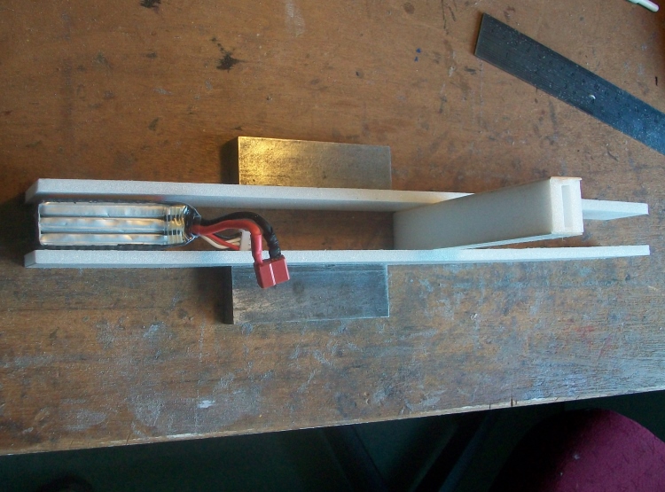

The basic fuselage built onto the old tail boom.
The battery slides from the hatch up into the nose. That way it can't fall out!
The radio and ESC installed.
Not ideal side by side but it is a very low power installation. The low power also means I can get away with no ESC cooling.
The 4th channel will be available for the recording altimeter.

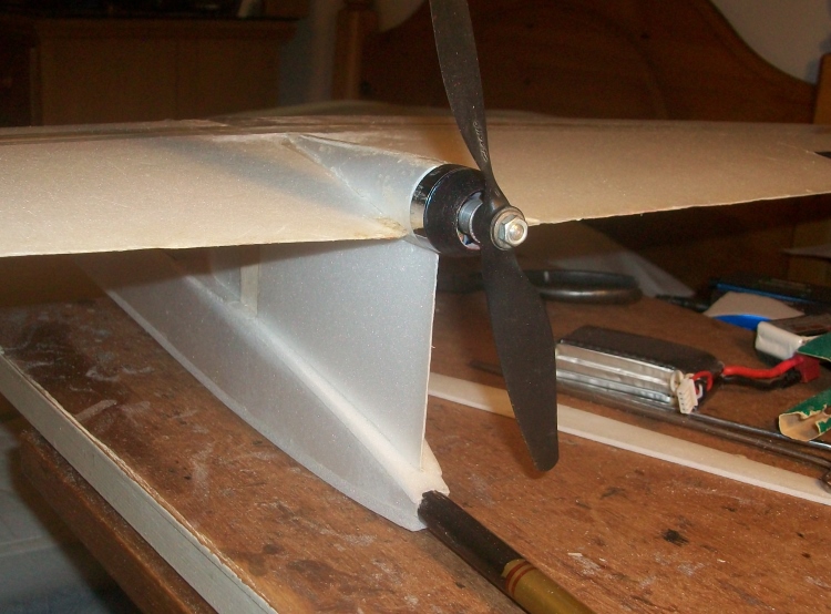

Starting to almost look like it was.
The new fuselage mounts the wing almost 2" lower.
But still gives clearance for the prop - just!
The total frontal area is thus slightly reduced although the fuselage surface area is more or less the same.
I have set the fuselage axis almost parallel with the wing datum so it will fly slightly nose high at slow speed. The original was set parallel to the tailplane datum so the fuselage was more in line with the airflow when gliding.
It is now set more like a power plane than a glider but I doubt very much I will be able to distinguish any difference!
