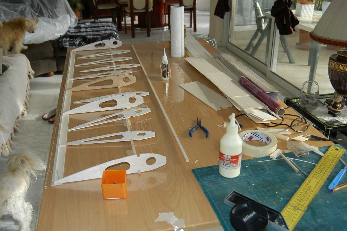

Had a go at the wings today after i finished the jet

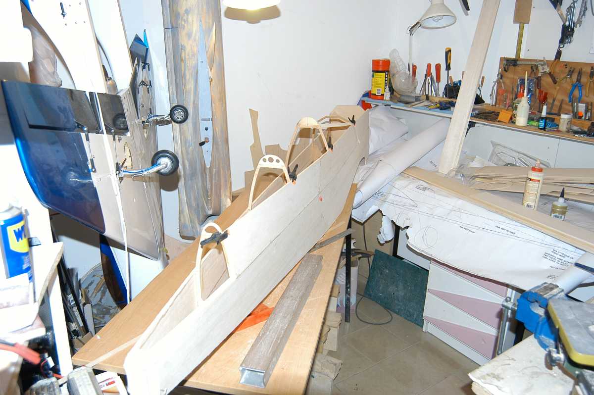

Been playing around with the canalizer and the hatch
Just making the plug for the hatch from blue foam then ill make a fibre glass mould and then hopefuly a fibre glass hatch :unsure: :unsure: :unsure:
You can see where i have put filler in just below the canalizer,the wind got hold of it outside on the bench, i made a grab for it and fingers and thumb went straight through it, just the down side to working out side in the SUNSHINE B) B) B)

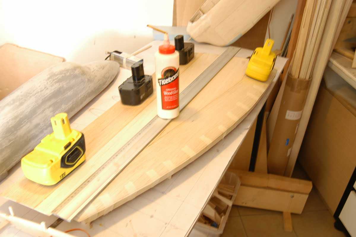

Sheeting the top of the wing, i put the sheets together first with tape and thin CA then fit it in one sheet
The frame for the servo hatch

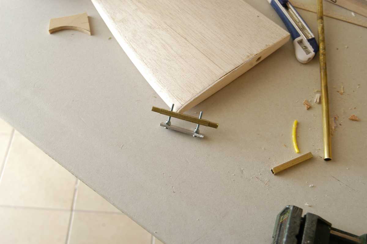

Made some incidence ajusters for the wing and tailplane
The tail plane one
