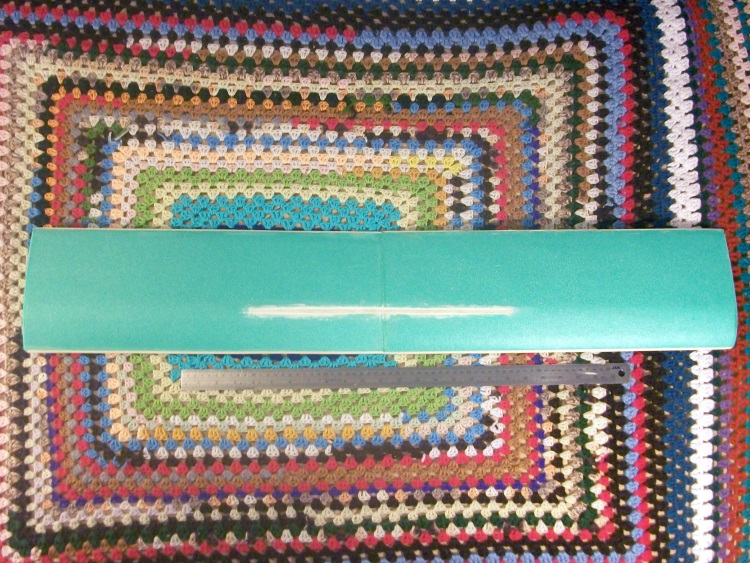

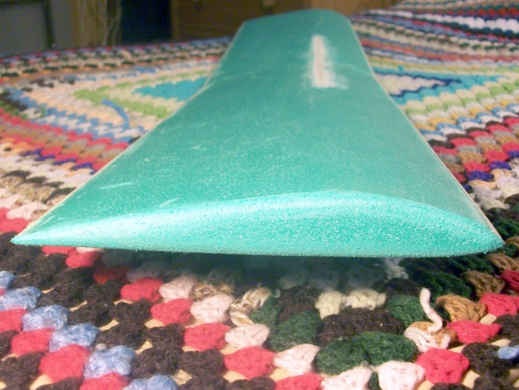

A simple 'test' wing.

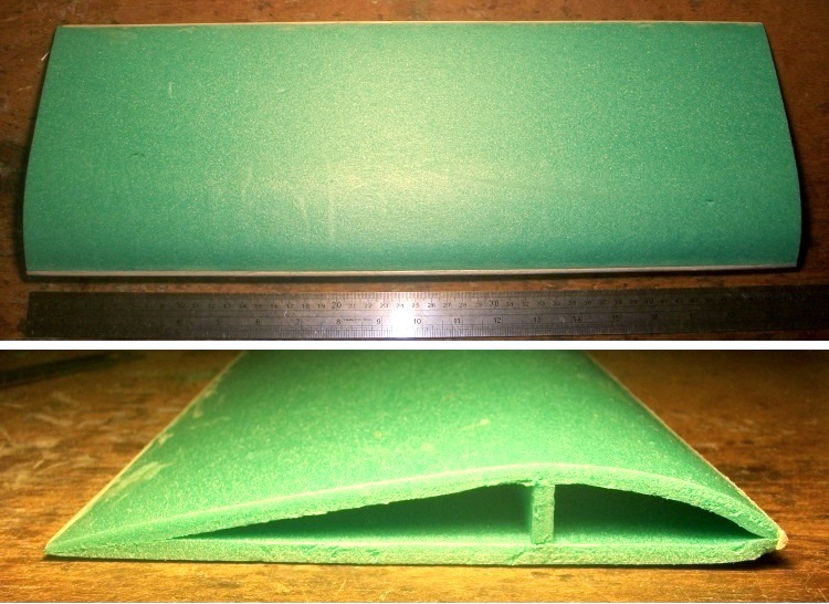

Quick to make using just 3 pieces of foam (no ribs) it relies on the relatively thick skin to hold its fairly accurate Clark Y section. It has a span of 500 mm and represents one half of a wing.
It has a balsa leading and trailing edge to give some protection to the rather soft foam. It weighs 29.2 g.
Not really intended to be flown but simply to find out what the material is like to work with.
Without any reinforcement it does have limited strength but such a relatively thick section 'rib less' wing does rather cry out for something to be put inside it - batteries maybe?

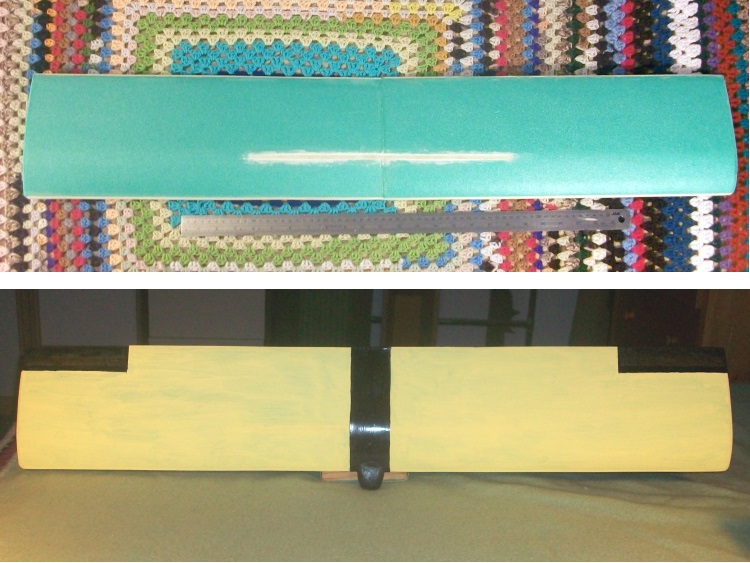

For no particular reason other than I had a bit of time spare waiting for some bits I made the other half and joined them together to make a complete 40" wing.
A 1 mm balsa strip has been "inlaid" into the foam top and bottom (exactly above the web) to make a full depth balsa/foam/balsa spar covering the inner 1/3 of the span where the bending loads are highest. In fact the balsa strip is tapered to zero thickness at each end to avoid the stress raiser!
The ends of the wing are simply capped with foam.
The rest of plane? I don't know - maybe!

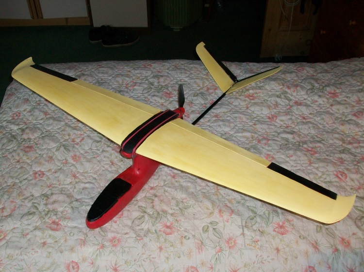

A short video of the 'Underlay Wing' maiden.
Pretty turbulent so nothing very spectacular.
More to the point the wing didn't break!
