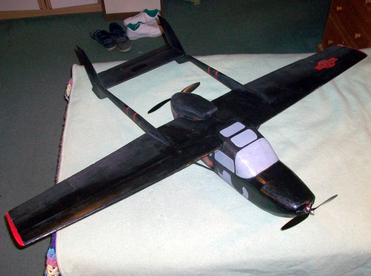

The Cessna O-2 was the military version of the Cessna Skymaster and was used in Vietnam as a forward control observation plane. Mine is a 'special ops' night version all black with low vis markings.
All Depron apart from balsa spar flanges means it is very light (646 g or 22.7 oz) for its size (1320 mm or 52" span) and as a result the 300W available gives 210W/lb or unlimited vertical.

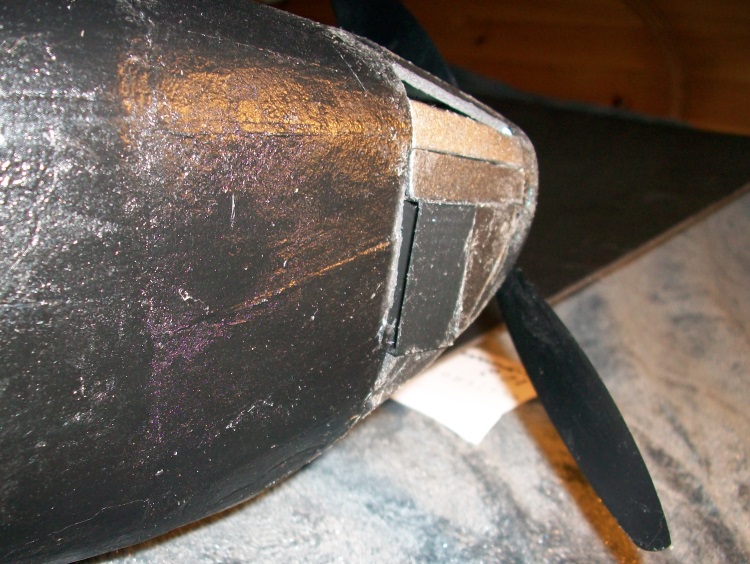

Next shows the nose block rebuilt, #1 & #2 formers repaired with the motor tube in place allowing a start to be made on the re-planking.
One advantage of the Depron skin carrying all the loads is that a simple butt joint with UHU POR is virtually as strong as the original material so no complex scarf joints required which makes life much simpler.

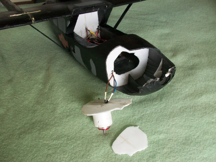

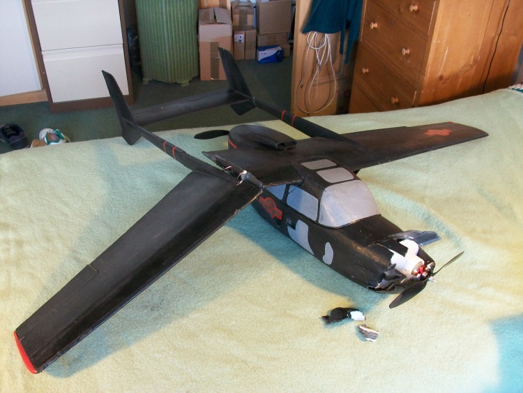

The 'other' plane I crashed at the 2019 Ashbourne Scale Day was the Cessna O-2.
It flew very well, twice and each time for a good 10 minutes but on the second landing I misjudged the speed. Not that surprising as the wind was close to its flying speed!
The result was a severe wing drop 'low and slow' followed by a 'cartwheel'. On a twin boom design that is never going to end well.
Nose badly crushed and motor dislodged, although it did not break the prop.
Each boom was broken off in two places but now glued back on.
Without the tail booms in place the rear motor also took a knock and broke free. Part of the skin had to be removed to get at the bulkhead to re fix it.
I probably should have taken the opportunity to scrap it like the Natter but it simply flies so well.

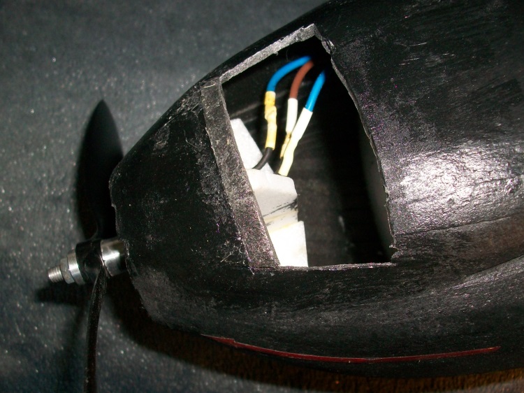

Certainly clever stuff this 3D printing,very useful, no good me getting one i have enough trouble with my new fangled phone
- Posts: 10058
31 Oct 2018 16:53 #10
Replied by Quorneng on topic Depron Cessna O-2
Thanks: Phil Wood, Klipkopwildlife, THE BLACKBIRD
01 Nov 2018 16:57 #11
Replied by Klipkopwildlife on topic Depron Cessna O-2
I suspect that 3D printing of parts will become the norm in years to come. A printed part is so much stronger than its built up counterpart although a tad heavier.
