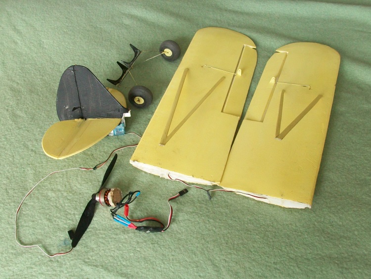

Only the wings, tail remain and undercarriage.

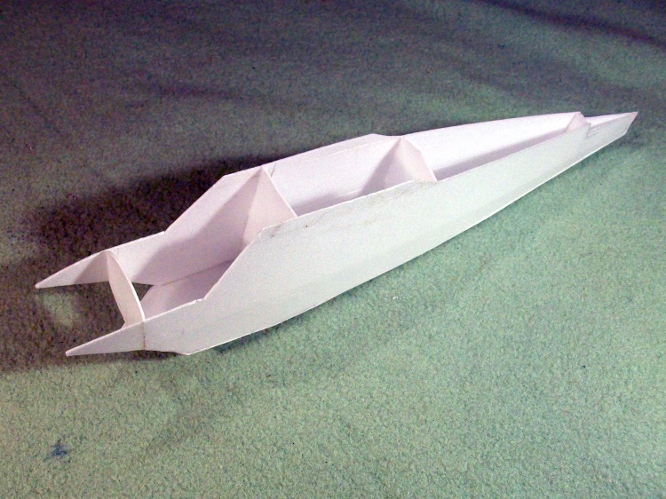

The new fuselage under way.
A true monocoque construction so far all built from 2mm Depron, even the rather unusual 'tube' motor mount.

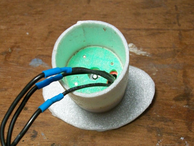

The Emax 2805 motor is screwed to a 'printed' bulkhead glued inside the tube.
The motor tube will be glued in between the first two fuselage bulkheads.

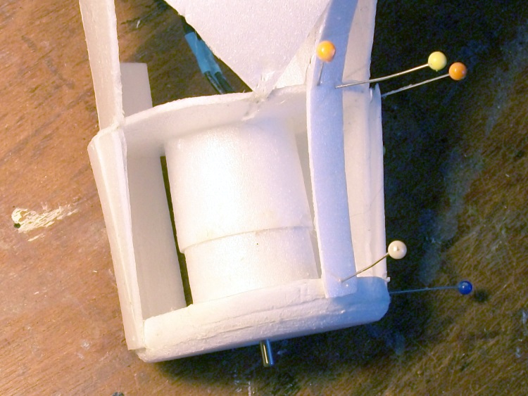

This picture shows how the tube motor mount is built into the fuselage.
In effect the motor is suspended off the back of the thick (relatively!) Depron nose block, which is by far the strongest 'bulkhead' in the entire fuselage. The nose block thus transmits the thrust and torque of the motor into the fuselage skin. ;)
The motor tube also extends back to the first true bulkhead to give horizontal and vertical stiffness to the motor mount. In this way, apart from the 'printed disk' motor mount which itself is a hollow matrix structure and is only 2mm bigger in diameter than the motor bell, the entire fuselage is just Depron. ;)
In hindsight I could have printed the bulkhead to incorporate the 'drum' motor mount as well and saved a few more grams.
Perhaps next time!

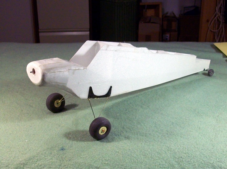

The fuselage now sits on its 'salvaged' wheels.
But only just as the fuselage only just counters the weight of the 26g motor!
Next job is to make up some bigger (2.5") 'Alaska' wheels for it.

Hopefully a picture. ;) Now with its big "Alaska" wheels and the elevator servo installed.
Despite their chunky size each complete wheel weighs only 2.5g. ;)

Now pictures are enabled this is how the Supercub ended looking like.
Still some minor paint touch ups to do.
