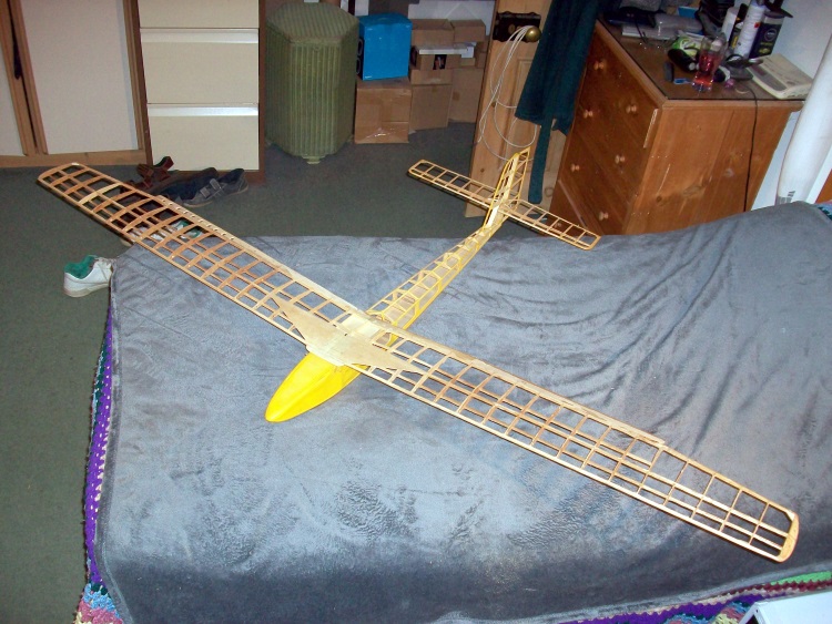

28 Apr 2019 22:13 #10 by Quorneng
Replied by Quorneng on topic A possible very old glider conversion
All the tissue stripped off.
In this state it weighs 197 g (6.95 oz).
Covered in doped light weight tissue, a motor and all the electrics 400 g (14 oz) looks possible which would give a wing loading of 4.2 oz/sqft.

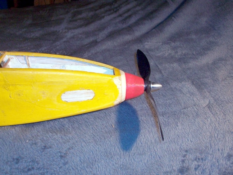

Before much (any?) covering goes on the electrics have to go in.
First the motor with its printed mount.
Initially a fixed prop as it is simpler and lighter.
Light and carefully stream lined the mount allows cooling air to pass through the motor.
With an 8x6 it draws 9.5 A giving a modest 65 Watts on an 1800 mAh 2s which should give a good 10 minutes at WOT.
Elevator and rudder servos next.
Last edit: 30 Apr 2019 22:59 by Quorneng.
