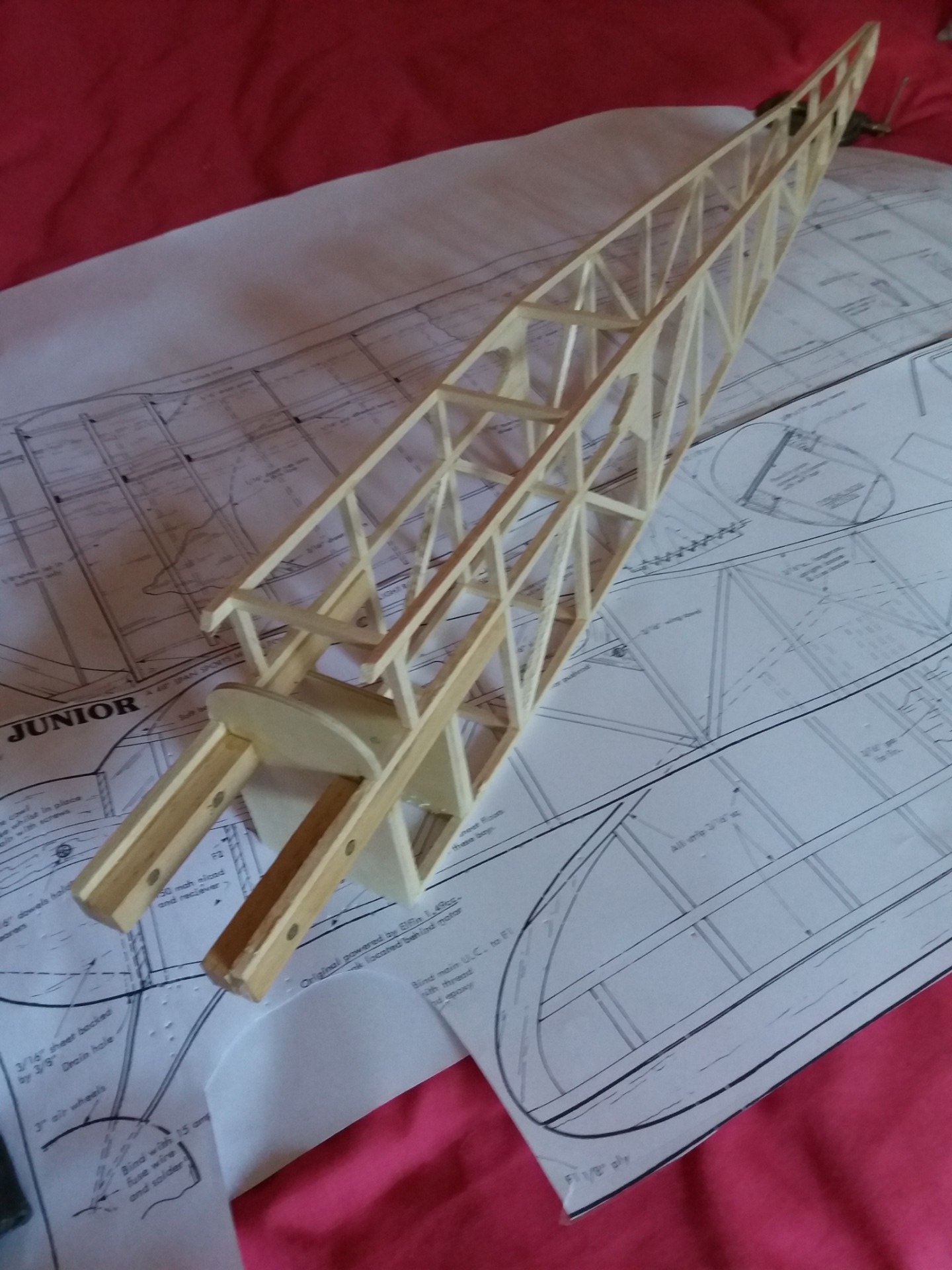

Always been a fan of the original junior 60, built and flew it's larger brother "Majestic Major" years ago, had it for about 7 years and had hundreds of flights with it until a mid air with a out of control scale model totalled it ( flown by my then club chairman).
With no space now to store a large model I thought a just junior may fit the bill , it's a 75% scale model of the original 1946 J60.
After getting the plan printed via outerzone ( such a great resource) I've put scalpel to balsa and made a start on the fuselage.
Also began gathering a few bits and bobs needed further down the build, with genuine "airwheels" being ridiculously expensive now I've bought a pair of 3" du-bro wheels and tyres that I will make aluminium hub caps for to replicate the originals, also discovered that despite solarfilm products being discontinued you can still get the whole range from solarfilm direct, litespan in my opinion is without doubt the best lightweight covering ever made.

A little more work on the fuselage, bent up and attached the undercarriage, solder joints need cleaning up and I need to find some bushes for the wheels ( anyone got a lathe?)
cowl next then a bloody good sanding..

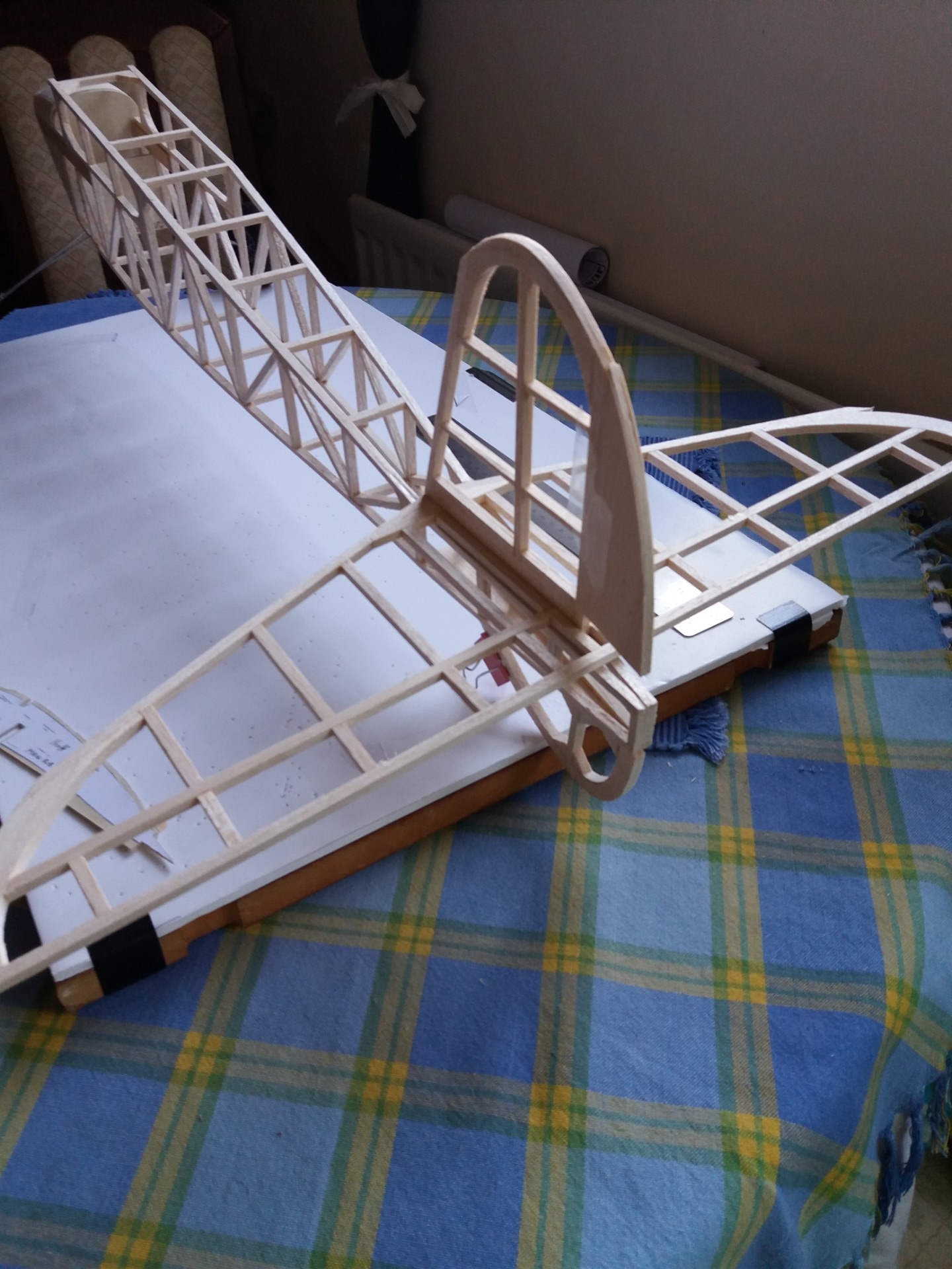

made a start on the tail feathers etc today, in a effort to keep the back end light I've made the rudder hollow rather than the slab of sheet the plan calls for, I plan to do the same with the elevator, paid dividends when I built the Caprice.
Tonight I'm going to try building the fin using a steamed strip.
Thanks: Klipkopwildlife, Flytilbroke, Quorneng, THE BLACKBIRD, crash happy
  • paul d
  • paul d's Avatar Topic Author
12 Jul 2019 19:47 - 12 Jul 2019 19:50 #7 by paul d
Replied by paul d on topic Just Junior
Well the laminated fin idea was a miserable fail! Ended up building it conventionally, picked the engine up today and my props turned up from Leeds model shop ( the only place I could find that had my preferred "kavans" in stock), Elevator tomorrow then a big sanding session before I start on the wing.
