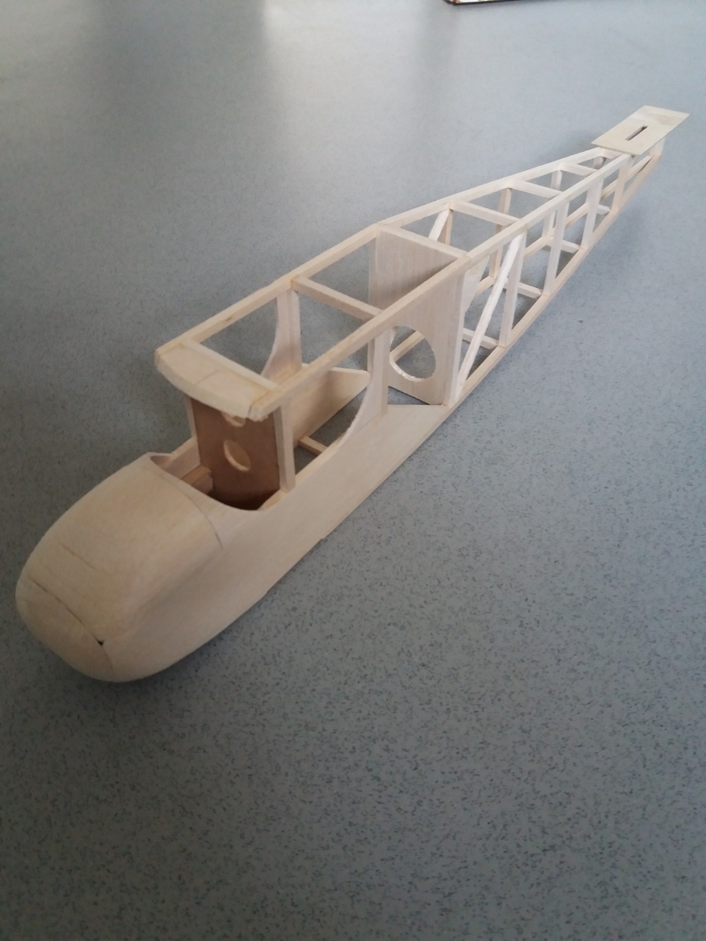

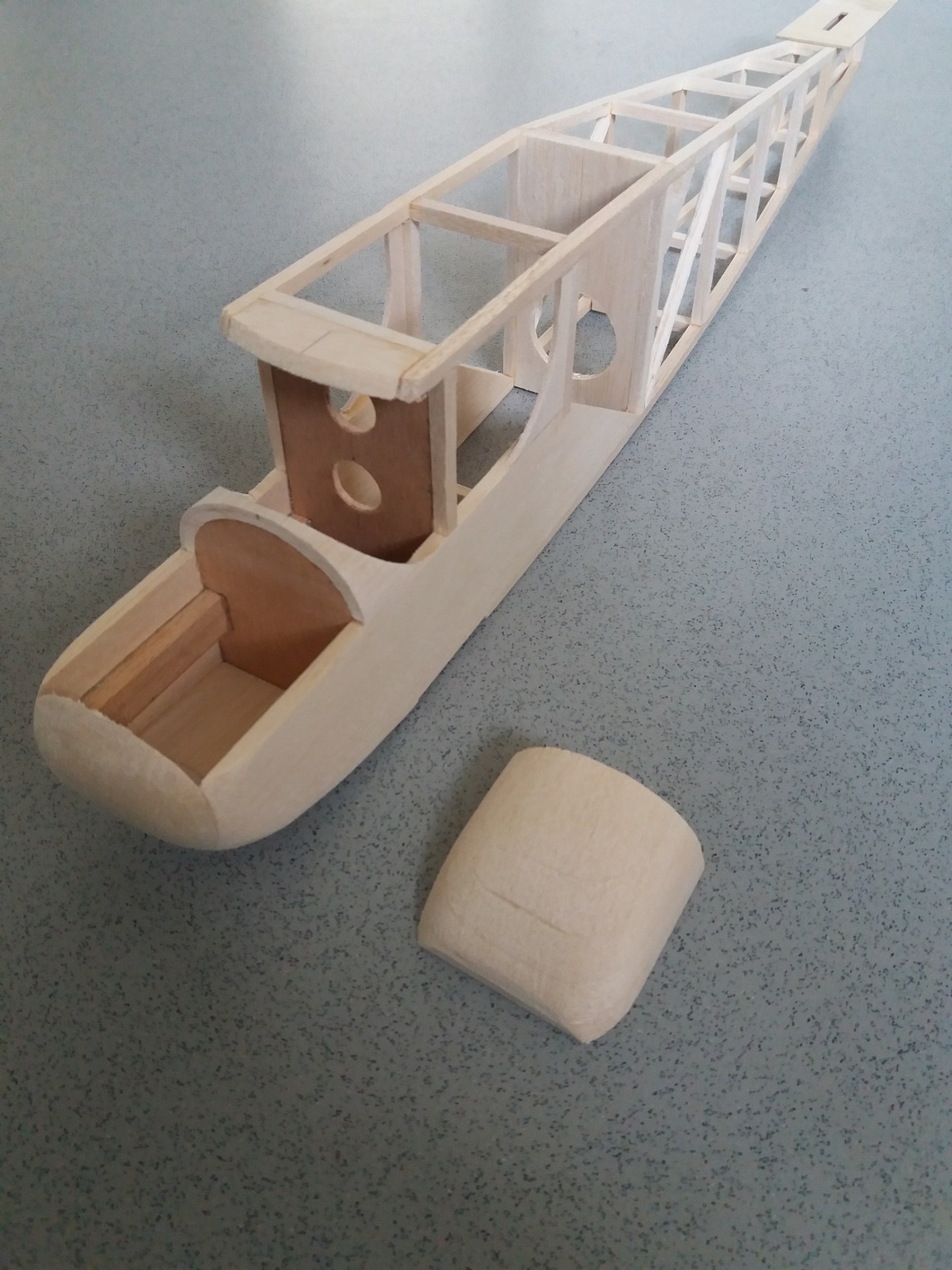

18 Nov 2019 16:32 #12 by paul d
Replied by paul d on topic Vic smeed "Gamine"
Think I posted about this project elsewhere but for the life of me I can't find it so here we are...
just about finished the fuselage, chunky little thing which is a good thing in some respects as I hopefully intend to enter next year's Bowden trophy with it and given the normal awfull conditions when it takes place it does need to be fairly crash proof!
Cowl needs hollowing out and cut to allow the engine to poke out.

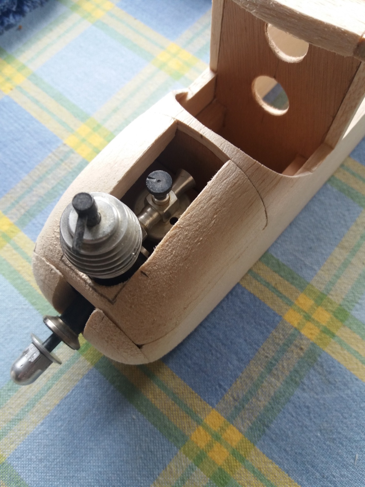

20 Nov 2019 13:10 #13 by paul d
so I've "rough cut" the opening for the engine to poke out of, while I can get to the mixture needle and fill the tank it's impossible to see the fuel level, didn't want to but I may have to run a remote external tank.
20 Nov 2019 14:41 #14 by Eric
Replied by Eric on topic Vic smeed "Gamine"
Just put a window in the side! :woohoo: There's a big hole in the top to let light in!
20 Nov 2019 16:32 #15 by Quorneng
Replied by Quorneng on topic For my next trick.....
Looks neat!
Just a thought but you may find the Mills slows down after a short period as with such close cowling there will significant exhaust gas ingestion.
If it were me I would be tempted to put a hole in the bulkhead and then shroud the venturi so it drew air from inside the fuselage.
