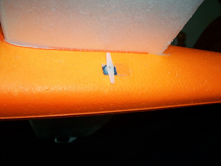

Although I do not have the specific battery but as it is coming from HK they do quote weights reasonably accurately.
With the motor, ESC in place and ballast confirmed that the elevator servo will not be required to provide a nose weight component so it could be installed under the wing and just far back enough that the pull/pull cables would not interfere with a hand launch.
This also allowed an accurate estimate of its final all up weight at 190 g.
Given that about 10 g of that is due to the aileron servo installation out towards the wing tip the actual bending load on the foam wing panels is very little more than in its chuck glider form.
It does bend a bit when picked up by the wing tips (4g bending) but still acceptable and with some reserve strength still available. :P
