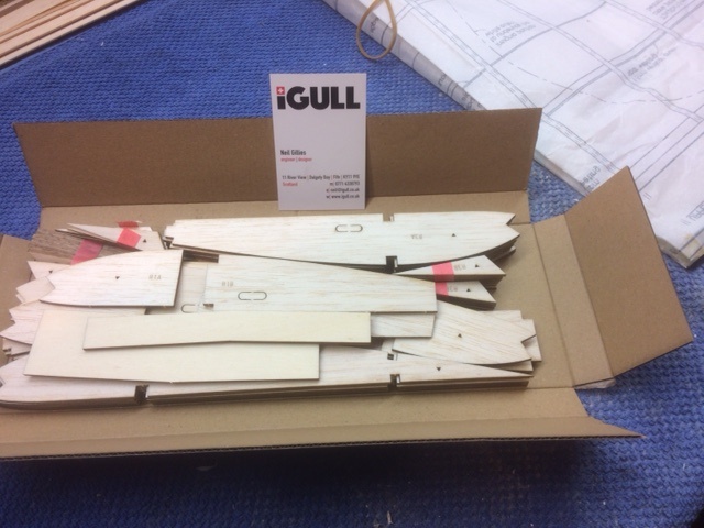

I decided to build a Puppeteer from a very old plan that has been in our club archives for a long time. The plans are not in the best of condition as can be seen from the first photo. I was also guided by the fact that I had a spare cowl for one. I also found a set of wing ribs on E bay so that gave me extra encouragement.
I started with the fuselage but modified the firewall as I may fit an OS72 so needed to move the firewall back and maybe extend the nose slightly.
My thinking is that I will use the larger engine instead of church roof, I know it will be overpowered but thats what the left hand stick is for

08 Nov 2020 17:13 - 08 Nov 2020 17:14 #2 by Klipkopwildlife
Replied by Klipkopwildlife on topic Puppeteer Build
You forgot to press insert sir, I've done it for you. It's going to be a nice build.

08 Nov 2020 19:17 - 08 Nov 2020 19:18 #6 by Quorneng
Replied by Quorneng on topic Puppeteer Build
Seefury
I know the Puppeteer is not a true scale Pup but it already has a lengthened nose. I suspect if you make it much longer it might begin to look odd.
What people don't always realise is that the Le Rhone was not particularly heavy but that the rest of the Pup airframe was very light!
Last edit: 08 Nov 2020 19:18 by Quorneng.

09 Nov 2020 13:45 #8 by Seefury
Replied by Seefury on topic Puppeteer Build
I agree that it will look odd if the fuselage is extended too much which is why I have set the firewall back 2cms and expect to only have to extend the nose by 1cm. I have built a scale pup and had to add a church roof and a battleship to get it to balance. This puppeteer is intended to just be a fly any time model not one the chose the best days for.
09 Nov 2020 16:34 - 09 Nov 2020 16:41 #9 by paul d
Replied by paul d on topic Puppeteer Build
Casual acquaintance of mine has one with a ( I think?) os 52 in, no nose weight as far as I remember?
The full size weighed under 800lbs empty and as Simon has said most off The weight is in the engine, suggest you build the rear fuselage and tail as per the real thing ( in balsa obviously).
Last edit: 09 Nov 2020 16:41 by paul d.
