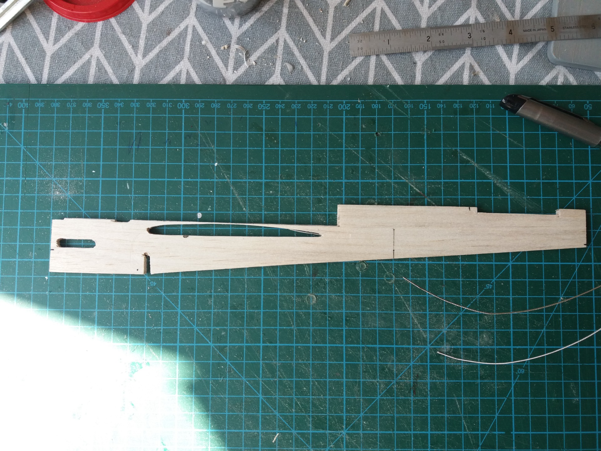

29 Sep 2021 14:17 #12 by paul d
Replied by paul d on topic Time Traveller
About time I posted on this one! Still no sign of a engine or current contact with the owner!?? but I have made progress ( it'll make a nice wall hanging ) first job was to make a frame from 3/8x1/2" beech, everything is built around this.
next up was the main fuse sides, took me a day to get these right, firstly I had to make a crude profile gauge to get the wing profile ( my last contact with the owner was when he sent me pre-built wing, he had it built by a guy that specializes in making them...it's a work of art..internal leadouts, hardwood edges all round and it's been impregnated with epoxy) from the gauge I could then make a template.
This allowed me to get the wing a tight fit in the sides and glue it altogether ( after about 6 dry runs and much measuring!)
next up sheeting the top..
