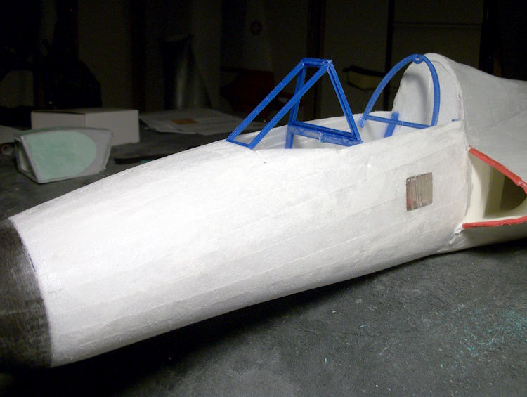

The new Skyray nose is more or less complete.. Just the cockpit to build up. The original canopy/battery hatch survived so will be incorporated.
Very empty inside.
Actually on purpose to allow a "structural" battery box to be installed which will add rigidity to the cockpit area.
Still a bit to go. .
Very empty inside.

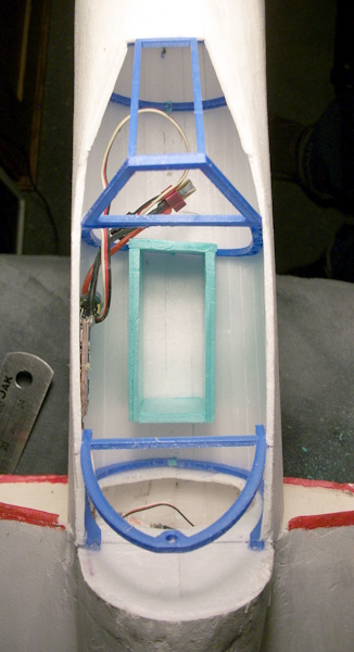

The cockpit fames go on and the 20A ESC with its heat sink inserted through the skin.
The battery box for the 1300mAh 4s is placed exactly where is was before matching a similar picture taken with the previous nose.
The box will have additional bracing once the position of the rx is established.
In RC terms it is a very simple installation. ESC with BEC, 2 servos, V tail mixer and the RX..
I can even do away with the V tail mixer if I can get the same level of response from the TX V tail option.
