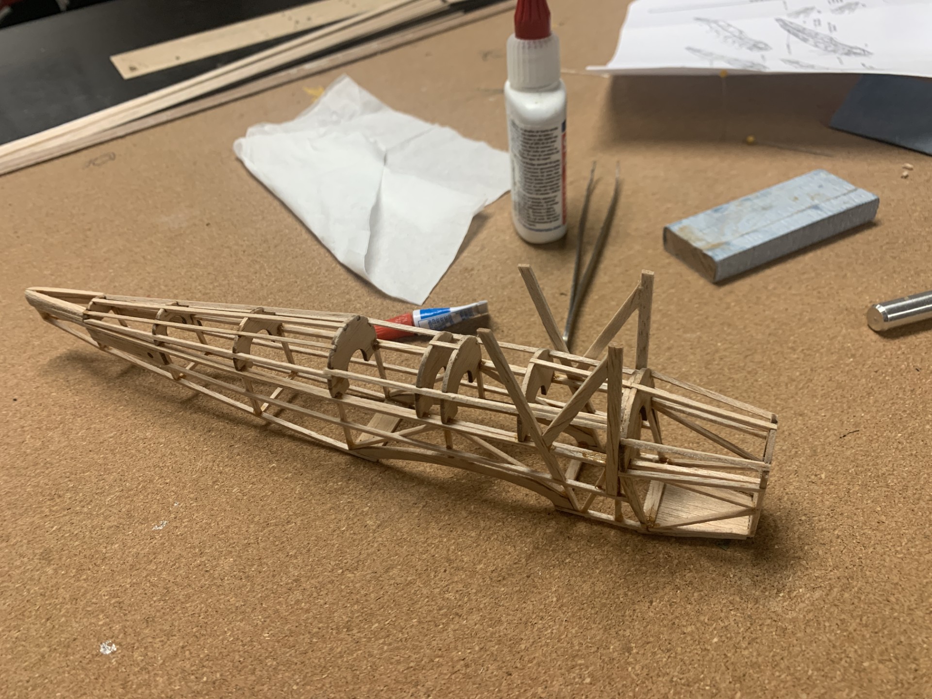

30 Nov 2024 00:55 #4 by old ugly
Replied by old ugly on topic tiger moth another Dumas
part of building is repairing all the suff you brake along the way. but the skin hides a lot.

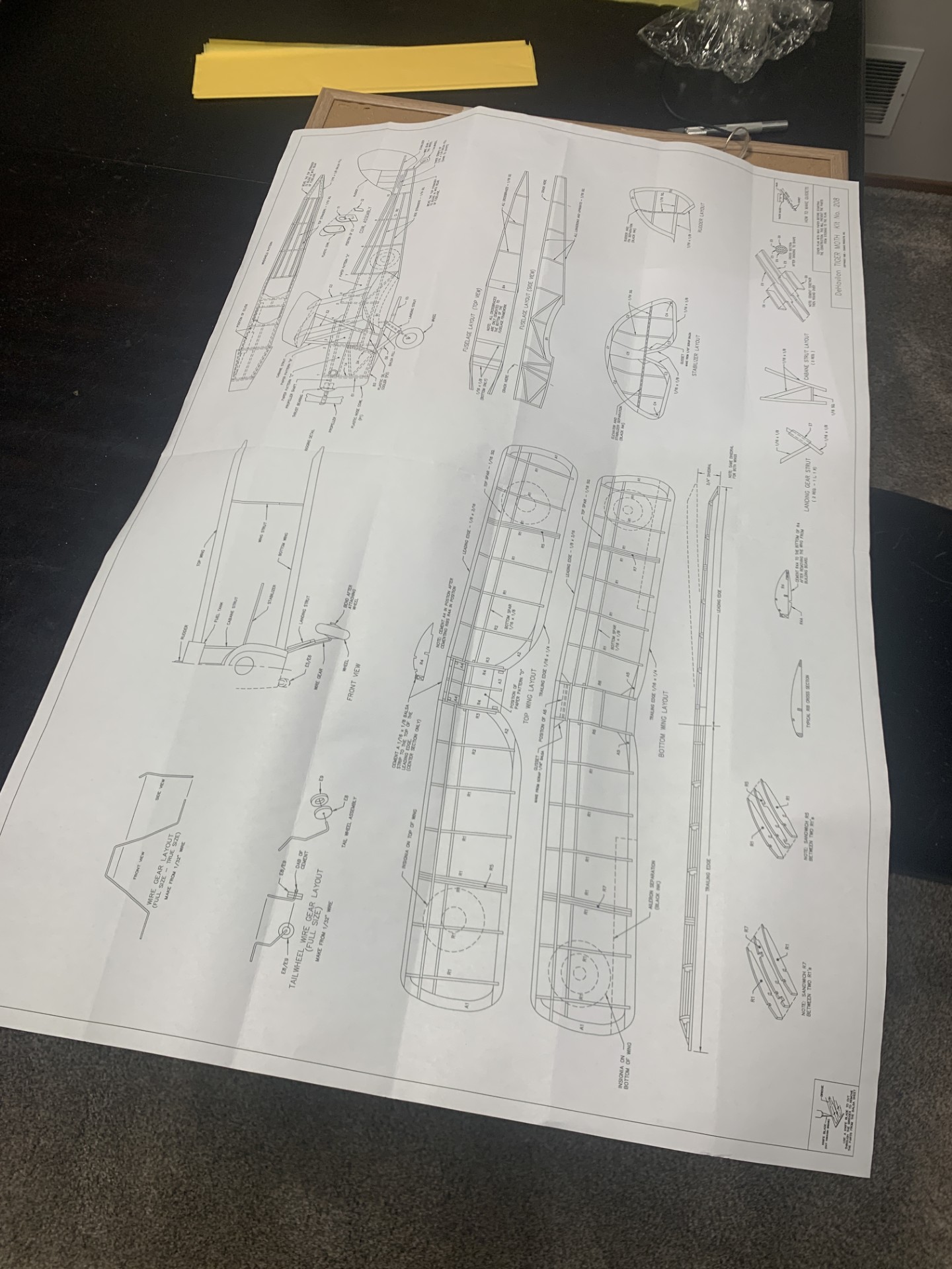

30 Nov 2024 15:10 #8 by old ugly
here is the plan layout. todays mission is to try to finish the fus.
OU

30 Nov 2024 17:07 #9 by old ugly
i was a bit confused by the plan but its back on track now.

01 Dec 2024 16:54 #11 by old ugly
our dog is 11, its going to be a very sad day when the time comes.
the upper longeron is double under the top formers. the side will be flat down to the side stringer then taper in to a narrower bottom. once i get there i may have to modify, we will see how it goes.

02 Dec 2024 00:50 #14 by old ugly
i found this fuselage a bit fiddly to put together, i don't know why as it is not that complicated. not my best work but it is a pass. now onto the wings.

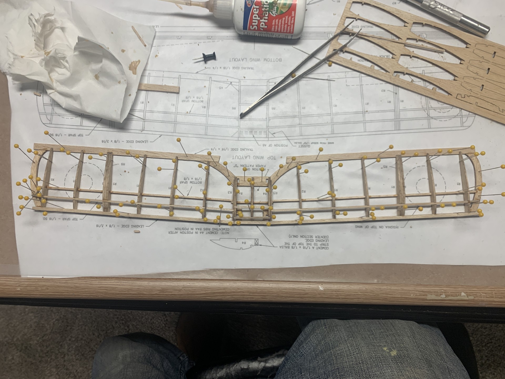

04 Dec 2024 22:41 #15 by old ugly
how many pins does it take to hold a tiger moth wing flat and square?
