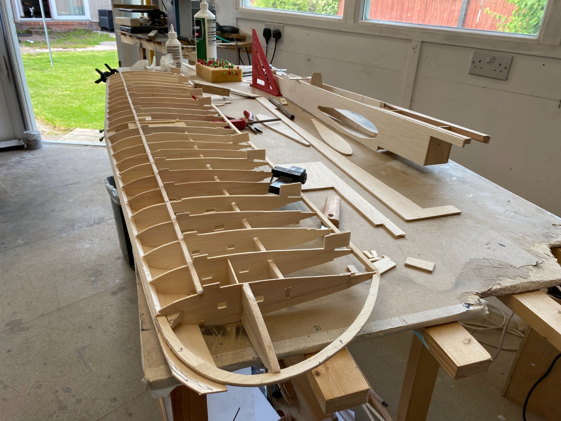

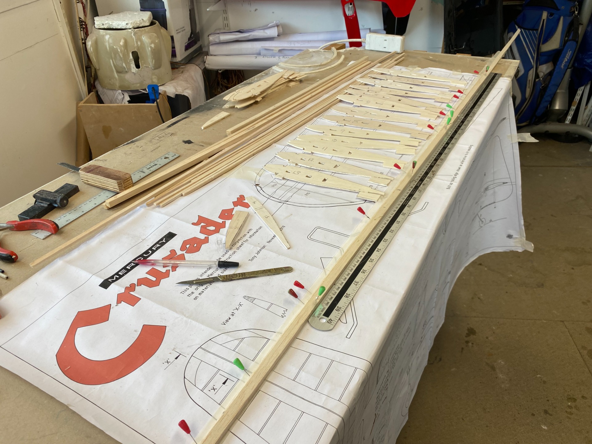

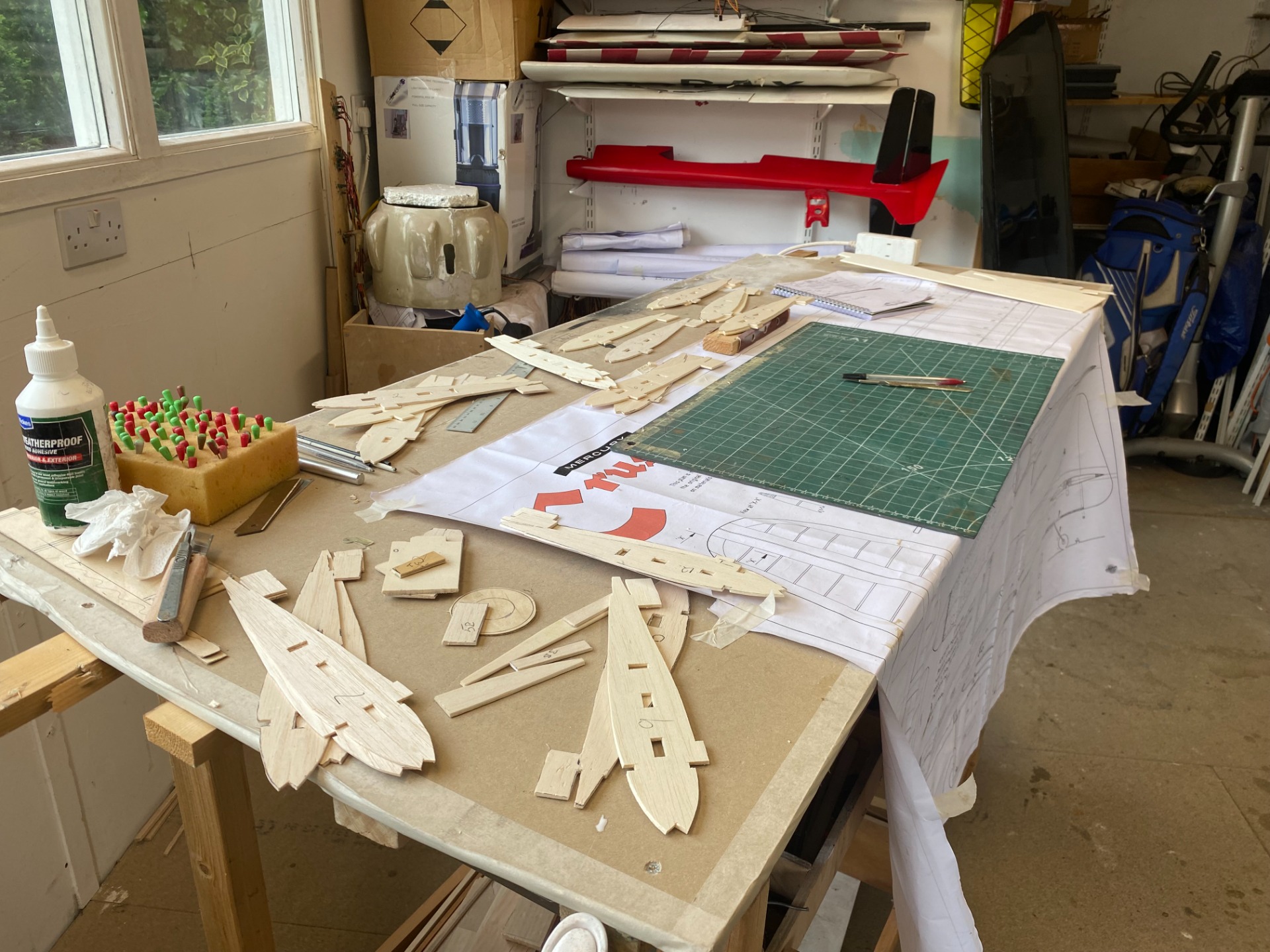

Started cutting out ribs and wing tips
Building the wing
Couple of wrong photos in there from the glider build
i was building one of these doing the covering with nylon when i propose to Ann, in my mother in laws kitchen, so yer lots of good memories connected to this model
Just started this one last week but i was blocked out of the forum so only just posting
Building the wing

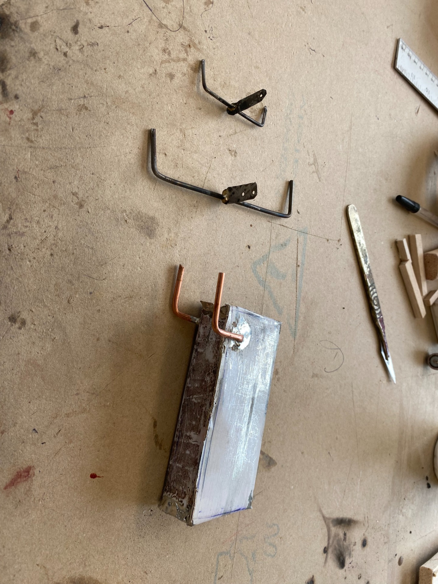

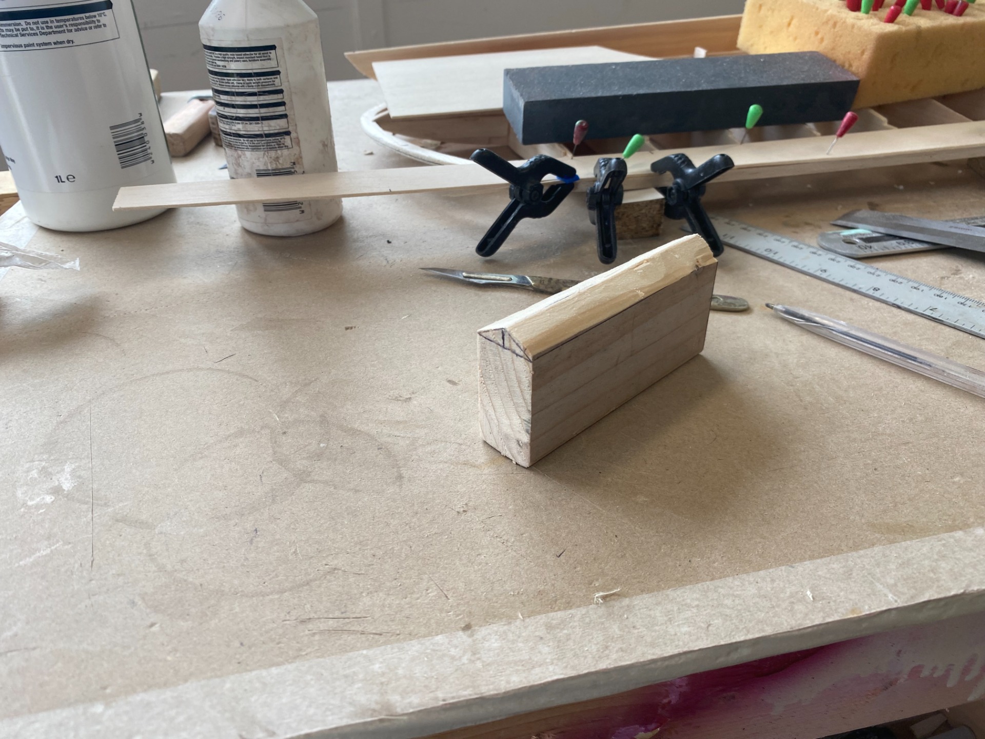

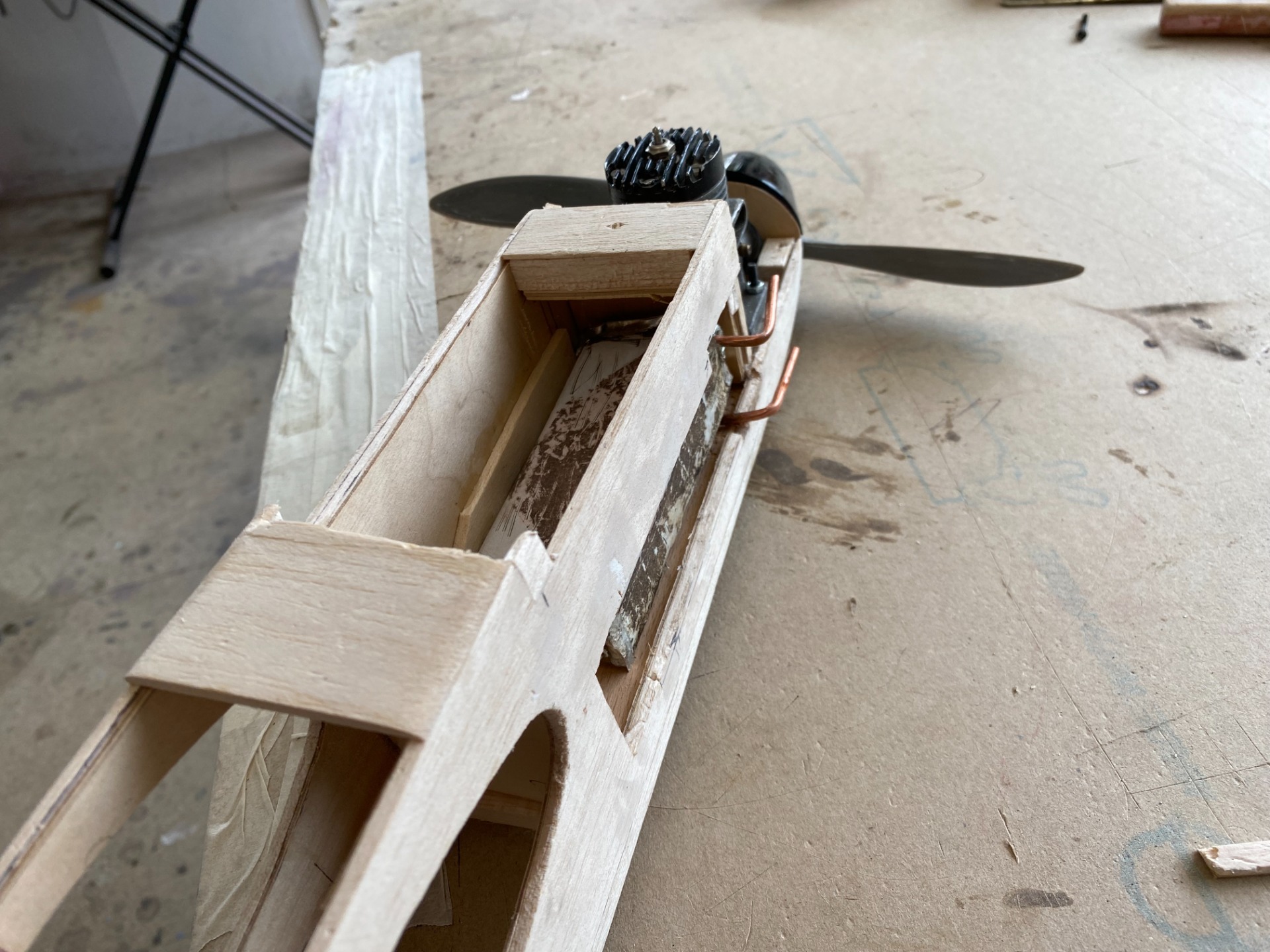

I made a wood block the shape of the needed fuel tank, just got to find an old can to cut and wrap around the block then solder it all up, just big enough to give 7 minutes flight with the engine four stroking in level flight and as soon as the nose pitches up it will cut into two stroke to give more power, the it drops back to four stroke again as soon as it levels off
Also making the cowl

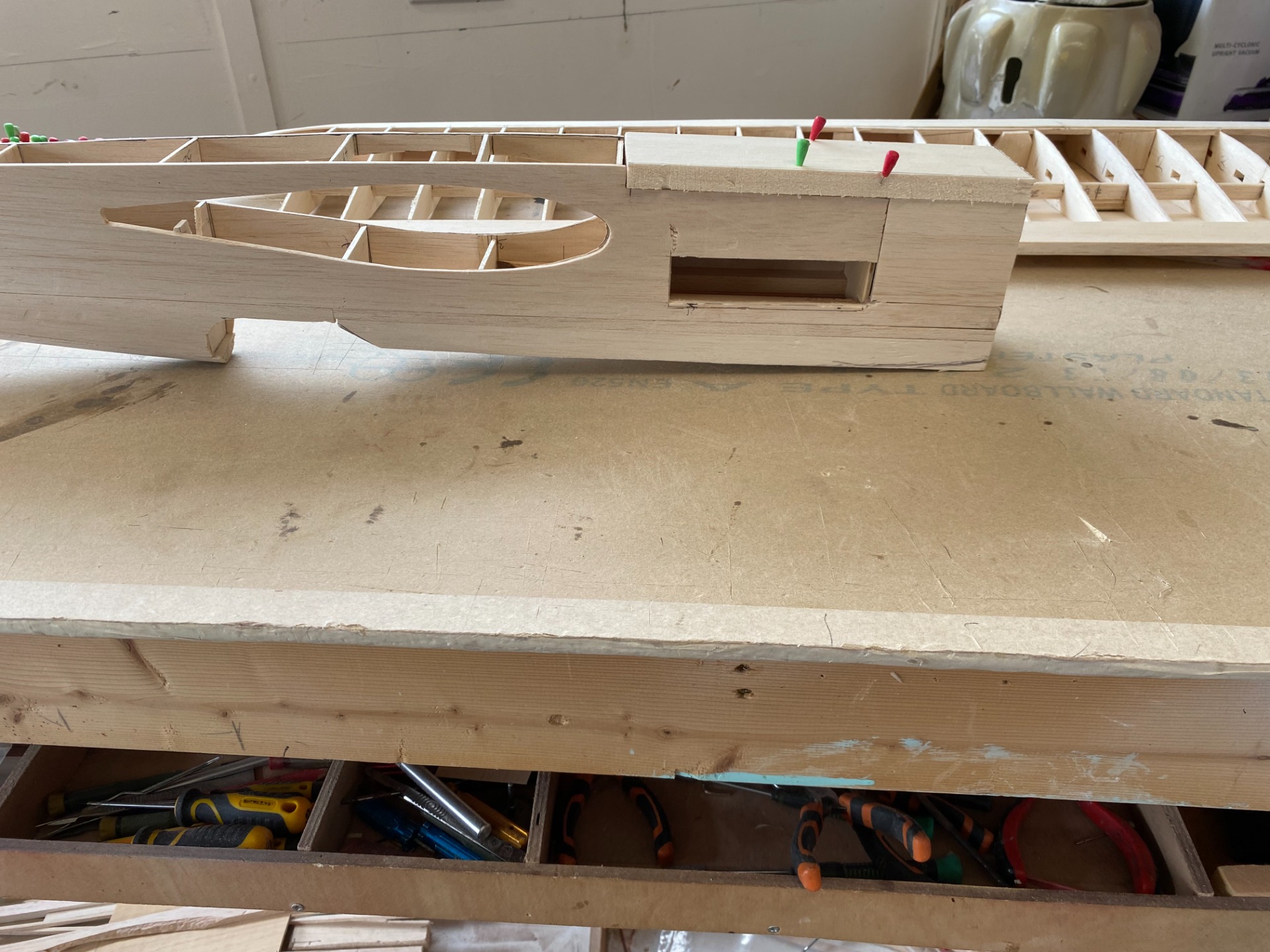

Cut the hole in the side of the fuselage for the tank to slide in

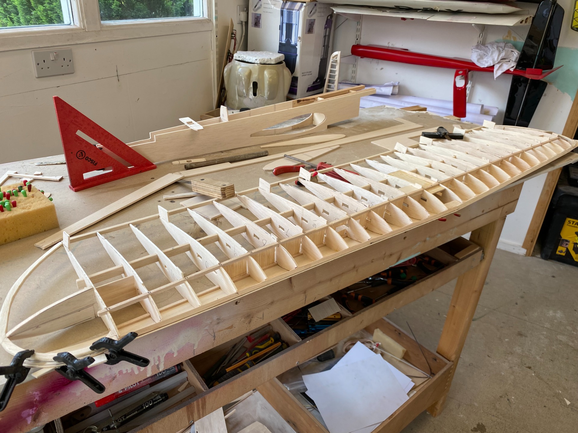

Top block tacked on ready for shaping
