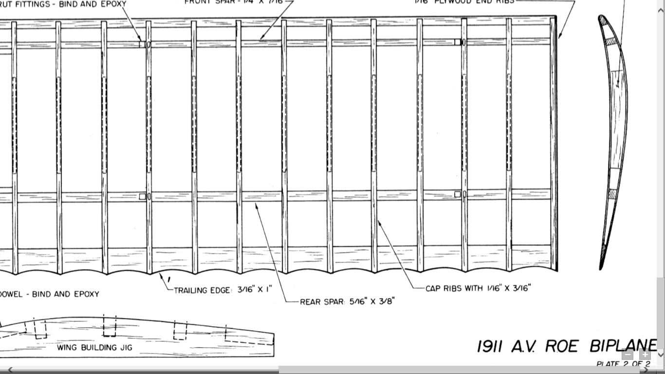

Having a look at the plans and there is a jig to make the wings but for the life of me I cant work it out. I have included a copy of the plan. All ideas most welcome.

05 Jun 2021 16:57 #12 by Eric
Replied by Eric on topic Avro D 1911 biplane
That worked.
I see a severely undercambered right? wing panel, but no jig that you mentioned.
That section will be very difficult to build, and very prone to warping, as it is so thin.
I think the easiest way would be to pin the bottom spar right on the edge of your building board, and let most of the trailing side hang in free space, just the front 'box' on the board to keep it straight - but of course the thin ribs would be very vulnerable to accidental damage from a careless waved hand or passing cat (if you have one!)

05 Jun 2021 17:26 #13 by ether823
Replied by ether823 on topic Avro D 1911 biplane
the jig is at the bottom of the drawing

05 Jun 2021 17:34 #14 by ether823
there are no ribs to speak of, a typical section is bottom capping, the leading edge then a spar and then a infill piece of 3/32 balsa in the middle then another spar then some top capping . I was wondering if you laid all this up in the jig as a sandwich maybe.
05 Jun 2021 19:25 - 05 Jun 2021 19:32 #15 by paul d
Replied by paul d on topic Avro D 1911 biplane
The idea is you make a board to the shape given and build the wing on that, you have three choices from my point of view, build the jig ( you would need to make a profile gauge from the drawing first) redesign the ribs so there solid or cut two of the jig patterns shown and use them to cut a foam jig.
should make a wonderfully light wing.
Edit: I would use spruce for the cap strips, you'll have a devil of job covering it if you use balsa.
lovely project, please keep us all informed of progress, in fact why not start a build thread in the appropriate place on the forum?
