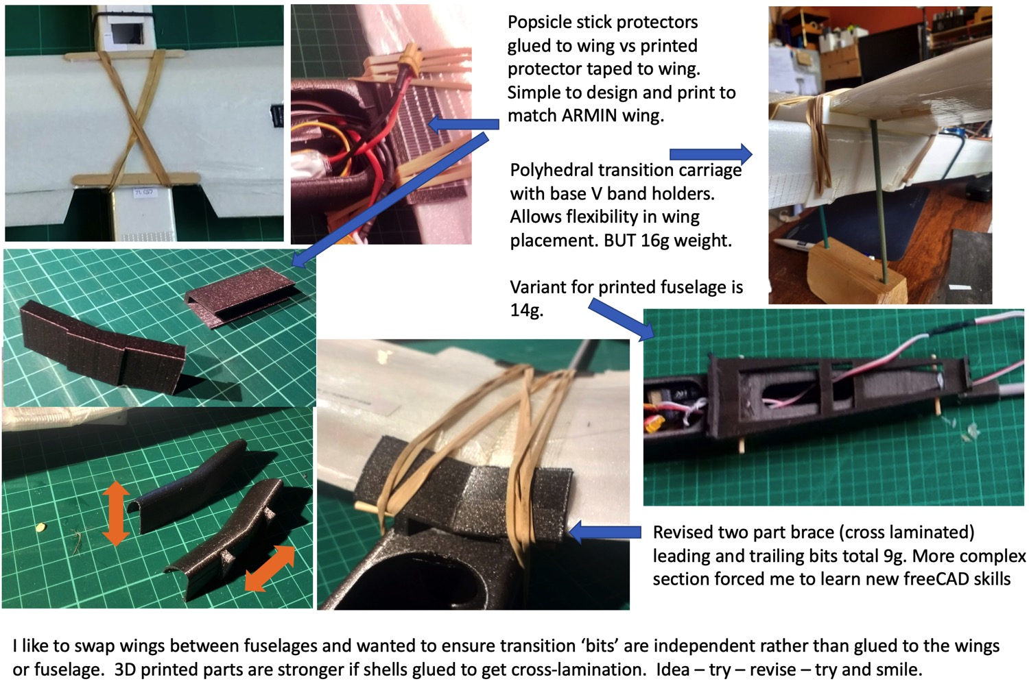

I just joined aero modellers and looked for folk chatting about 3D printing and scratch builds. I am a bit unsure about where to jump in so if there is a better part of the forum please let me know.
I have a suite of wings that I shift from fuselage to fuselage as I try out new construction techniques. Popsicle sticks are ok to protect wings from bands but need to be glued on. And gluing and sanding to hold a polyhedral to a foam fuselage also causes damage when I want to swap over to a straight wing. I have a Prusa Mini and surely one could design small carriages and transitions. I made a series of these (see the image) and gradually making them smaller and stronger. An interesting challenge was an ARMIN polyhedral to get freeCAD to describe the same leading and trailing profile. To make it stronger I printed it in two parts - one printed vertically and one horizontally and then glued together so the cross-lamination might get around the print-is-stronger-in-one-axis problem.
Hopefully the images show the context of the ideas I have been working with. I am happy to share the files if anyone one wants to take the ideas further. It would be interesting to see what 'wee bits' others have created. -Jon

I do like the pictures Jon. That's some serious 3D printing you're doing.

Great stuff Jon, is that material fuel proof? There's a good market for replacement fuel tanks for vintage diesels..need a couple myself.

Interesting thought about 'fuel proof'... certainly it takes a lot of bother to make a 3D print liquid-tight. I am printing with PLA. I suspect it will not dissolve in diesel. I did find a liquid air trap for Klippy to print and that would need to be air and liquid tight. The trick is how to design openings to get the diesel in and out without those leaking. -Jon
