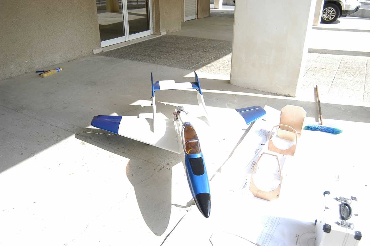

Built this last week, i bought it in the model shop in Nicacia 395 euros which is very cheep for a jet, when compaired to my boomerang Sprint that was over £600 and nowhere nere as good a quality
Fibre glass fuse and very well made,
Fitted the Jetcat 100 in it, fired it up and after about a minute the fuel pump packed up , now waiting on Jetcat to replace as its under warranty
Where to fly it is the problem

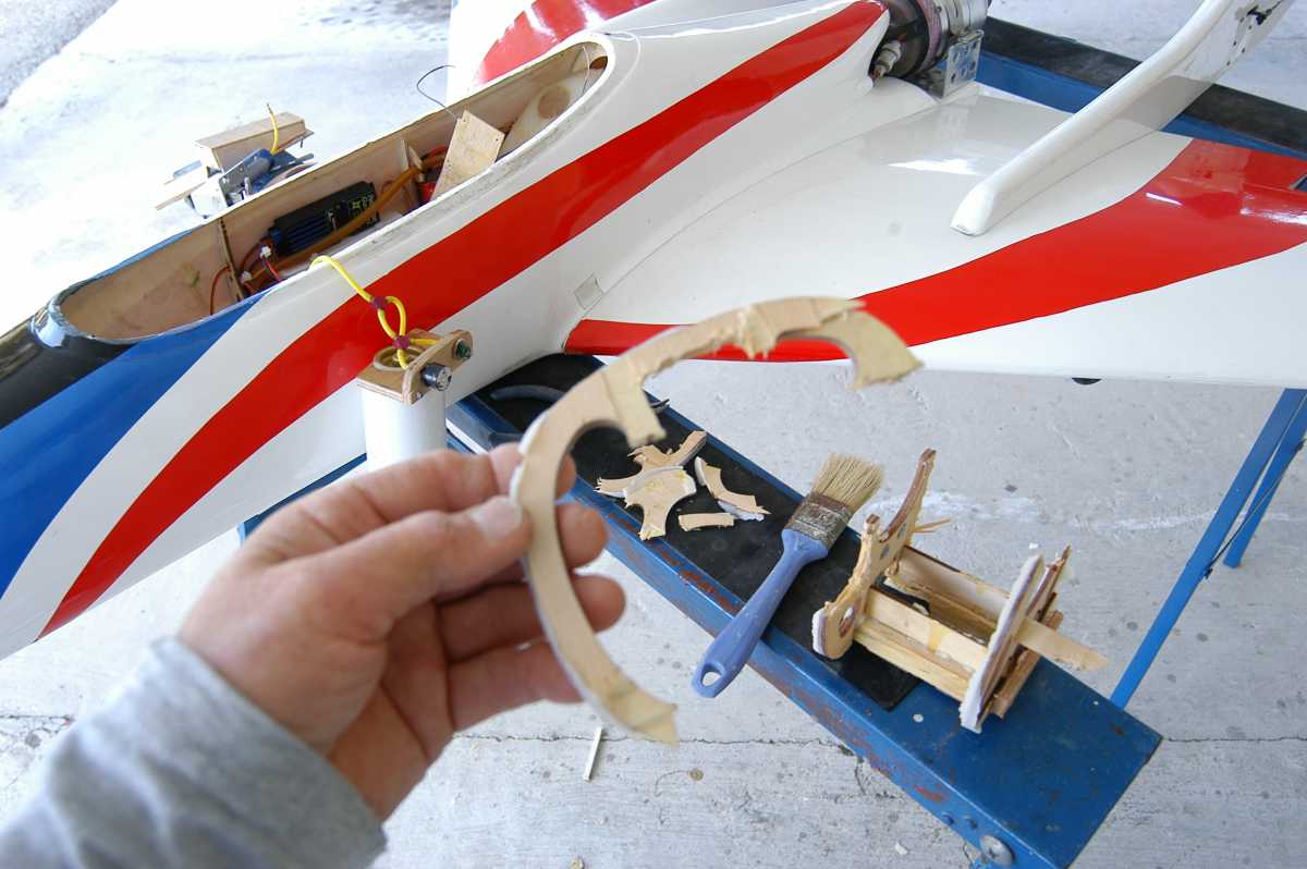

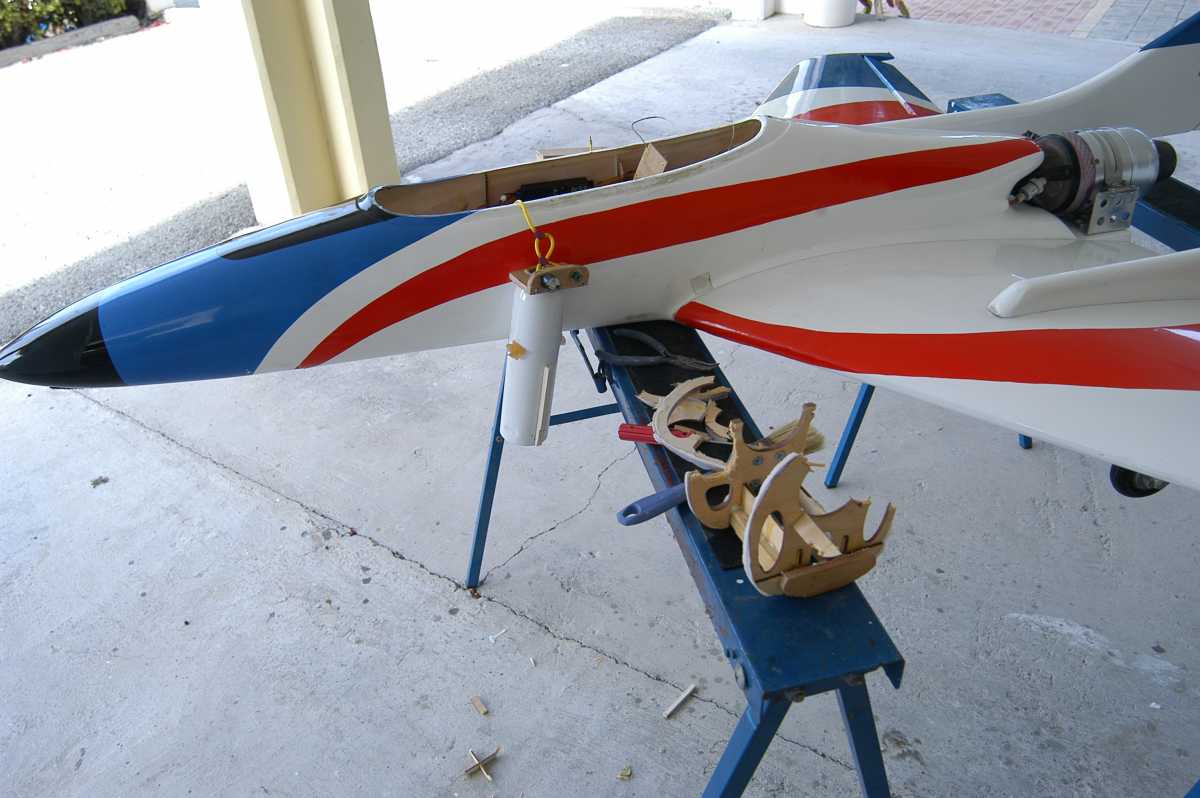

Had a hard landing at the week end with the Navy Cat, lost power for some reason, still unknown

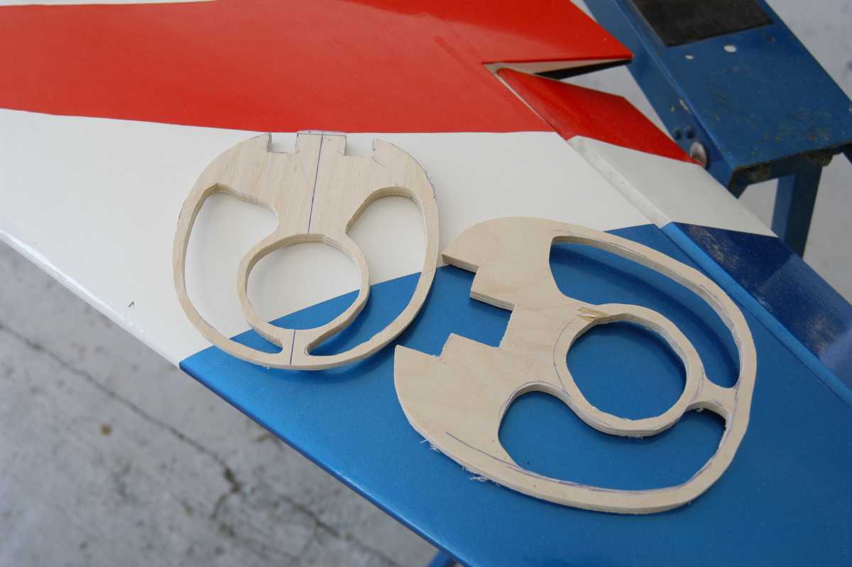

and had to make an emergency landing it came in hard and bounced, knocked the nose gear out, the formers came away from the fuselage skin, i was lucky really that the china lady did not use more flour with the water when they stuck the formers in or it would have torn the fibre glass skin
Cut some new formers from 6mm ply and hysoled them in, also enforced the glass around the nose area
It has been a bit of a bitch to land at the best of times, as soon a it touches the ground on the mains it bounces back up in the air, one of the jet guys said it was my thumbs that was the problem,
so he had a flight and it did the same for him
