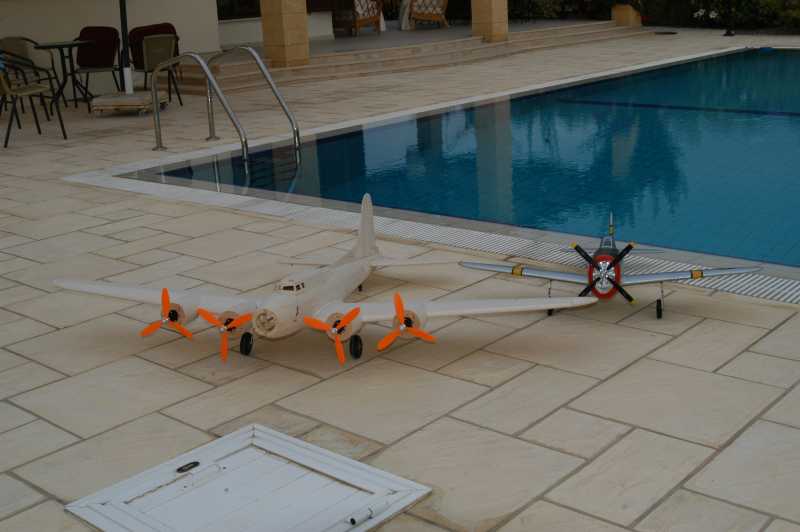

I have the same B17 in my shed Dean never did finnish it, i used what TN stated on the plan brushed motors with gear boxes, i glassed mine and it came out heavy, it was my first build after 40 years away from the hobby so any help i can give you just shout, i took some pics of the build

One day i hope it will lumber off the ground, the problem i have with it apart from the wieght is he fact that when people cleaned my villa out in the north a lot of stuff went missing including the esc's for this, the motors only have 2 wires to it not 3
I can post the pics on here but i dont want to take anything away from your build thread maybe i could email them up to you.
