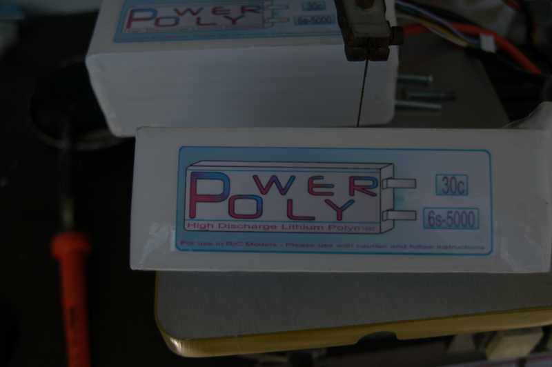

I have just bought some new lipo;s
Dont know what they are like, should have a good heart in them though :P :P :P
