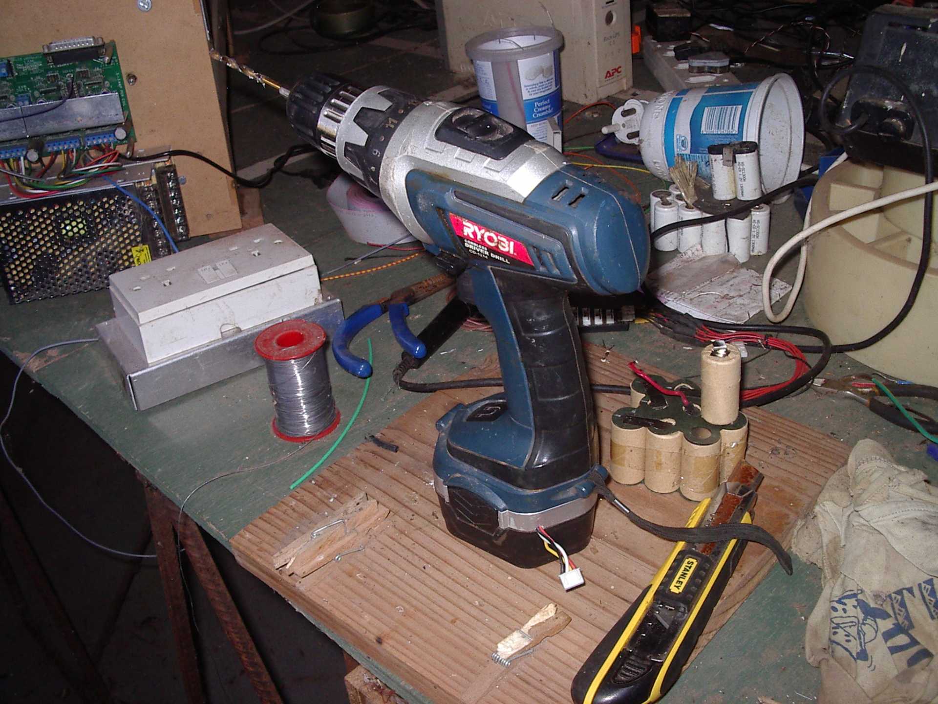

This is the type of battery, Ryobi (Australian) is common here as budget tooling.
Remove 4 screws.

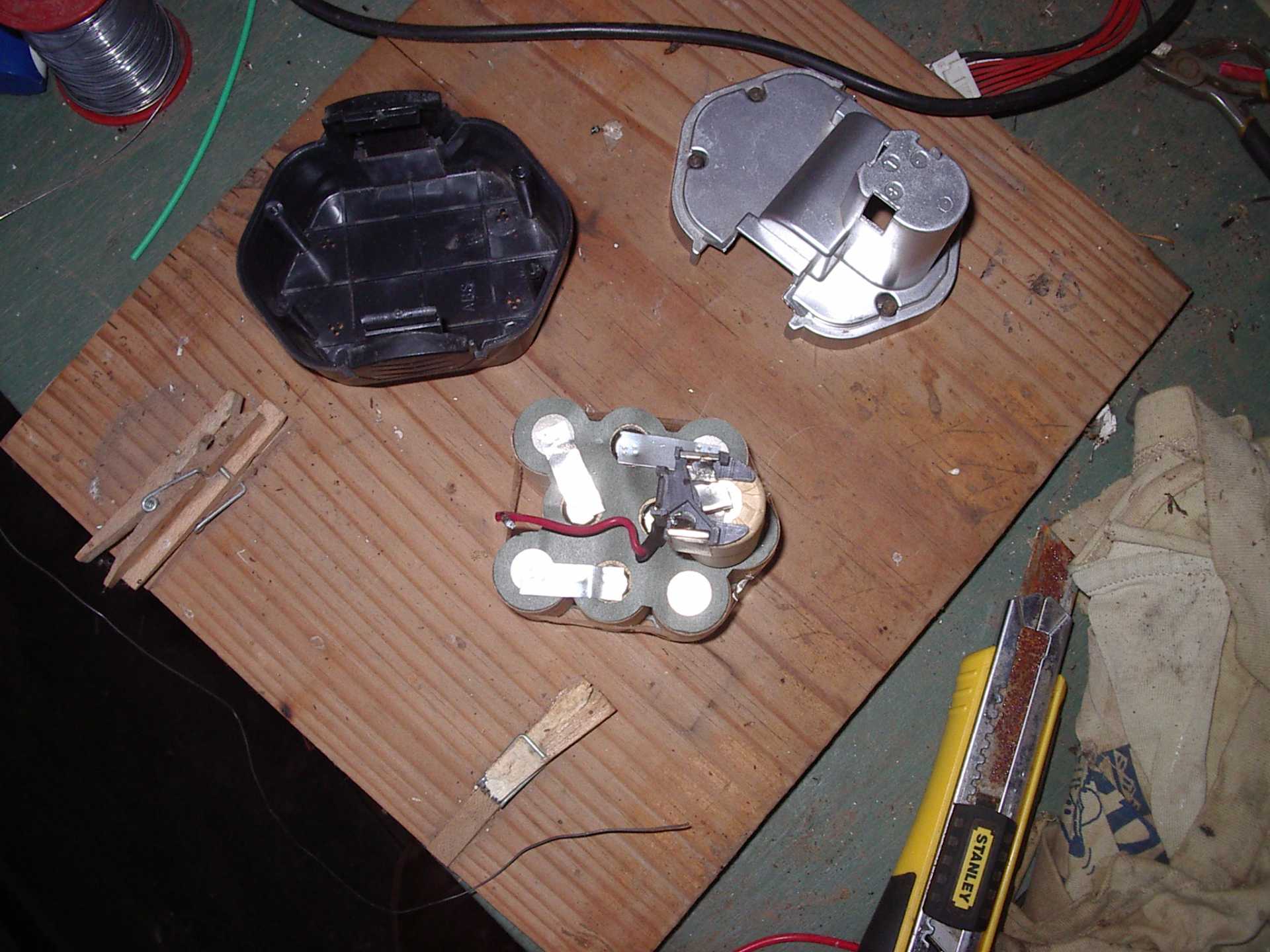

and this is what you find.
Using a disc cutter in a pencil grinder cut the negative strap.

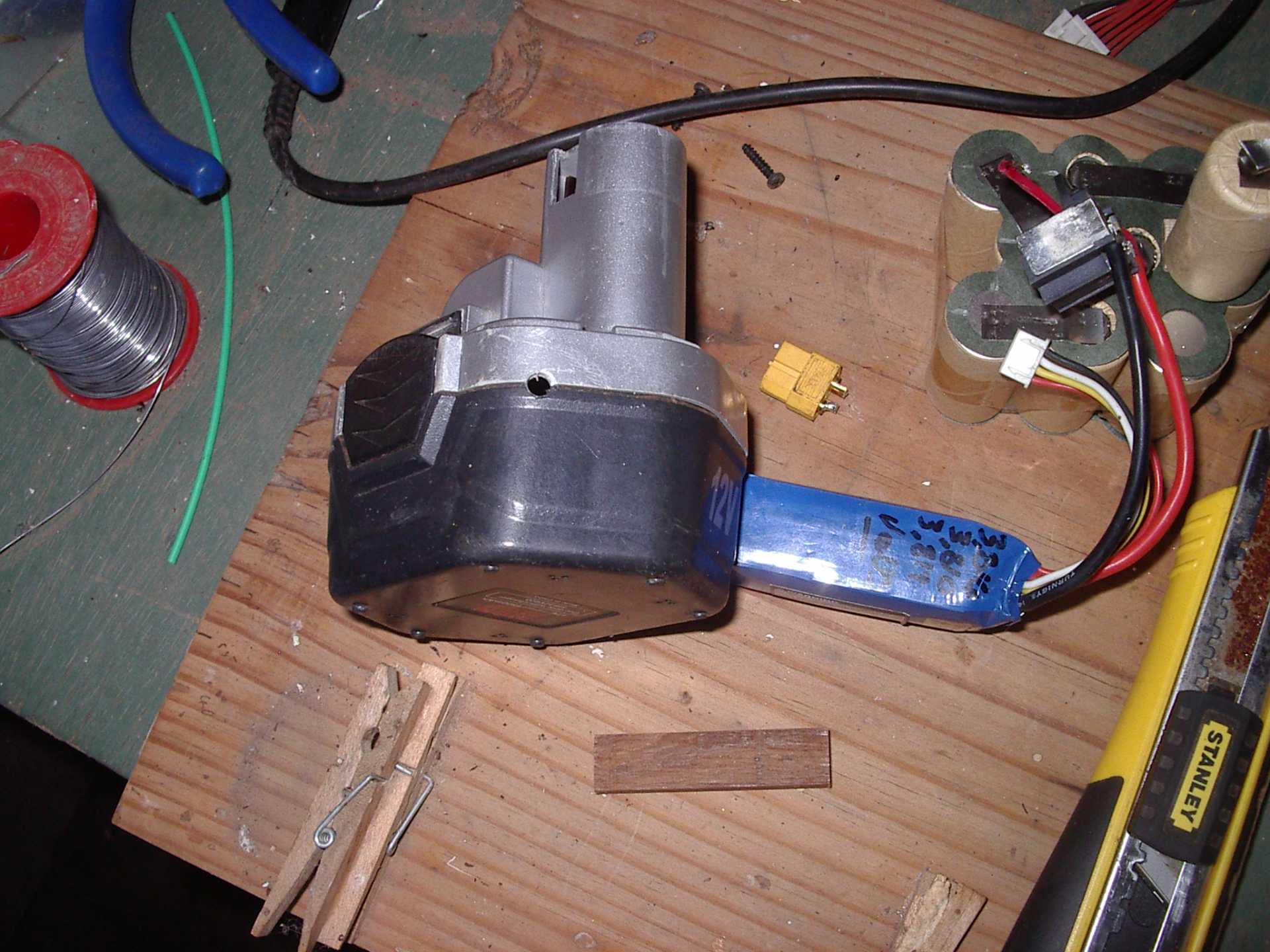

Now unsolder the positive and tin the negative contact because we need this widget that holds the sliding contacts.
One at a time solder the new battery wires onto the widget, I've left it sitting on top of the old battery pack so it's easier to work with.
Once done we can discard the old battery.

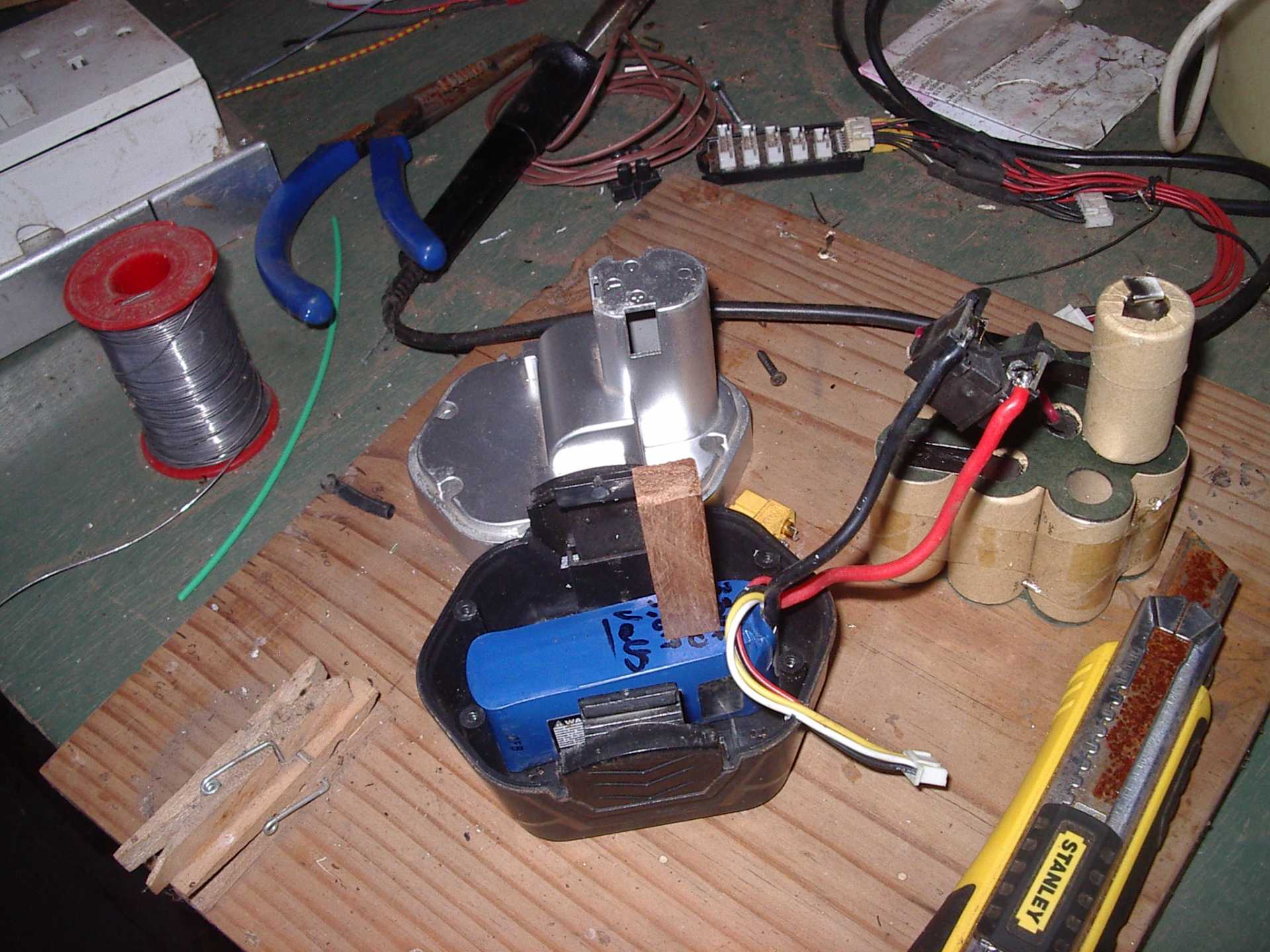

The sliding connector block fits in the 'tower' of the case.
And we need a block of non conductive (wood) material to stop the contact block from sliding down. Note the 4mm hole for the balance plug wires.
I put a dab of glue to stop the block from moving during assembly.
Job done, I still have one battery with the original batteries but I'm going to modify one of the charger sockets to fit my Lipo charger.
