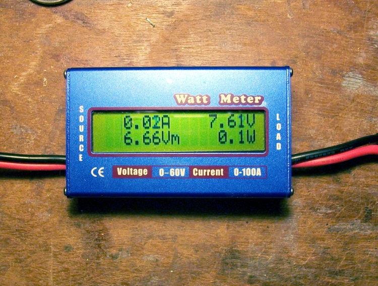

Bugger all on the first one :( Then on the second one i plugged a 4s lipo in, i know its ok because i use it on my kerosene pump, i get this
i press enter, i get this
Press again
And again
These were new and have never done anything
And just to top things off the Power Box sensor switch in the Revolver packed up today :( :angry: :S :evil: :sick: [badass]
Last edit: 09 Mar 2018 20:20 by THE BLACKBIRD.

The Wattmeter I have is rather different to BB's - but as he has no load on the output, if I do that with MY meter, it shows 0.00 per cell. That's not VOLTS, it is AMPS, and as none are being drawn, 0.00 is correct. :P
Now - if BB plugs in a speed controller to the LOAD side, and a prop-less motor ( for safety), and a servo tester or receiver to drive the speedo, he'll see a difference!
A propless motor won't draw very much anyway, but the numbers will rise from zero.

I see it will not measure the lipo, only works if the is a flow through it, i will have to buy another lipo tester
Thank you
09 Mar 2018 22:57 - 09 Mar 2018 22:59 #30 by Quorneng
Replied by Quorneng on topic Digital multi meter
BB
It seems you have the wrong style of watt meter.
When I couple a lipo (a 2s in this case) up to mine just by itself it does indeed act as a volt meter.
It also shows the current it draws doing it (0.01 A). Left running it even records the power consumption, 0.009 Watt hours after 5 minutes!
