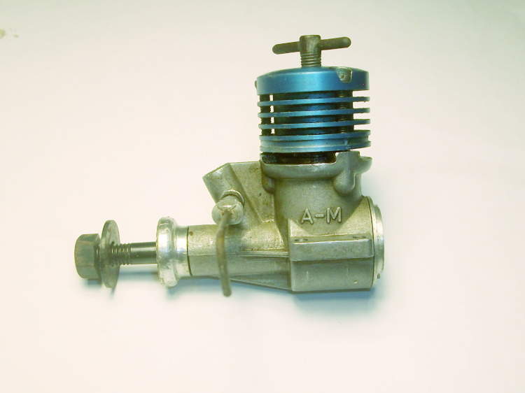

Stripped but left crank in situe, cleaned, checked, reassembled and lubed.
Mounted in test mounting and ran up.
Little difficult to start untill settings established, then a good easy starter.
The bugger bit me but no blood.
Rich runs then leaner and a final brief period onso g lasting 5 seconds or so.
Noisey but good potential.
Conical piston, I reckon it's the later "2" version measuring piston size.
Lubed and stored awaiting a period cl model to be made.
Os glow "pet" next.
D1000 fuel.

25 Feb 2022 14:47 #5
by Rich griff
Replied by Rich griff on topic AM 15 diesel
Yes, blue head/cylinder jacket on 15, green on a 10.

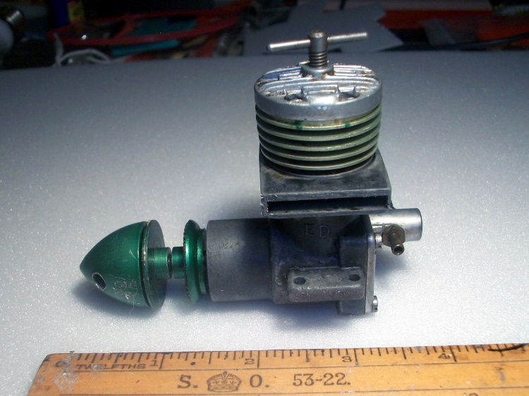

26 Feb 2022 07:58 #9
by paul d
Replied by paul d on topic AM 15 diesel
Better known as "the racer", Simon, I believe yours is a mkiv, if you post the serial number I can tell you how old it is.
Some of those later green head racers were available from the factory as Reed valve induction rather than disc valve, ED never advertised the fact for some strange reason.
- paul d
- Posts: 2074
- Thank you received: 2292
26 Feb 2022 11:14 #10
by paul d
Edit to the above...Its actually a mkiii Reed valve motor..
