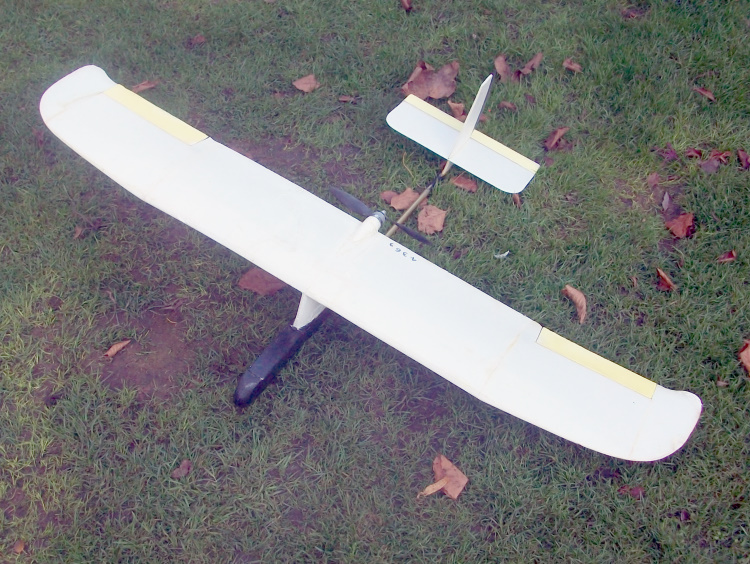

Just as a tease this plane was built for endurance rather than distance. It uses a 3800 mAh 2s LiPo and with that can fly for well over 3 hours non stop covering close to 50k through the air.
It weighs 436g with the battery. It uses a smaller 24g motor than the 40g CF2822.
