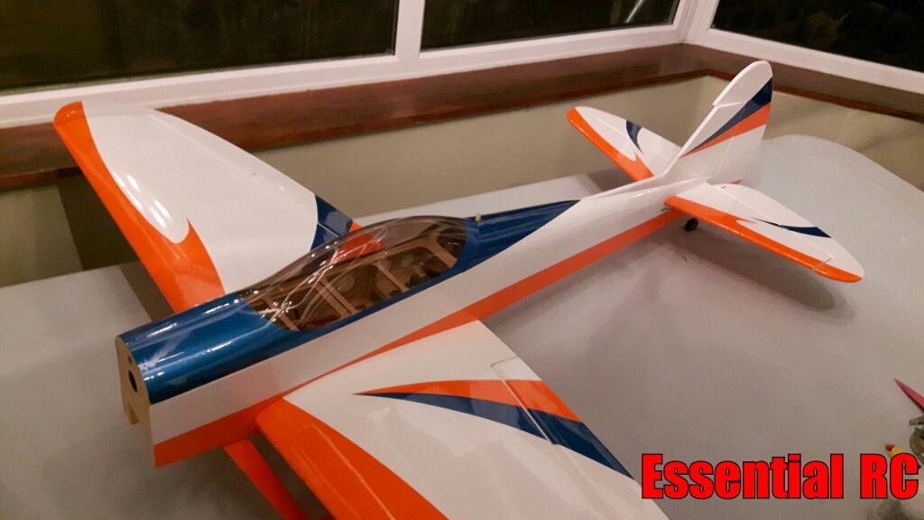

HobbyKing Estrella was created by DominicM
1.5m sport/aerobatic model from HobbyKing. Suits IC (.50~.56 2-Stroke, .60~.80 4-stroke) or electric. Going electric with this one.
Turnigy G46 Brushless Outrunner 670 KV G46-670
Aerostar 60amp electronic speed controller with 5A BEC (2-6S)
Turnigy 4000mAh 4S 30C Lipo Pack
Propeller 13x8
Plenty of holes in the balsa and ply for lightening the overall airframe yet it's all very rigid and looks like adequate glue used. Scheme has been applied very well.

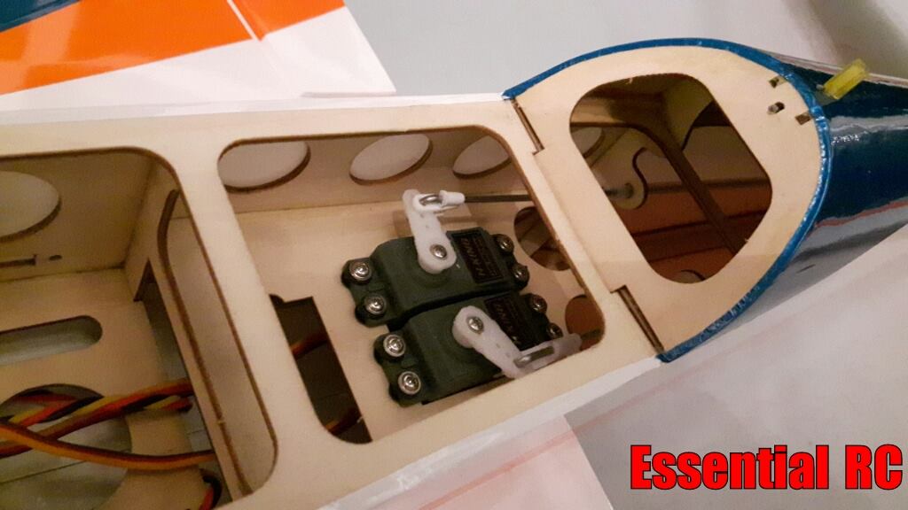

Replied by DominicM on topic HobbyKing Estrella
Elevator and rudder servos in place with control rods into guide sleeves in fuselage.

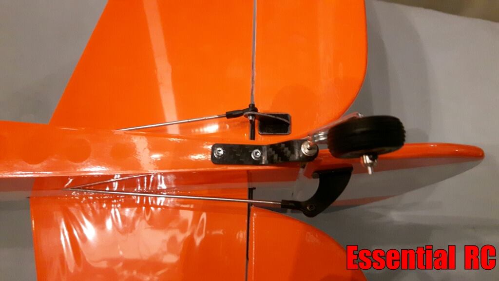

Push rods hooked up to elevator and rudder carbon horns with ball links. Underside of elevator just needs a touch up from a covering iron.

16 Apr 2016 10:37 #8 by Klipkopwildlife
Replied by Klipkopwildlife on topic HobbyKing Estrella
Looks nice, it says to me 'Spitfire'
16 Apr 2016 13:20 #9 by one tenor
Replied by one tenor on topic HobbyKing Estrella
Reminds me of a C/L job I built in the 60 's but not sure what it was. Phantom springs to mind so maybe that was it LOL but it's very nice all the same .I'd like one .
