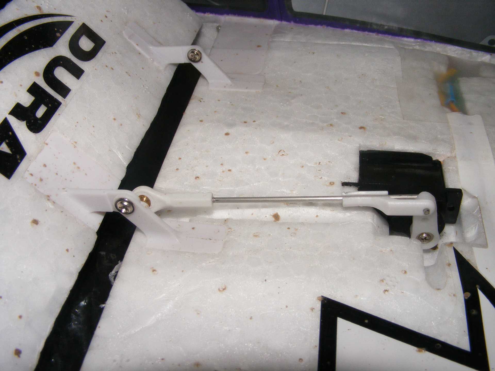

The mechanical linkage works the other way round surly, the shorter the flap horn to the servo horn will give more throw
Just takes more pulling,

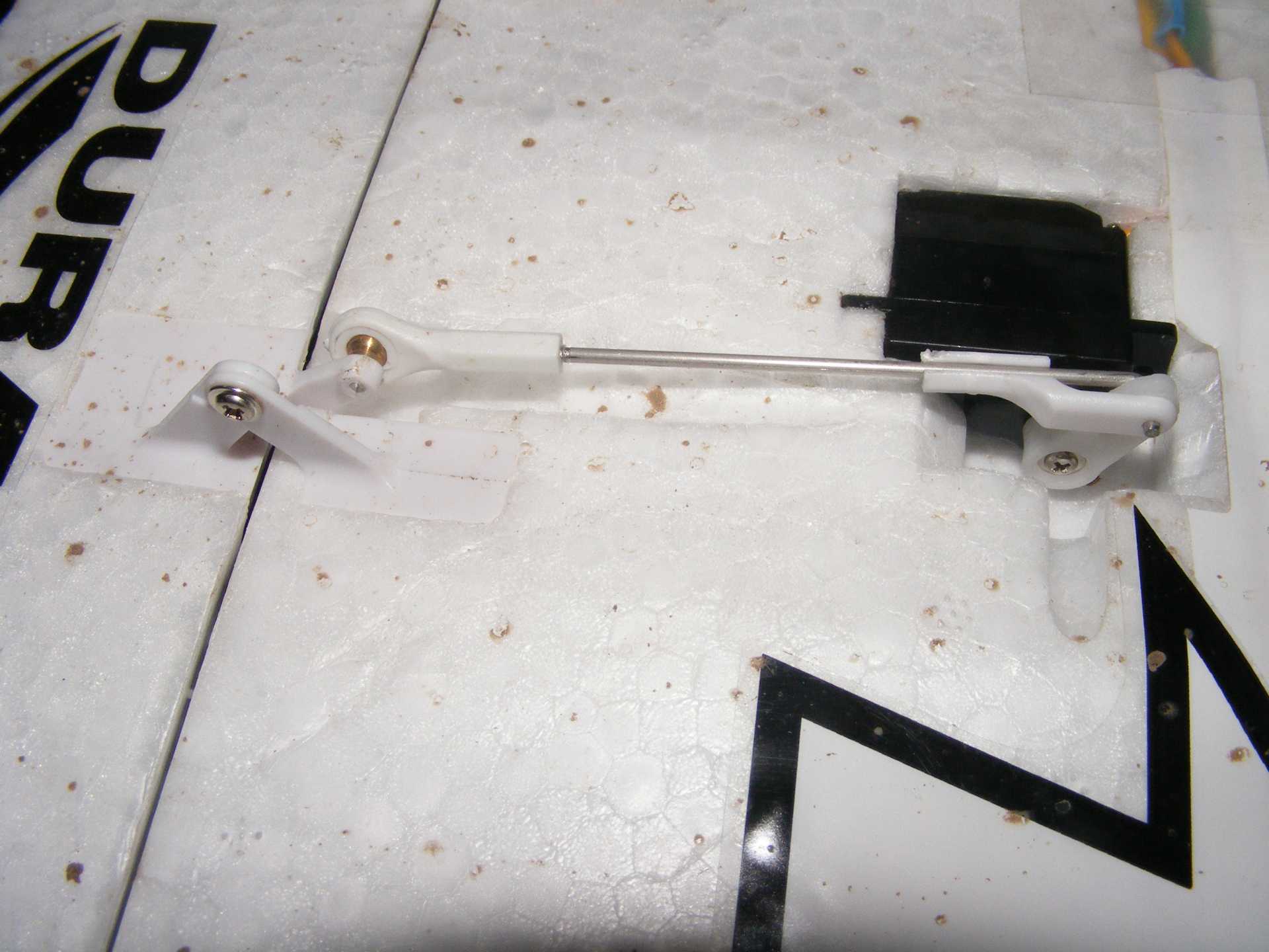

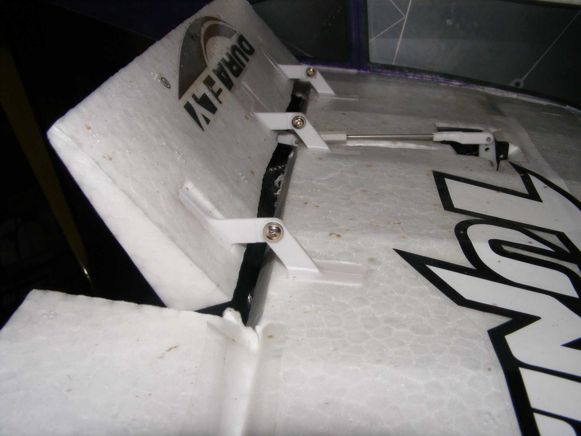

Continuing from an earlier comment re the flaps - here's a series of pic's showing the horn geometry on the standard Tundra. (Sorry about the mud splats!)
