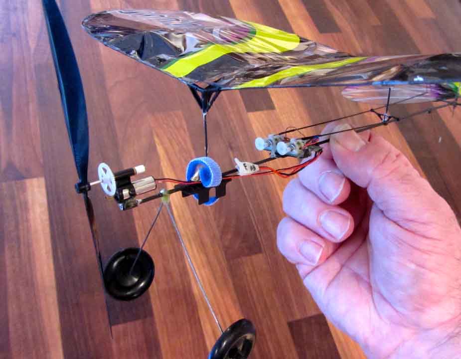

This what the (much repaired) Vapor looks like now:

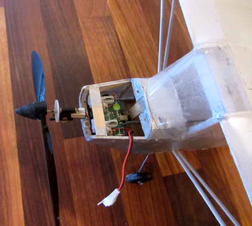

and this is what the RC Aeronca looks like:

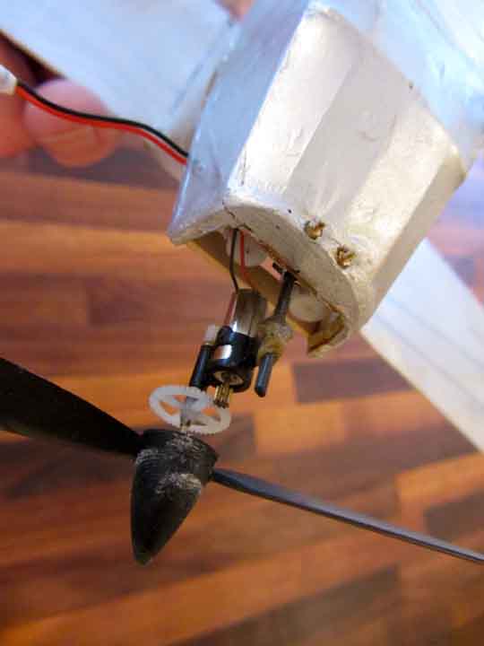

I cut the Vapor fuselage just in front of and just behind the RC Pack and cut the motor pack off the front. The latter was bound and epoxied to the front of the former and both introduced on their now short carbon stick to the front end of the Aeronca. I'd fixed a plywood strip at the back of the engine compartment with a hole in it to accept the rear and of the flight pack and made up a small plate to go over the front end from the lid of a Baked Bean can. Two 12BA nuts and bolts hold the assembly in position:

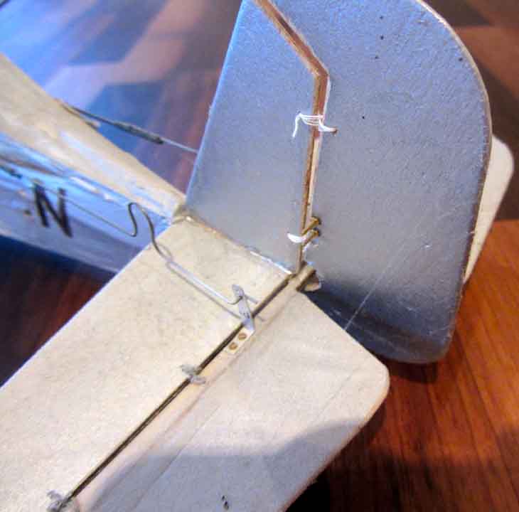

Thin wire ( 0.020" I think) ends were fitted to carbon control rods (1mm?) with heat shrink. The tailplane spar was split down the middle and a rudder cut from the fin. Both were hinged with thread a la control line models of the 50s and 60s. The control horns were cut from the same Baked Bean tin and again fixed with small nuts and bolts. The formers at the rear of the fuselage were knocked out and holes cut in the tissue to let the controls rods through - the back end of the model was still adequately stif as the longerons, uprights and cross pieces were still in place.
The back end:

The motors & gearing in those look like the tail motors off some commercial heli's .... am I correct?
Mike bought a Walkera heli at the 2012 Nat's & had nothing but trouble with tail motors burning out. After some research it turned out that they had a very short life expectancy, is this the case with these motors?

How does she fly - not very well at first. The Vapor weighs about 16 gm, the Aeronca about 60. The latter therefore flies a lot faster than the former. The pitch of the prop was much too fine for the Aeronca, so I twisted more pitch into it and after about four iterations, off she went. It's a very low powered machine taking about three or four circuits to gain height, but it does fly in a 'Scale' manner and she does look good in the air - I'll get some video at the next meeting I go to.
She also managed second place in her first comp, so all in all, I consider the experiment a success.

Don't know the answer to that one Pol, although I do believe the motors originated as pager/mobile phone vibrators. As far as longevity is concerned, I have at least 8 models with similar motors and all have been flying on and off for up to five years without a failure.
