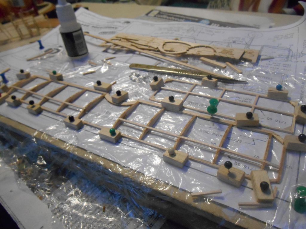

Its a while since I started a thread here.. However, thanks to Andy Sephton and Danny Fenton who jointly have reignited my interest in indoor scale models. The last indoor scale comp I flew in was at Rochdale in 1974(ish), so its been a while.
I bought this Peck kit a couple of years ago as a holiday build but it has been collecting dust. However, I was away for a week - glamping near Aberystwyth so with my portable workshop I started to do a build. I may even get this one finished.
Wood quality wasn't bad, interestingly, one piece of strip was grade colour coded - unfortunately, the rest weren't. If I was scratch building, I would have replaced the 1/16 sheet ribs with 1/32 but that wasn't an option in the circumstances.

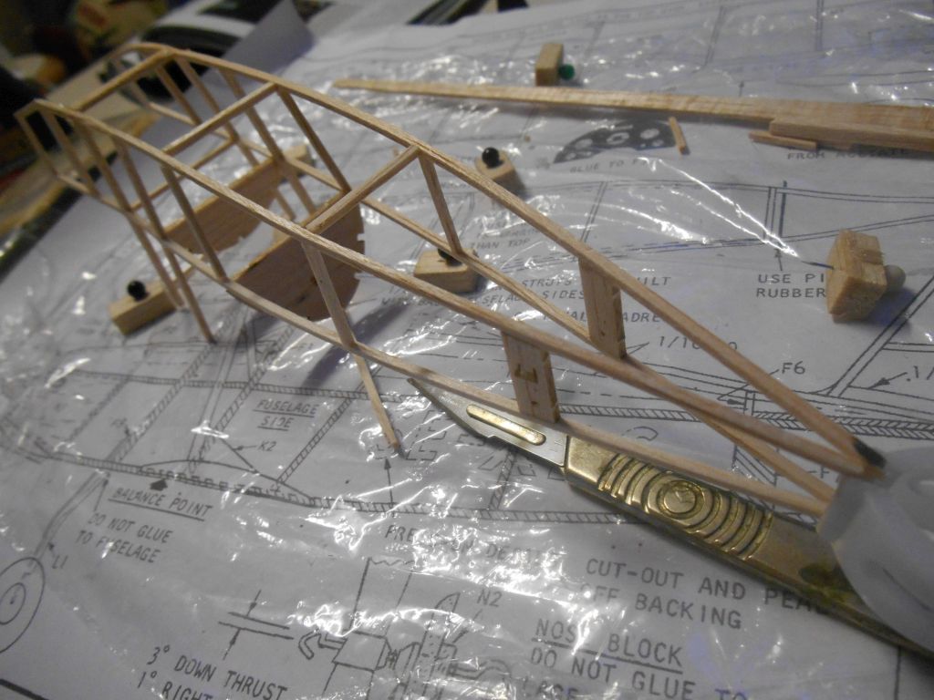

Fuselage sides built on the plan and the second side then built on top of the first with a layer of cling film protecting both sides from over applied adhesive. I use No More Nails PVA by the way, slightly thinner than Resin W which is my default big model glue.
Fin (and tailplane) assembled from 1/16 sq sticks. Gussets added as per plan

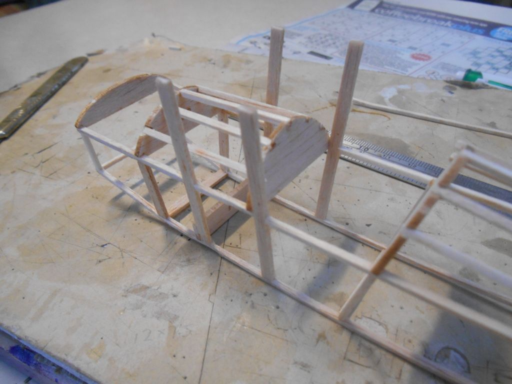

Assembling the fuselage sides with limited tools and jigs is always a bit tricky. More so with this model as the cross section is a Rhombic. The upper and lower widths are shown on the plan and spacers cut (including a couple of temporary ones), glued and allowed to dry.
Upper Stringers added. fuselage appears to be nice and straight.

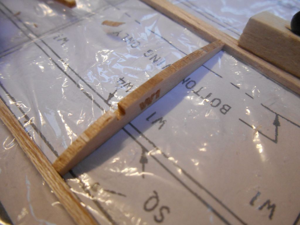

I then started work on the wings. Up until now I had blindly assumed that a laser cut kit should have parts that fit properly. What I found was that the 1/16 sheet parts were about 5% oversize... :dry:
Which had ramifications because the U/C mounting piece in the fus was also too big which meant that my carefully mounted undercarriage was also too wide..

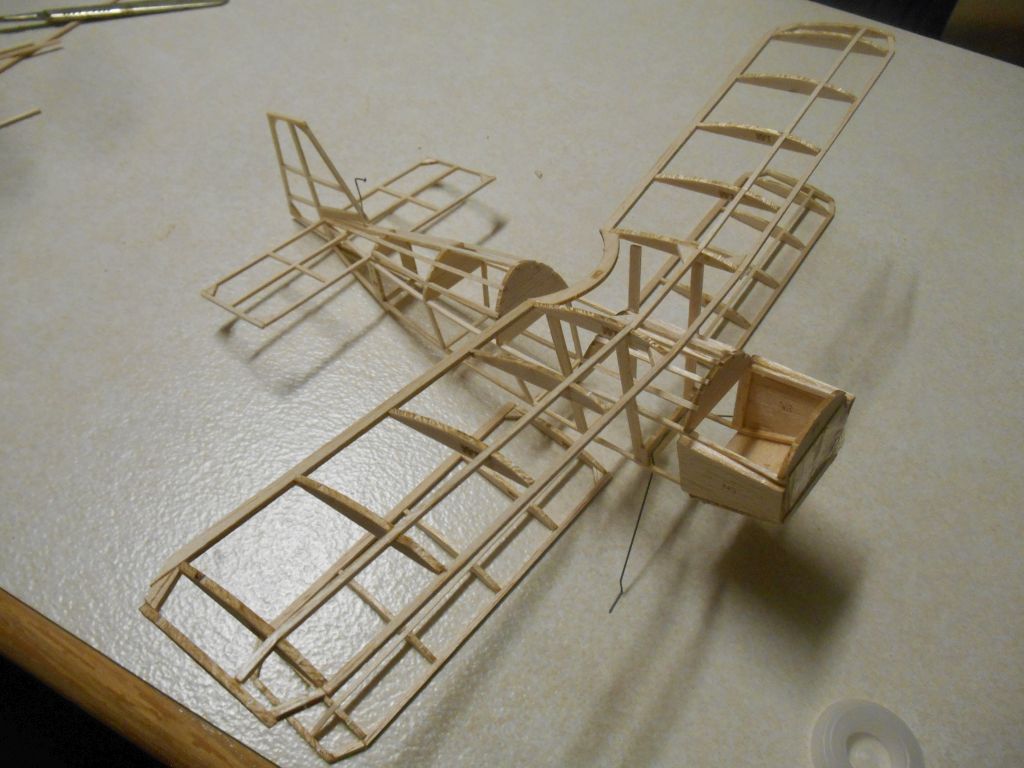

Wings assembled, the lower wings are identical to the upper except no centre section
The now inbuilt kink in the fuselage sides was removed by carving the inside edge of the balsa cowl cheeks - which worked remarkably well
And standing on two legs... with all the parts precariously balanced
Apart from fitting the nose block and a bit of sanding, this is where I am up to.
This is the scheme that I will probably adopt..
More to come - hopefully soon..

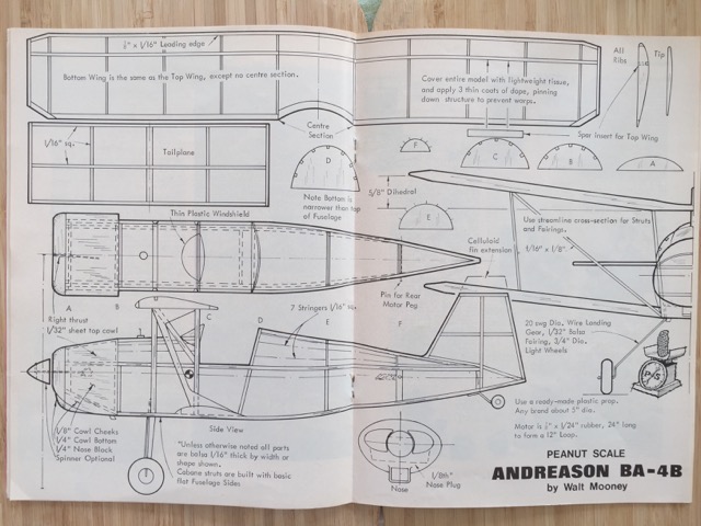

Does this help with docs?
tap - tap.......rivet
Thanks: Klipkopwildlife, martynk

Thanks - that is useful - need to import that into CAD I think

It would be nice to get them as a reference. I wouldn't have thought the plans would have been full size although TBH I have never seen a home build plans before.

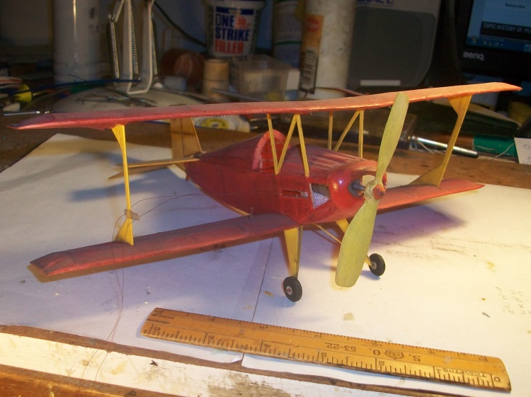

I built one of those a very long time ago - so long ago the original photo (1966!) is in black and white. :woohoo:
I think the plans were free in the Aeromodeller.
Converted to electric 'round the pole' control line with the nose shortened to allow for the relatively heavy 3V brushed motor.
Today's picture - 50 years later!

Good grief. That is impressive. Very nice looking little aeroplane. It looks about the same size as well judging by the rule in the foreground. I cant get a model to live for a year never mind 50 years.
I spent yesterday evening sanding the model down and un-squaring the LE and TE. I am going to revisit the cowl before I cover it, I notice on the photos that the rear of the cowl isn't flush with the fus so I am going to redo and build them out slightly and also try and get the shape correct. I also need to devise a method of cutting the inlet hole in the front. The plan indicates to simply paint it black but the Rolling Stones objected.
