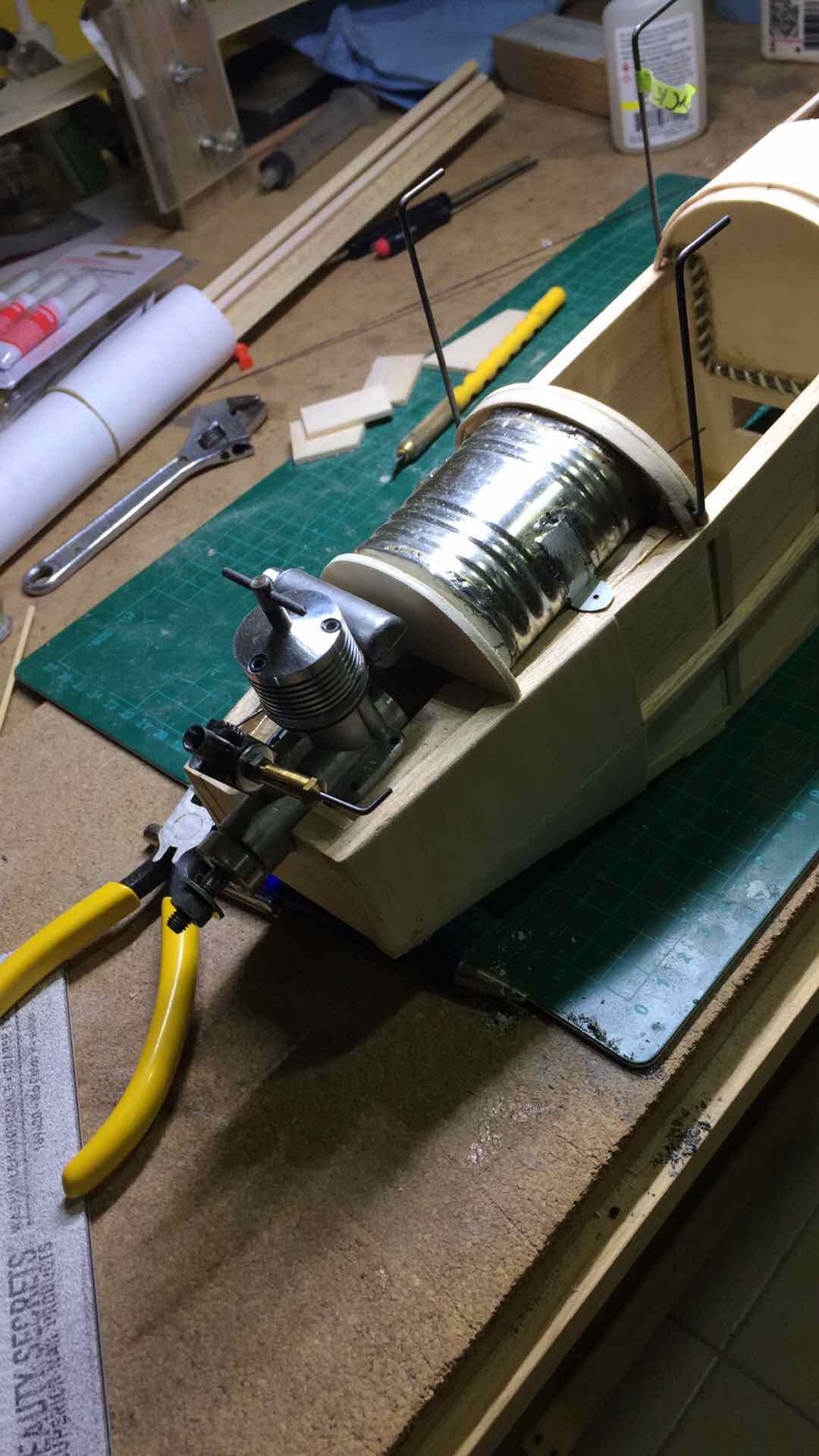

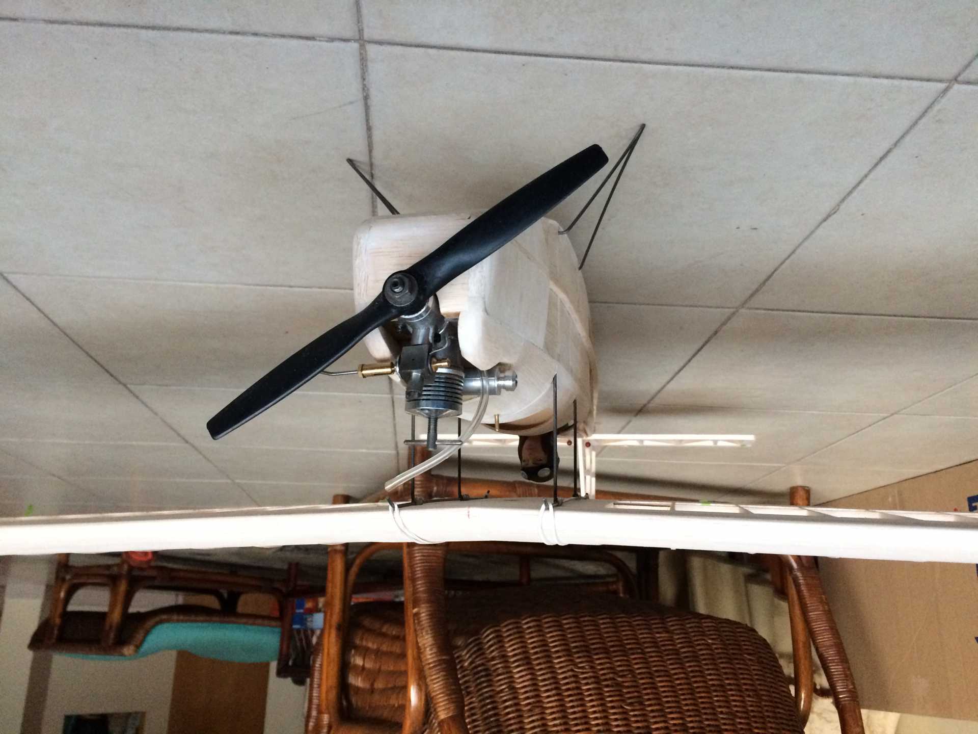

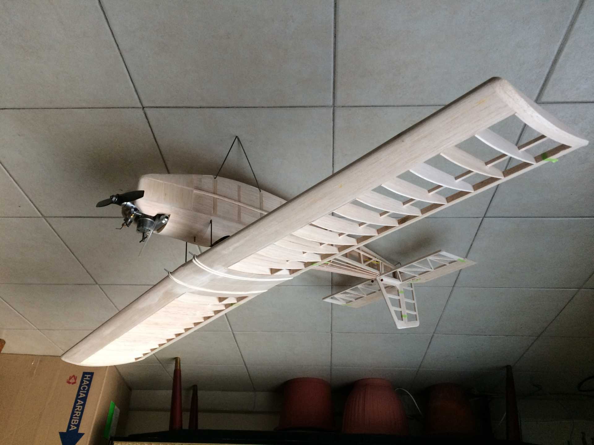

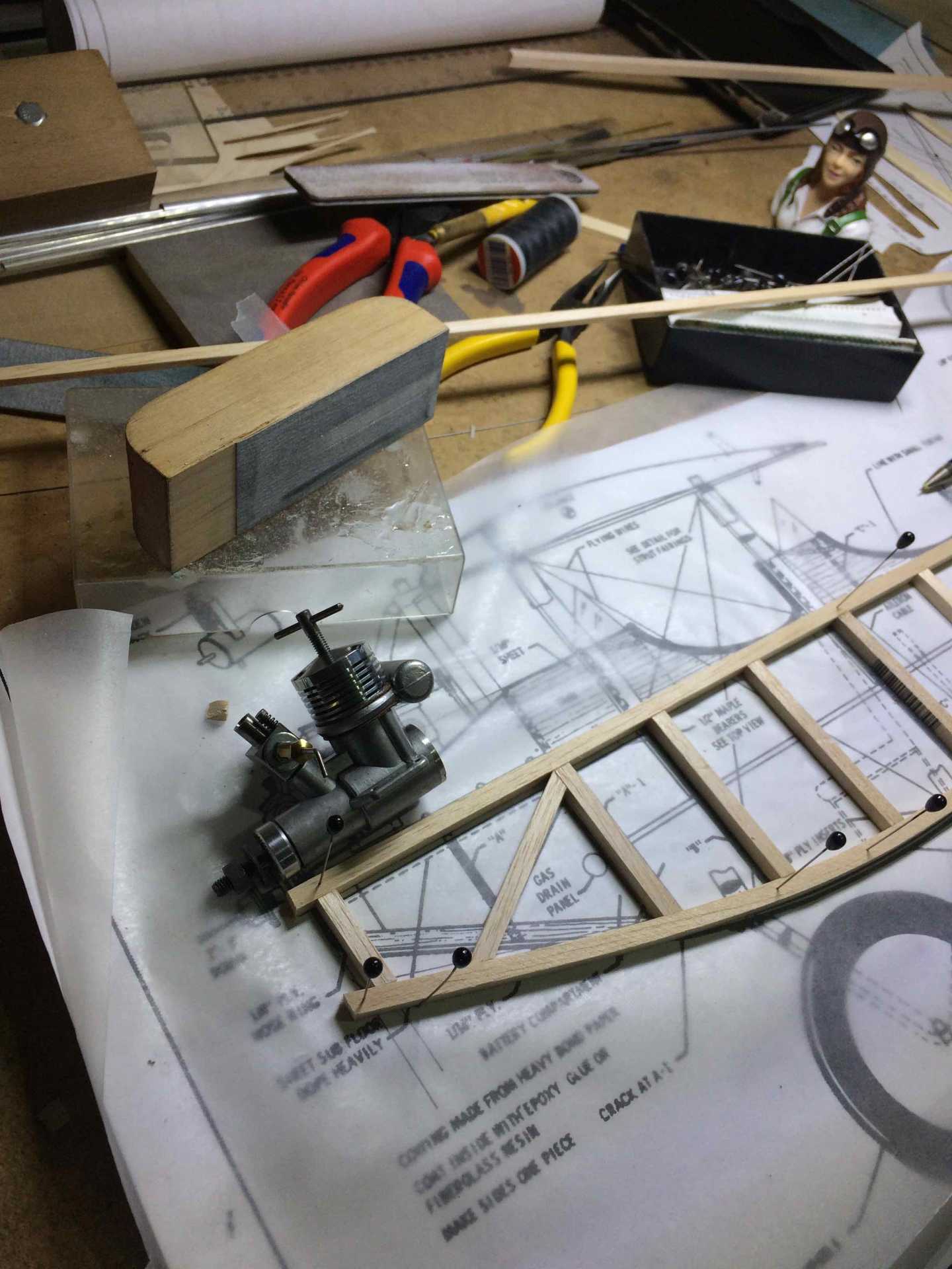

Hi Guys!
as my Gipsy moth is on cover/paint stage (long time consuming) i decided to cut some balsa and take some glue.
really love parasol and biplanes, and pietempol was a good option since i found that model but never decided a good size for it. I get an nice and new PAW 150 and decided to use on it.
the plan i´m using is the RCM with 56", a semiscale pietenpol, with enlarged elevator and some dihedral. decided to reduce the plan ( i think the paw 150 will fly the 56" but the small prop will look not nice) and having around a nice OS max III .15 and an enya 09 IV that share the same size mounts as my PAW, could be nice se how it goes with different engines.
now here is the main issue... i just know fly rc on 3 ch. .... i mean, or rudder or ailerons, no bought! so... what you thing about 3 channels?
another thing i decided is to modif. the nose of the engine, to get a more modern version with those boxter engines vs. ford T engine with large radiator in front of pilot!
here what i had done.

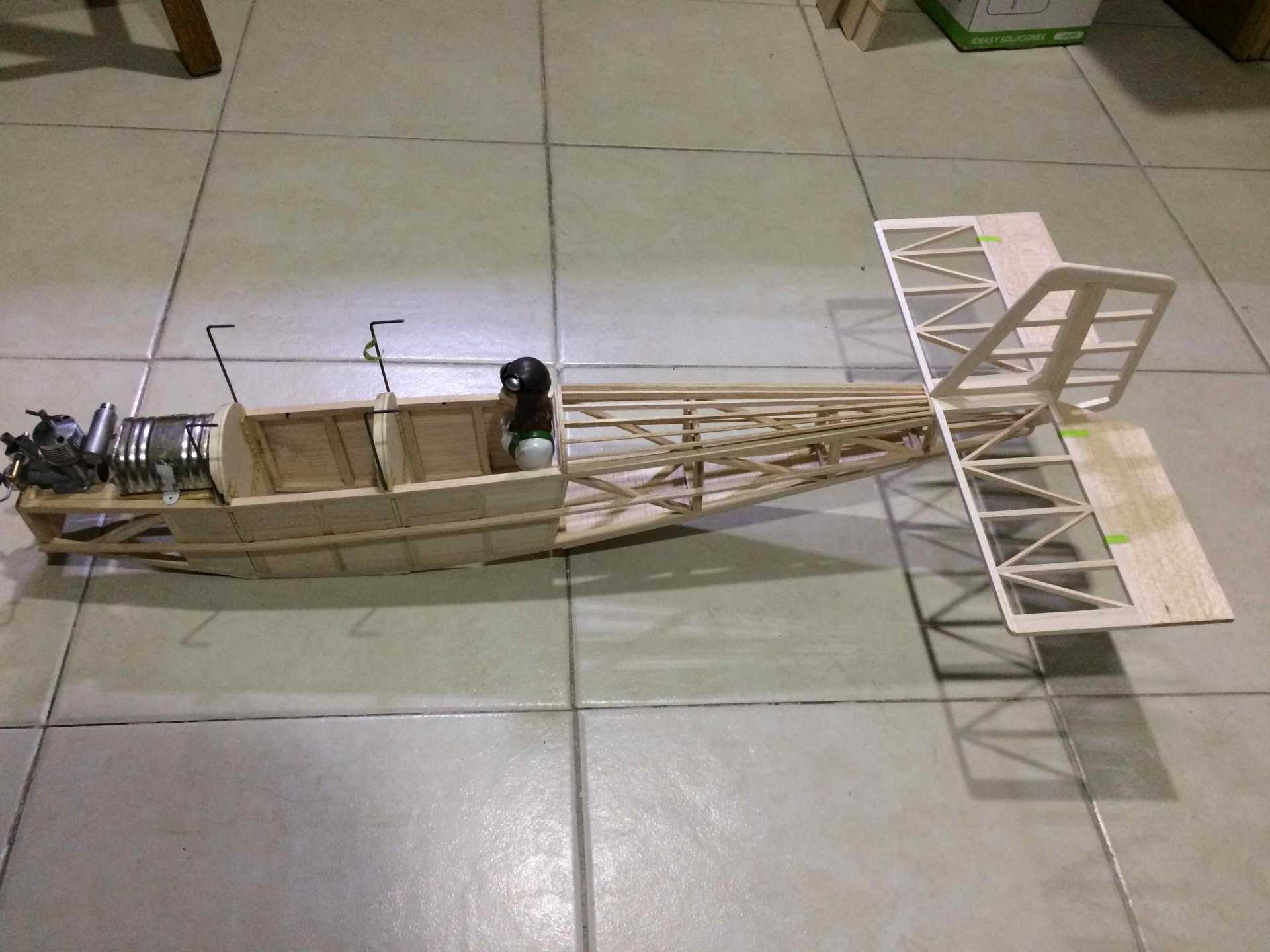

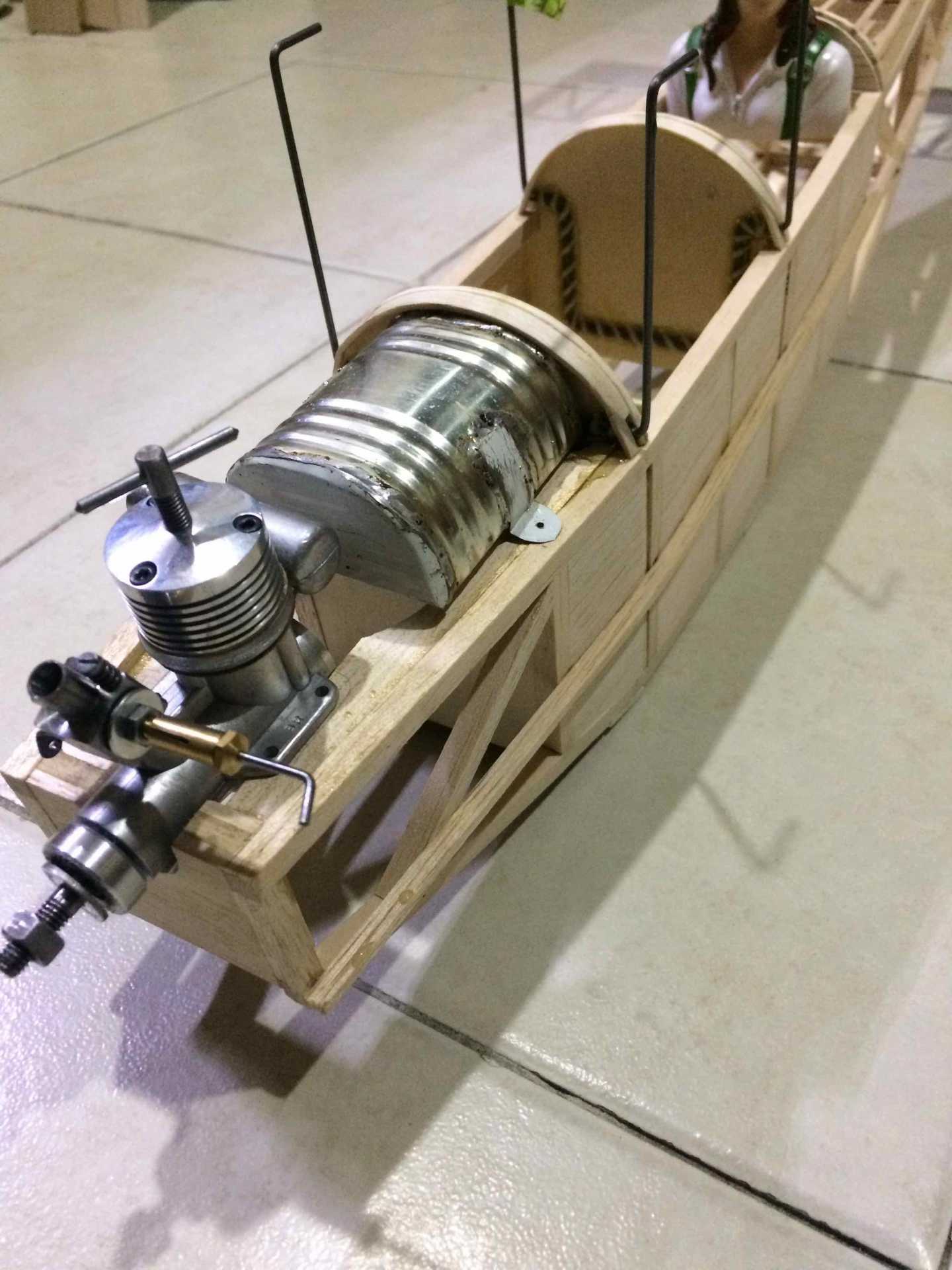

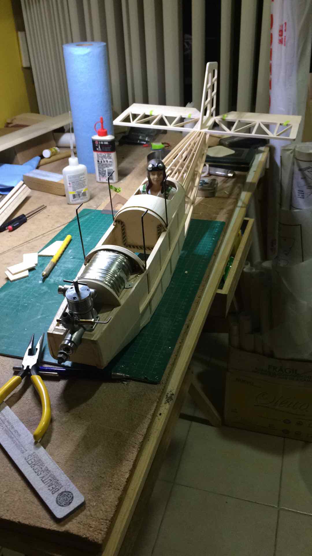

Hi Guys!
Some work done, kind of slow, as... don´t know, some models makes me happier! not this one!, i really love parasols, but, lets see, maybe a little more further looks better.
decided to to 4 channels, and this will be my trainer, so, not much scale on this, as i´m thinking to make ailerons all way out. and add just a little of dihedral.
let´s see how it goes. need to get some supplies for wings. but, now fuselage and tail have shape!

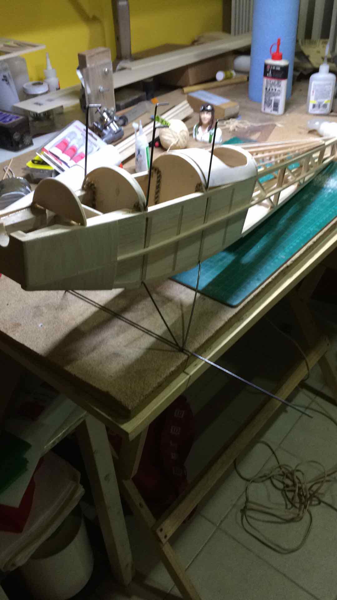

23 Nov 2017 13:56 #9 by Quorneng
Replied by Quorneng on topic Pietenpol 48" wingspan
Nice
Is that a home made (baked bean tin) tank?

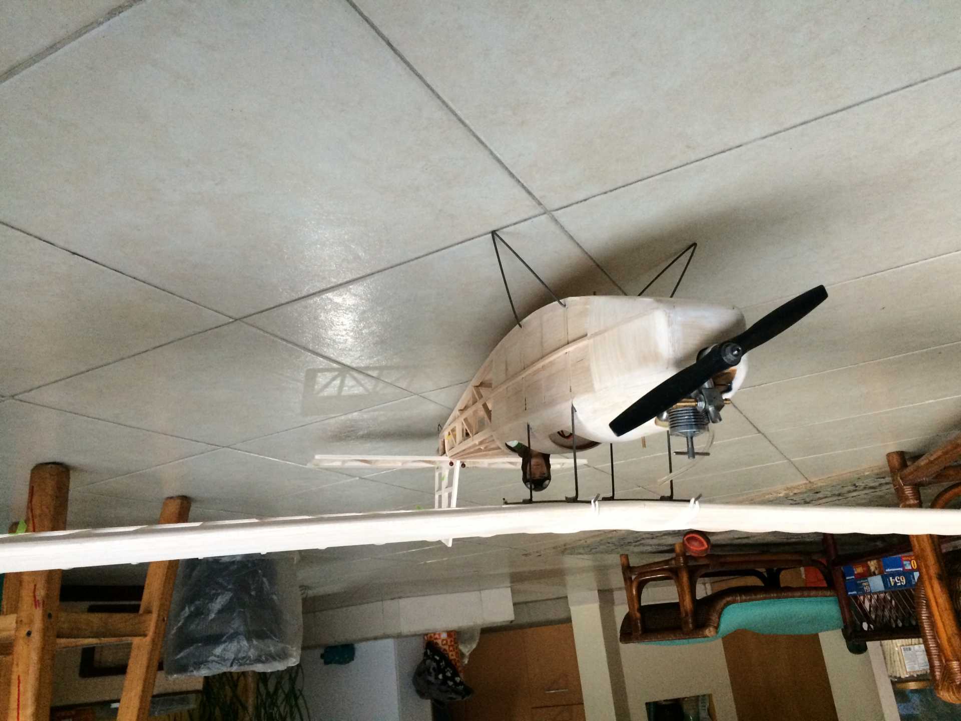

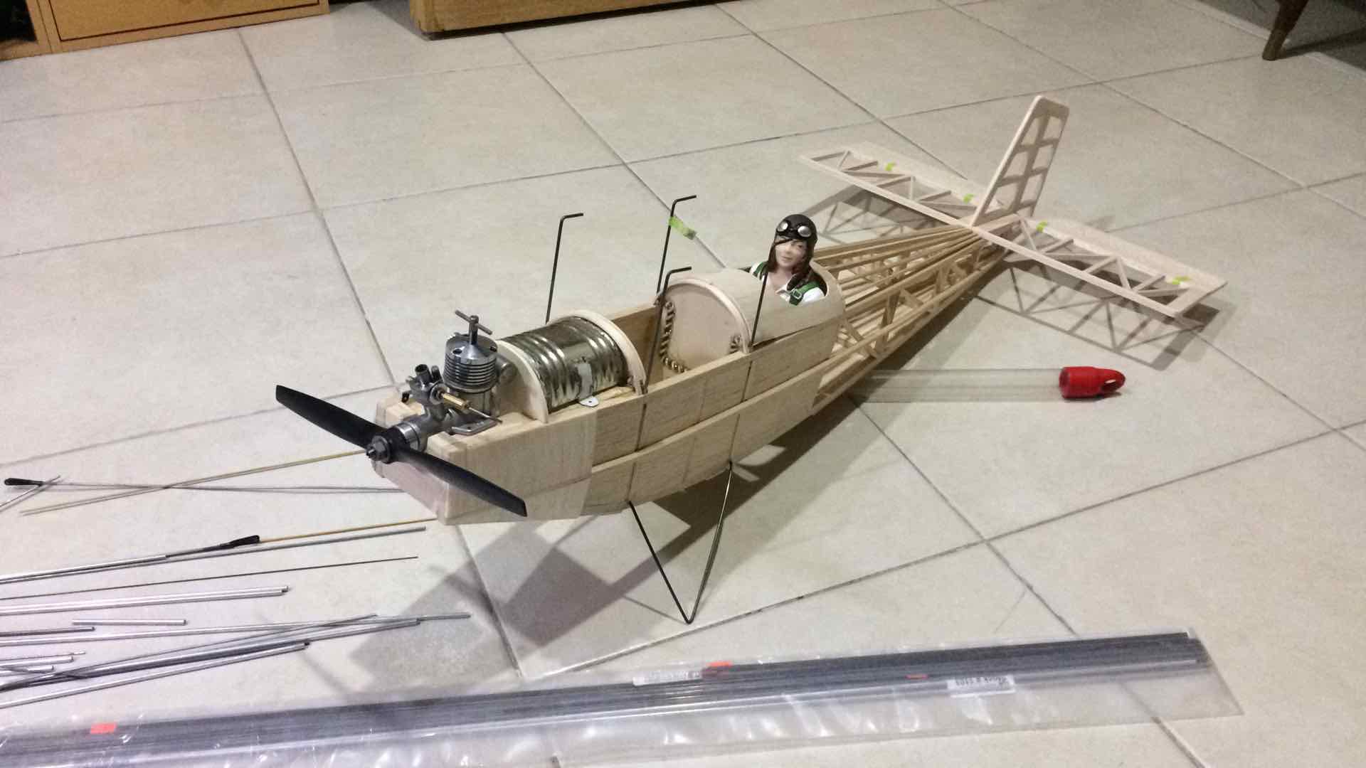

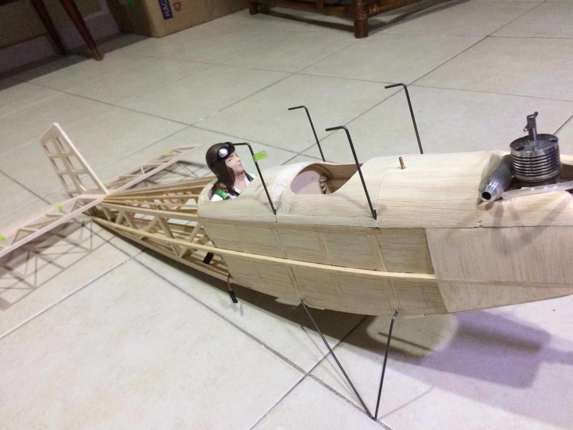

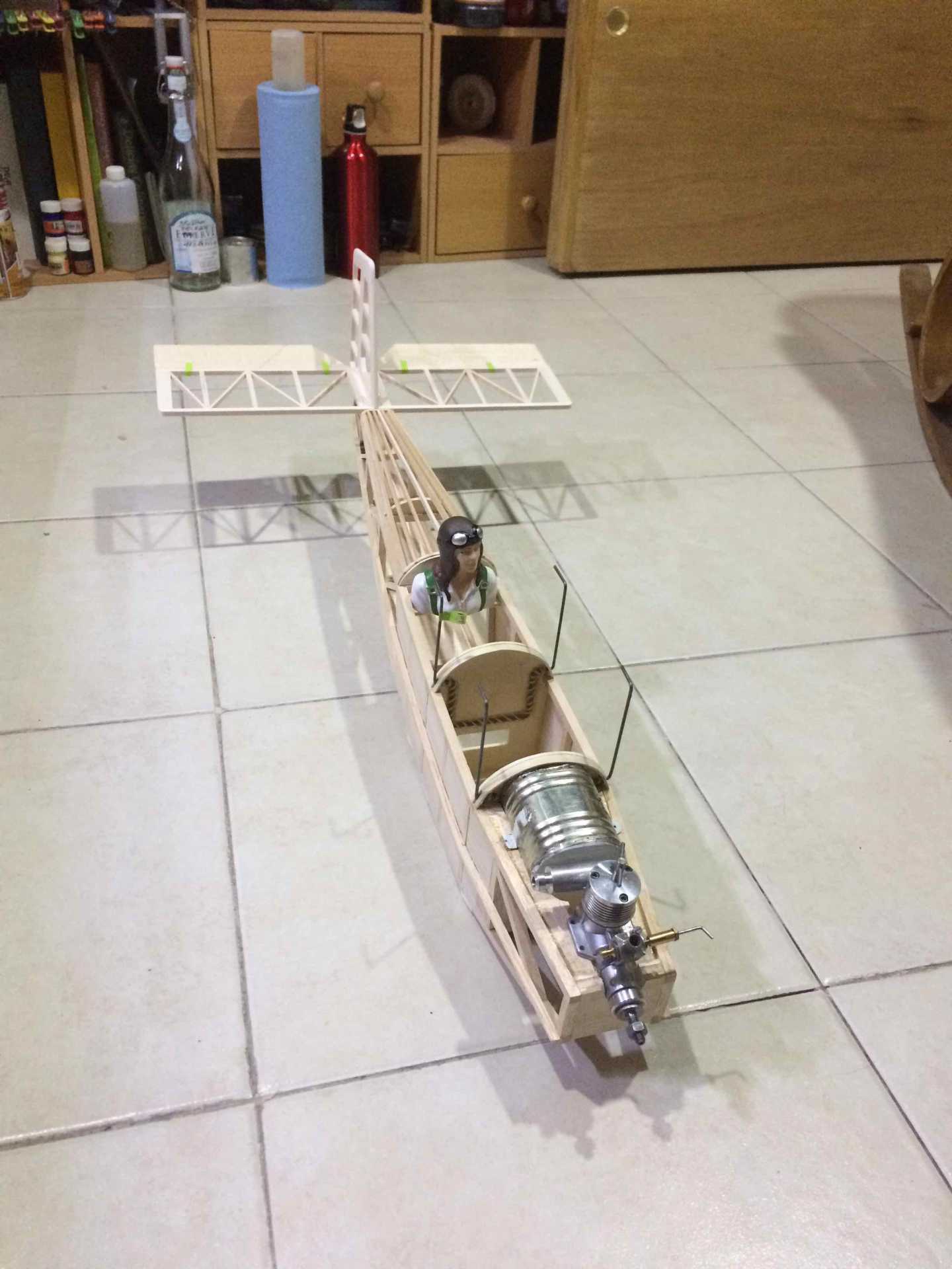

Hi Guys!
Some progress done in the last weeks. think is going to look good, not as a real scale, but close. and seems to be a good trainer plane, as i´m building to learn 4 ch. ( i only fly oldtimers with 2 or 3 ch)
Thanks: Klipkopwildlife, Quorneng, old fart, Ex-Member, boz, Squirrelnet
08 Feb 2018 07:23 #11 by Ex-Member
Replied by Ex-Member on topic Pietenpol 48" wingspan
That is a lovely looking model.
nice work sir.

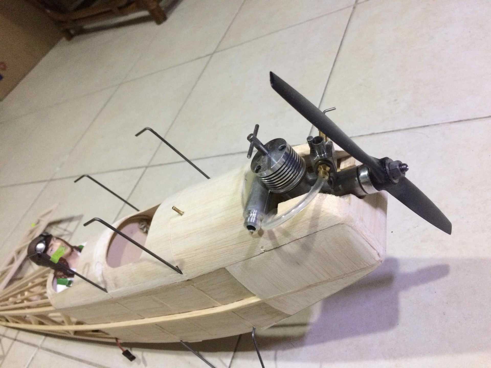

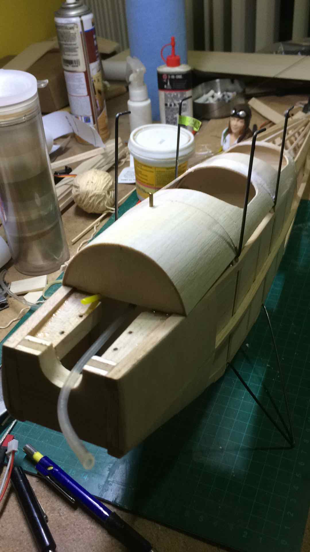

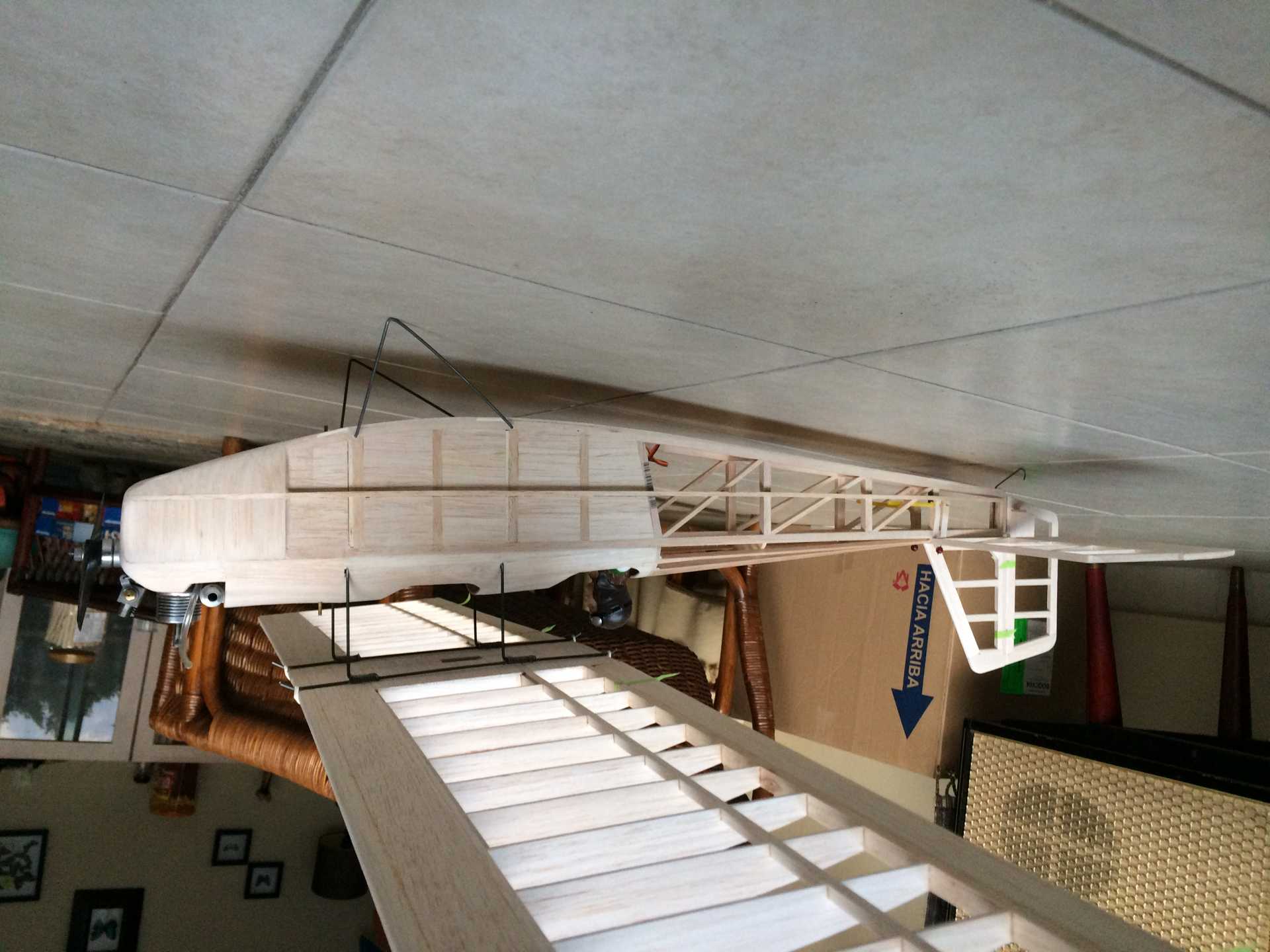

13 Feb 2018 01:12 #13 by ColibriGuitars
Replied by ColibriGuitars on topic Pietenpol 48" wingspan

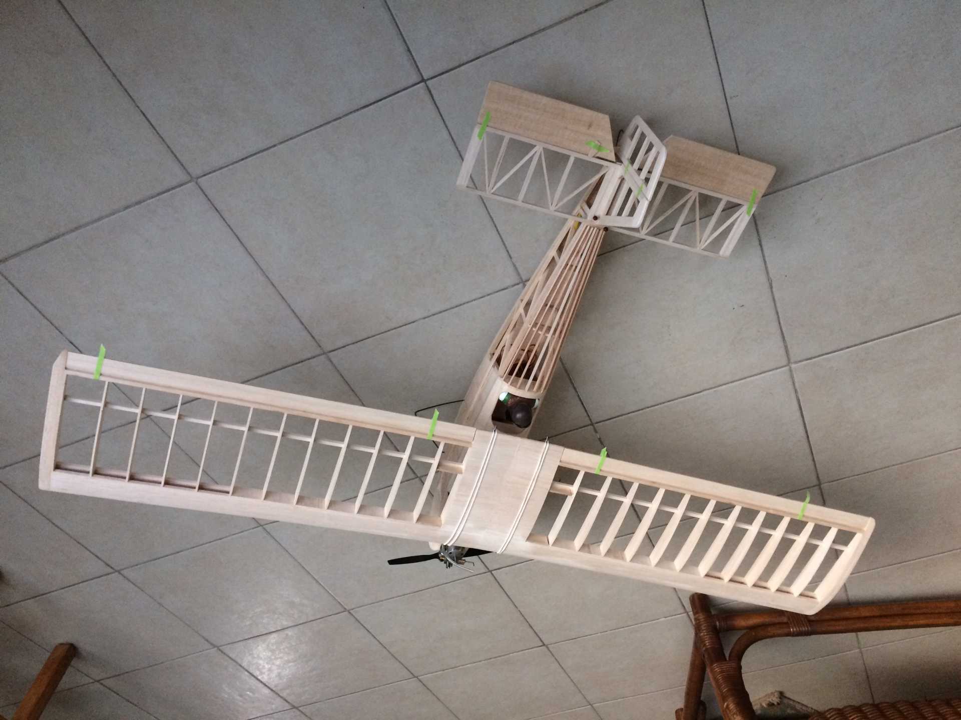

Hi Guys! Some more work done last weekend, so far, is getting close to get covered. at this stage, weights 685 grams including life battery, but missing wheels, covering, struds, aileron servo, etc. so...... think is on the heavy side.... hope to get something under 800 grams.
Thanks: Klipkopwildlife, Ex-Member, Squirrelnet
