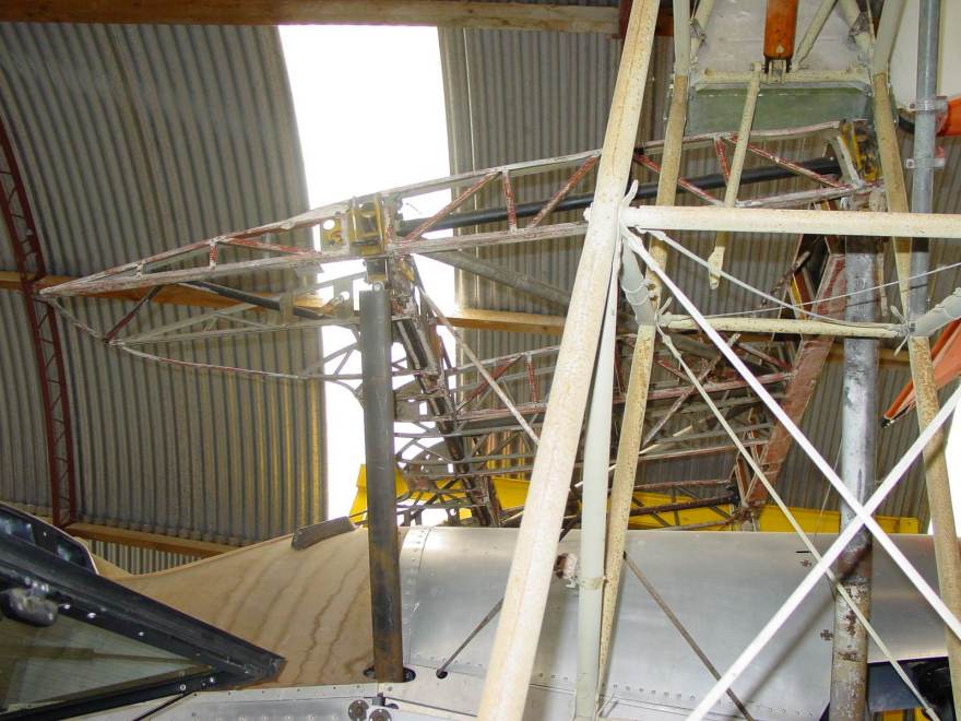

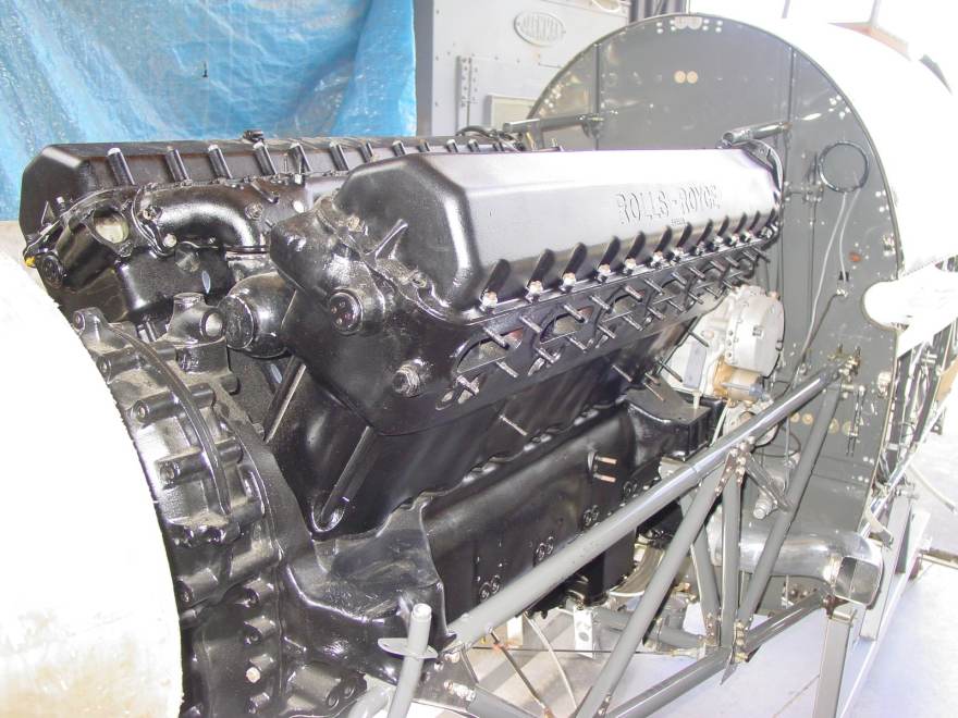

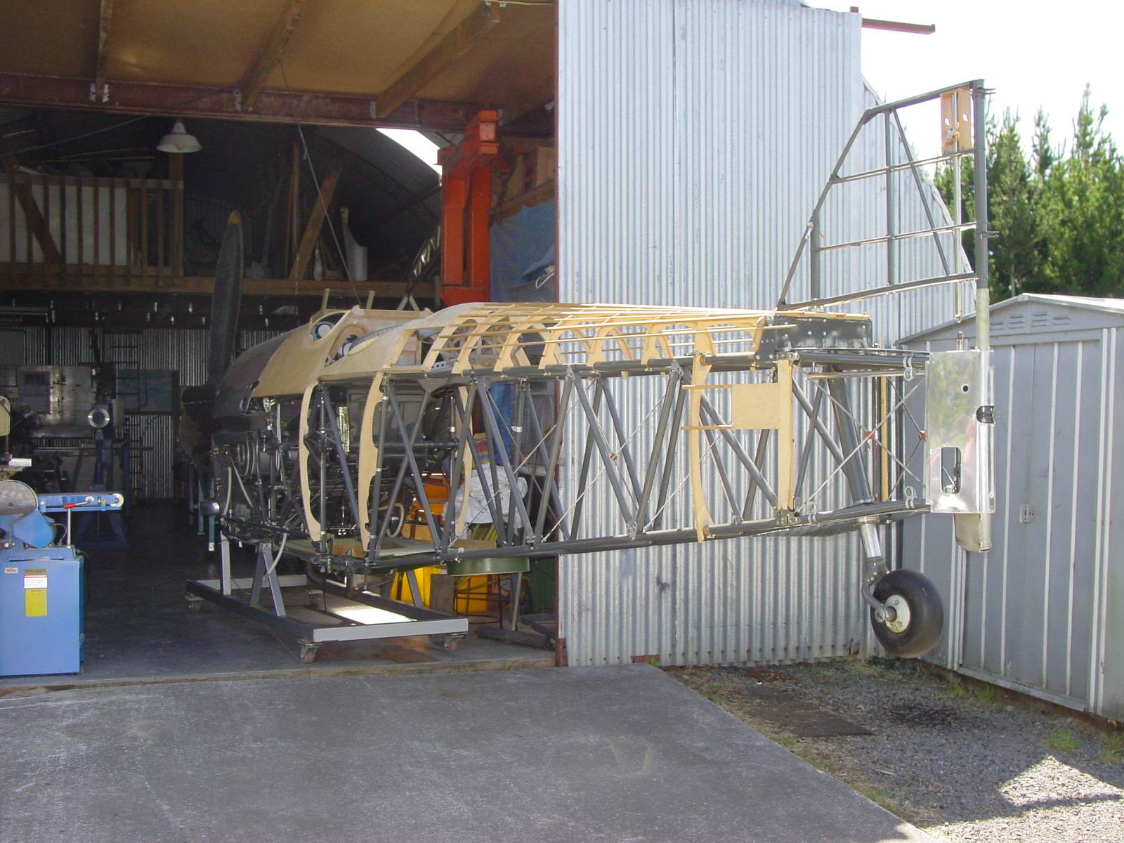

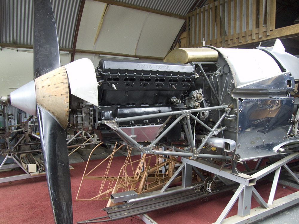

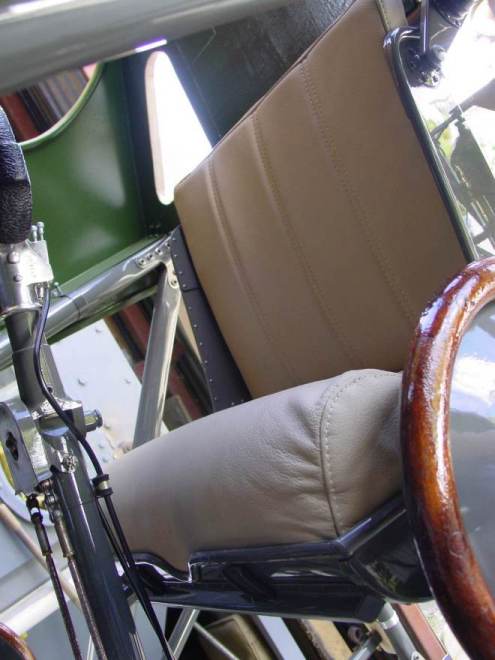

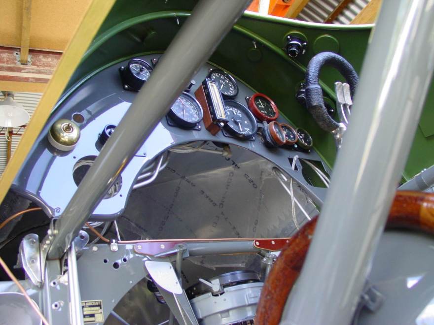

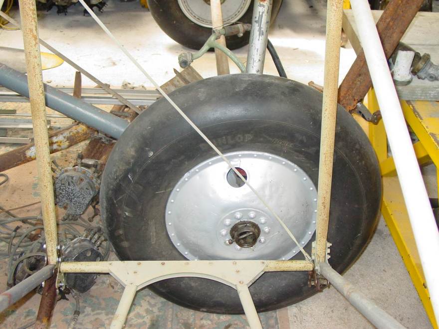

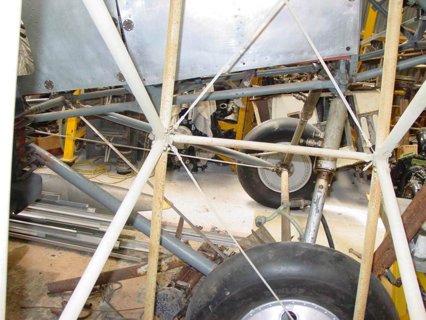

09 Oct 2020 07:32 - 09 Oct 2020 08:00 #7 by Kiwi
Replied by Kiwi on topic Hawker Hart
Here are the first few photos of a Hawker Hind restoration being done north of Auckland by a friend of mine.More soon
Last edit: 09 Oct 2020 08:00 by Klipkopwildlife. Reason: Put pics in
Thanks: Eric, Flytilbroke, Quorneng, old fart, paul d, crash happy, supertigrefan, Alexrcm
09 Oct 2020 08:03 #8 by Klipkopwildlife
Replied by Klipkopwildlife on topic Hawker Hart
Wow Kiwi, that certainly a labour of love. You forgot to insert the pics into the message, I've done it for you.
  • crash happy's Avatar
09 Oct 2020 08:27 #9 by crash happy
Replied by crash happy on topic Hawker Hart
Nice pictures Kiwi ! :cheer: I just love the old brass & ceramic light switch in the cockpit ! :huh:
10 Oct 2020 08:50 - 10 Oct 2020 11:07 #10 by Kiwi
It's not that I forgot to embed the images, more a case of I couldn't work out how to do it
Last edit: 10 Oct 2020 11:07 by Klipkopwildlife. Reason: Insert pics

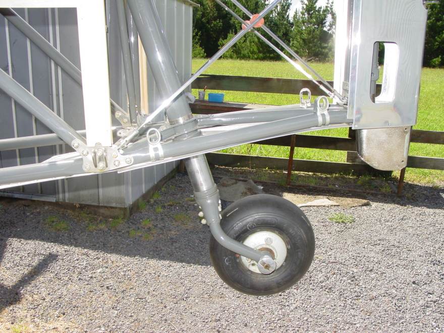

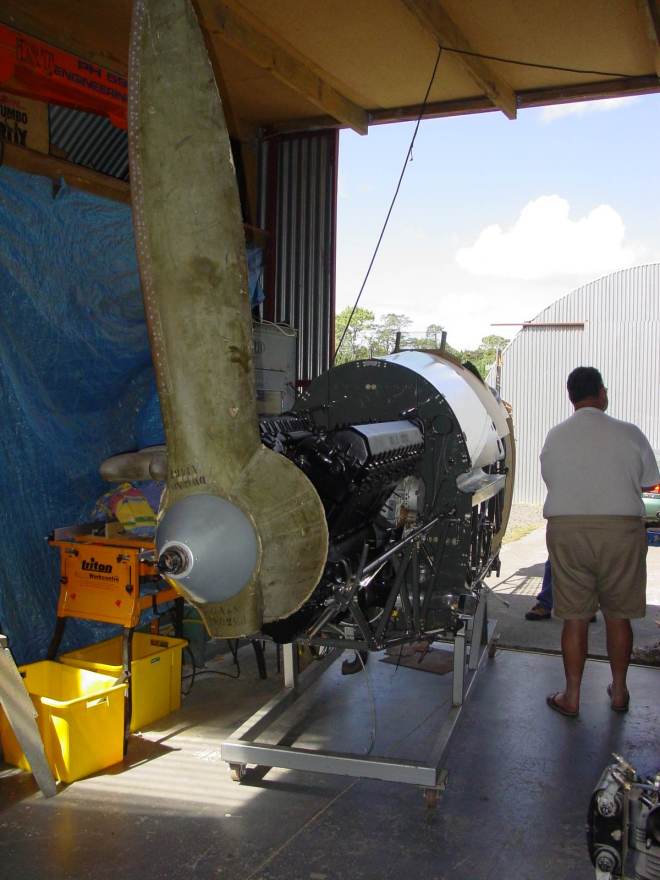

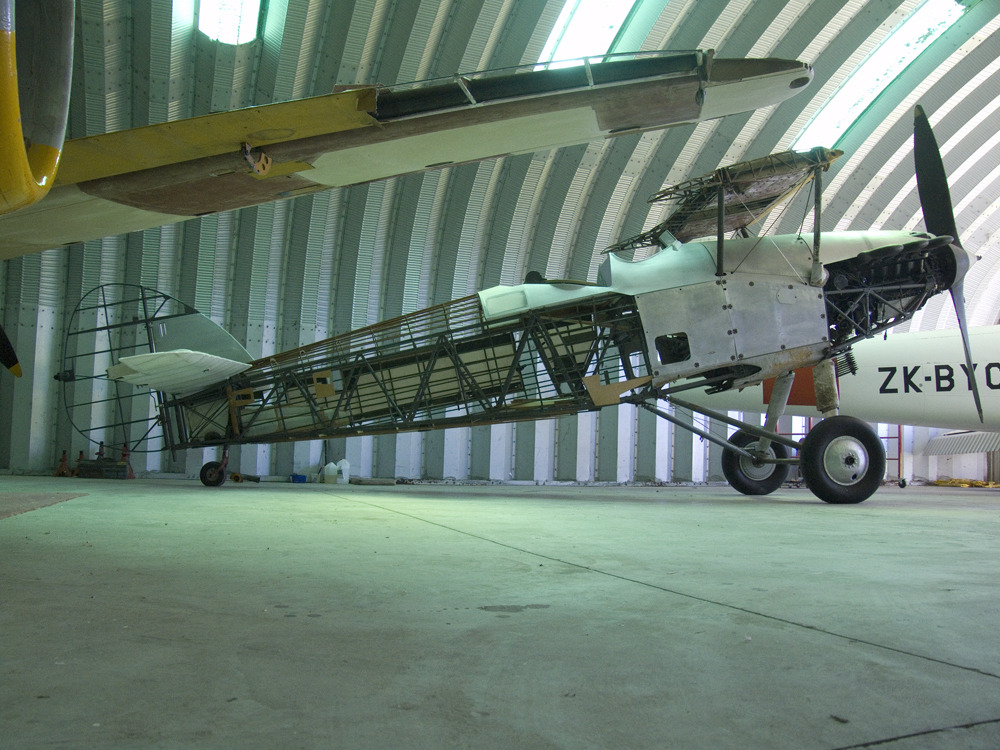

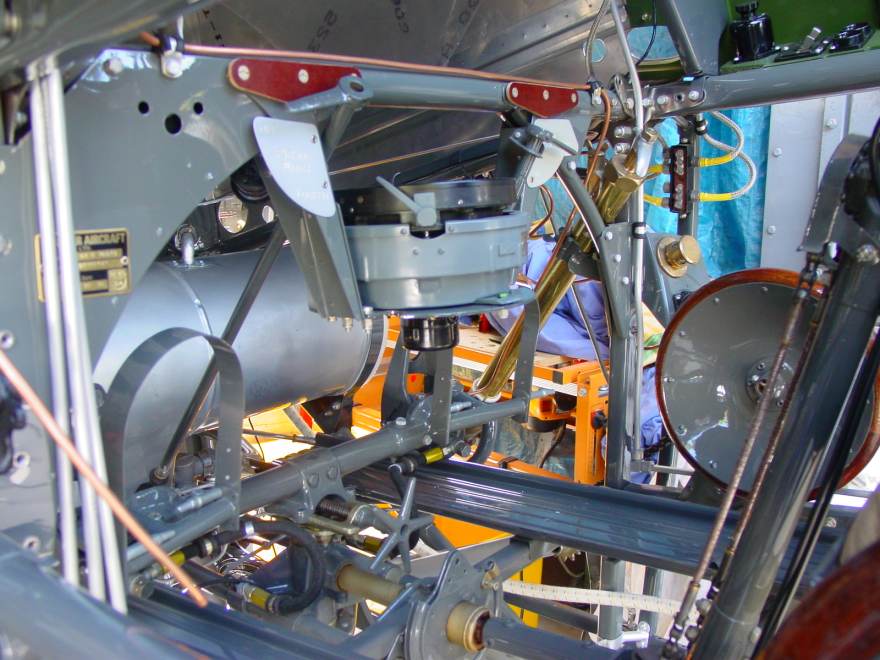

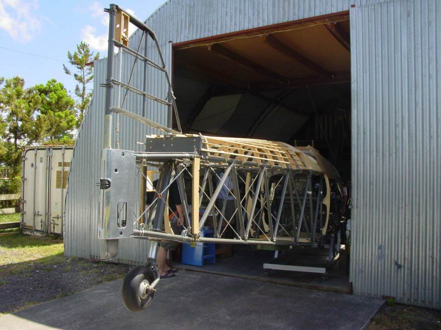

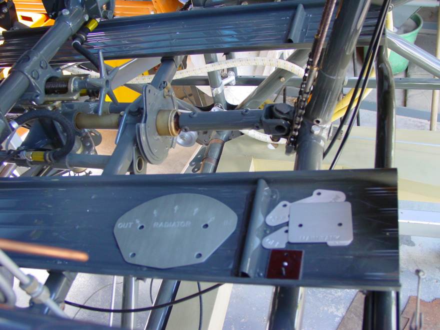

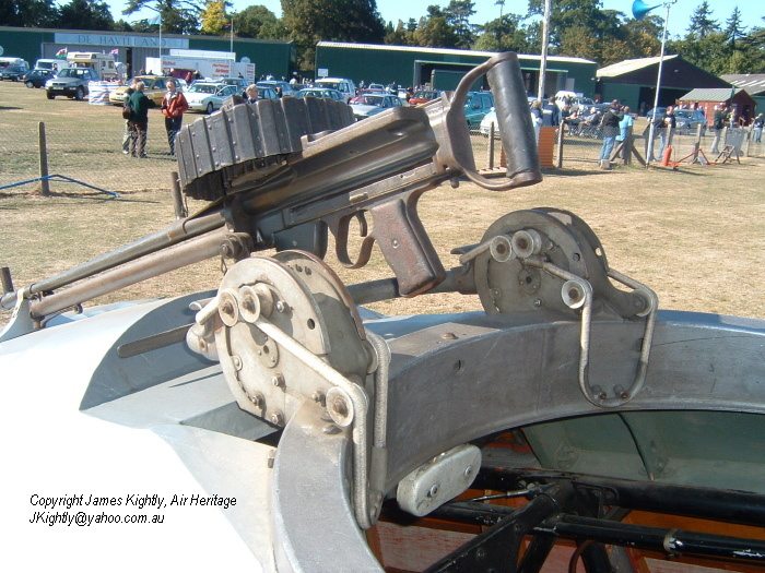

10 Oct 2020 08:56 #11 by Kiwi
Last few
Thanks: Klipkopwildlife, Flytilbroke, Quorneng, crash happy, supertigrefan

10 Oct 2020 11:19 - 10 Oct 2020 11:22 #14 by Quorneng
Replied by Quorneng on topic Hawker Hart
When you see such 'restoration' pictures it makes you realise just how similar the construction of the Hart is to the Hurricane
Hart
Hurricane
A bit more attention to the woodwork streamlining but the underlying structure is virtually identical.
Last edit: 10 Oct 2020 11:22 by Quorneng.
