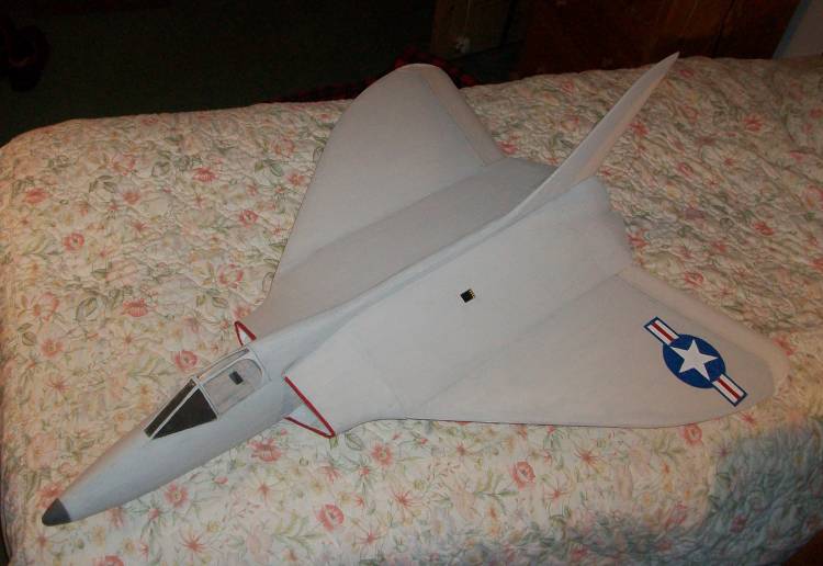

My avatar Skyray was 'built' out of well over 100 pieces in foam with just a bit of balsa. Within the usual limitations of a ducted design it is also to scale and probably more so than some as it has a scale wing section as well.

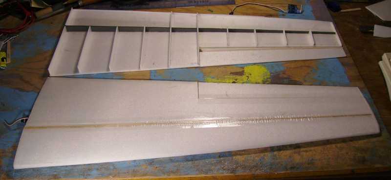

My first 40" Depron wing (a 12% Clark Y) was made entirely in 3mm Depron and a true monocoque with no spar as such just a web to locate the ribs.

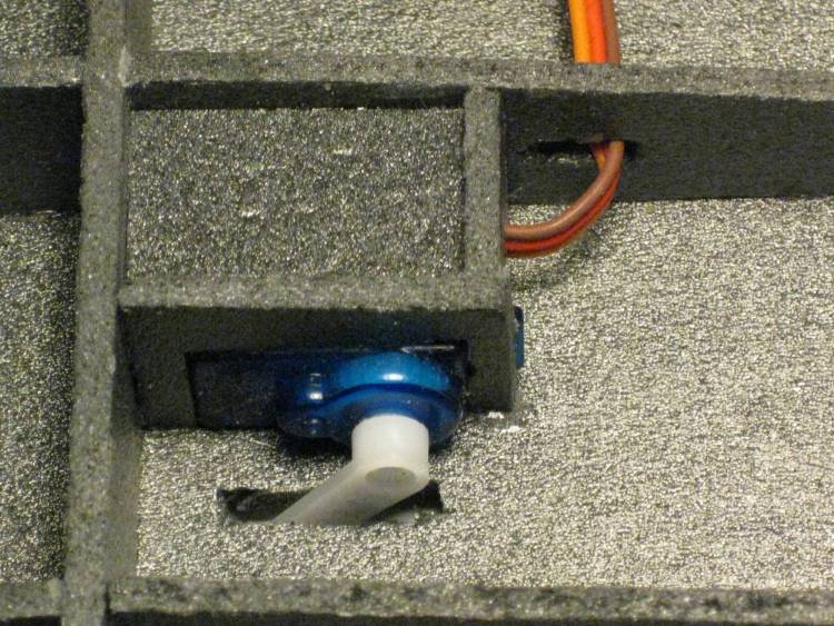

Even the servo mounts
Only the leading edge was balsa simply because at the time I had not found a satisfactory way of doing it in Depron.
This wing proved to be much more efficient than the solid foam one it replaced.

I now had the techniques to build a light, low powered, scale fast jet in Depron.
Why? Just to see if I could!

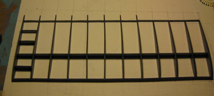

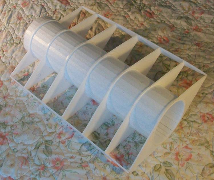

The duct and centre section

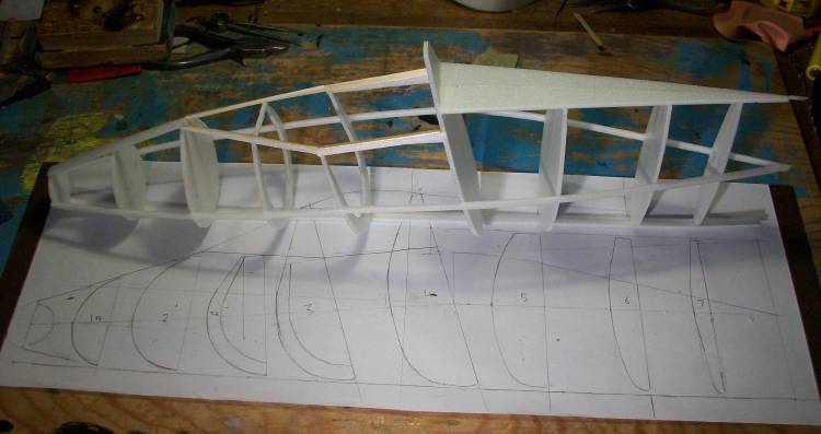

The all Depron fuselage frame work prior to skinning
You have to be a bit daft to build like this but it certainly works.

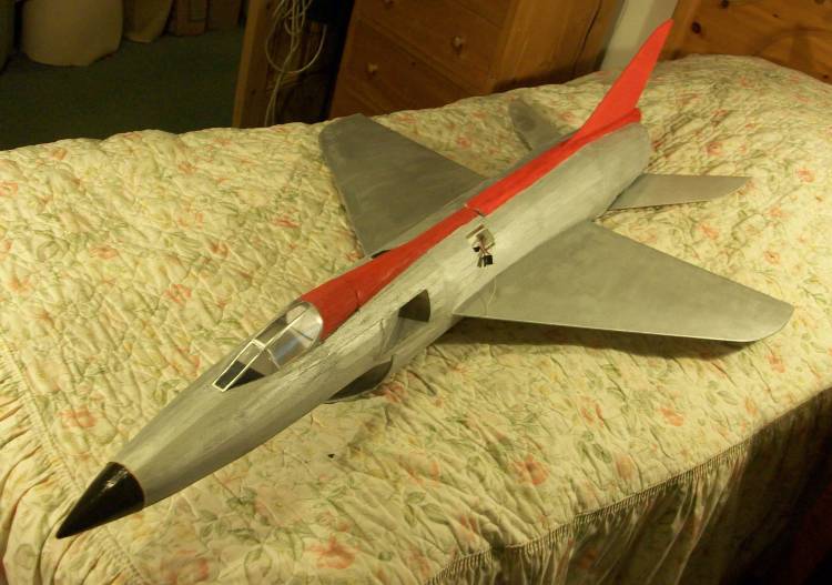

The Skyray makes a good ducted fan as the short fuselage reduces duct losses but this is offset by the relative aerodynamic inefficency of a delta wing.
For comparison I decided to keep exactly the same motor, prop (4.5x4.5) and battery but put in a more conventional fast jet layout.
This is impressive, the Hawker P1121. The so called 'Super Hunter'.
The prototype was never completed but like most Hawker jets it looked nice.
Rather more complex to build than the Skyray with a much longer duct and even thinner wings.
This is how it end up. It is only 1/2oz heavier than the 'Ray'.

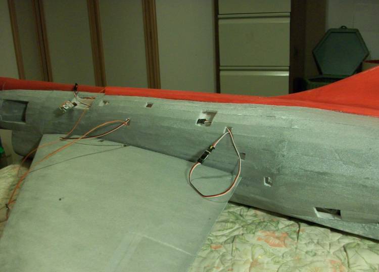

To save weight it used an all moving elevon tail although the original had a conventional all moving tailplane and ailerons.
This proved a mistake as its one and only 'flight' showed a serious lack of roll control. Unable to turn the 10 second flight ended in the next field fortunately with no damage.
Ailerons have to be added but this is where my 'built it all in' technique comes back to bite.
Removing the old and adding the new servo cables down the fuselage has needed quite a bit of 'key hole' surgery.
It is proving to be quite a job!

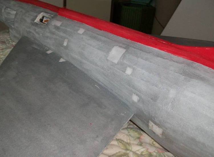

The access holes made good with skin inserts simply glued in.
A job made much easier as the Depron is 3mm thick, gives a bit and is very easy to cut to shape.
Virtually as strong as the original and overall adds very little weight.
I hope its going to be worth all the effort!
