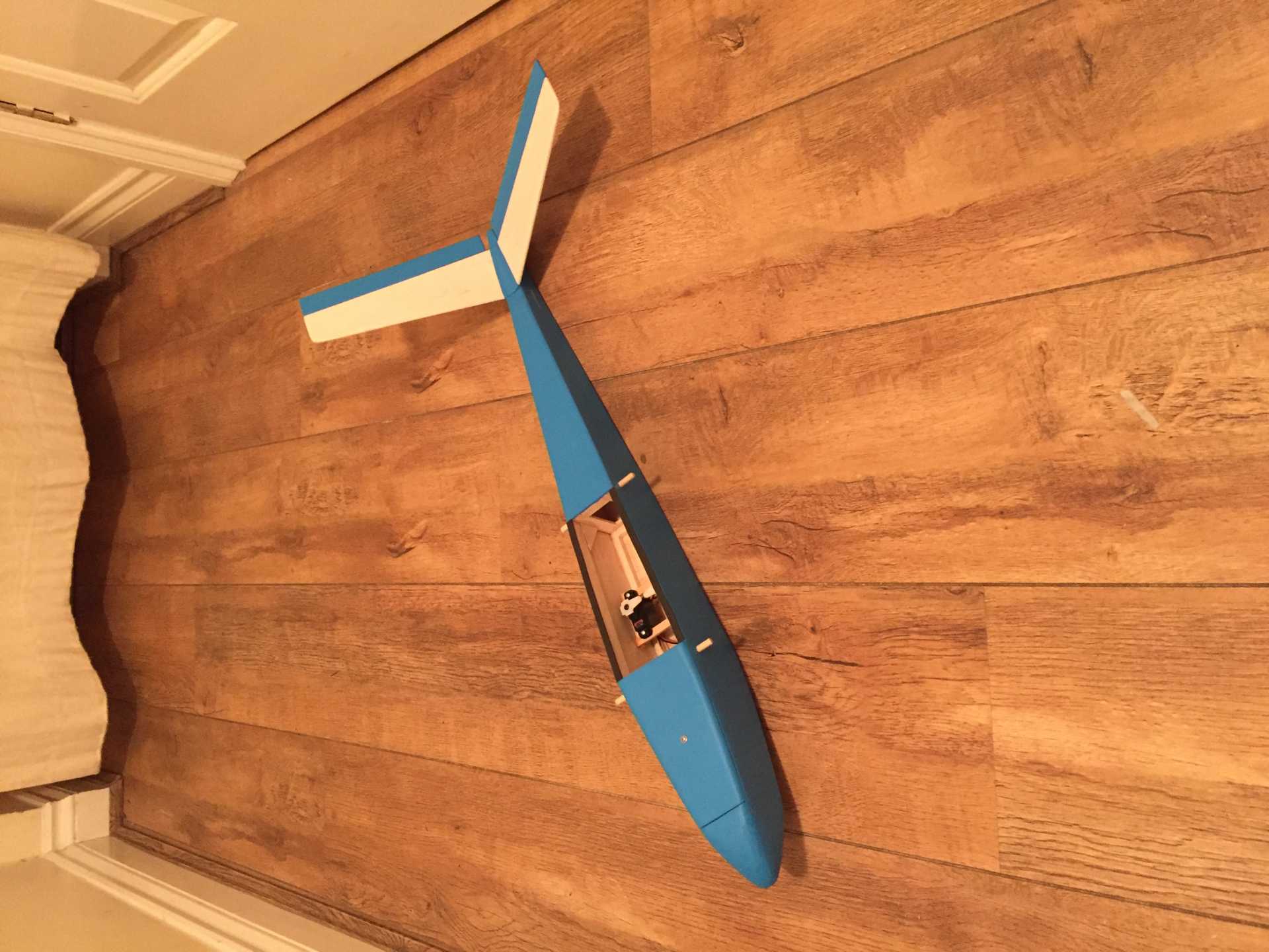

Fuselage sides are together.
Ron

Fuselage is covered in blue solartex. Love the colour
I think the sliding servo method is all there was back in 1969, looked a bit clunky.
Ron

26 Feb 2016 13:30 #6 by Klipkopwildlife
Replied by Klipkopwildlife on topic Little V
Can you imagine, no mixes, no reversing, servos came in 2 flavours, red or black, depending whether you wanted normal or reversed!
Of course, Garry was a boy then, aside from me he's about the only other one who'll remember!
Back on topic, that fuselage looks the bees knees, is that paint or cover of some kind?

Yes I'm quite happy with the covering. It went on well. Its solartex light blue. Wings will be covered in solartex "natural" with a blue leading edge. Not built them yet though.
Just got the tail on.

A very nice piece of covering on the fuselage.
That looks a rather shallow angle V tail. My guess it will have rather a weak rudder with quite a noticeable 'anti roll' effect when it is applied.

Regarding the angle of the V, I actually thought the same so I double checked it on the plan and it's spot on, maybe it was intentional, not sure. At least it won't be too sensitive.

You may find that the shallow V causes a lot of 'fish-tailing' in flight, as well as anti-roll, as mentioned, ie give left rudder, the model tries to roll right.
Regarding the mechanical mixers, there were two other options - one was a pair of 180 bellcranks on a common pivot mounted in a rocking frame pivoted at the bottom, which was screwed to the fuselage.. The top of the frame was coupled to the elevator servo, and the top of the two bellcranks coupled to the two sides of the aileron (or flap) servo. the bottom of the two bellcranks then connected to the surface. You would probably have to draw it out to see how it works.
The other way I still have an example of -
File Attachment:
File Attachment:
It follows the same principle, the triple ball can turn with the aileron servo, or rock with the elevator servo, or of course, both at once! The centre ball connected to the elevator servo, and the two outers to the control surfaces.
The sliding servo method was prone to be very sloppy in operation.
