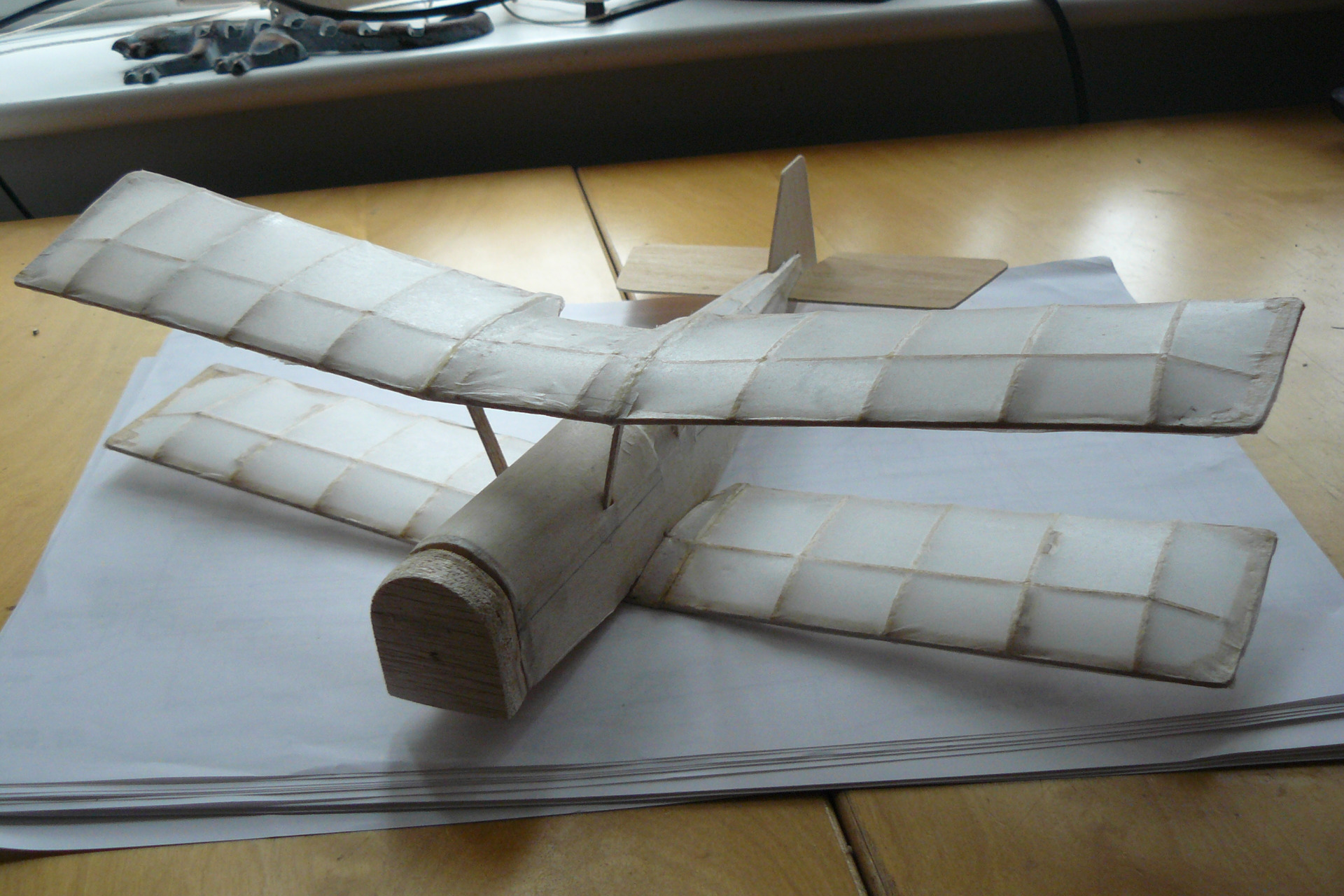

This is the first loose assembly, without the wheels & outer struts, the next stage is to paint it before it can be glued together. There are a couple of paint schemes on OuterZone, it seems the choice is 50 shades of kahki. On ebay the choice of tubs of acrylic is 69ml or 500ml with a similar difference in price.
There is a large amount of wash-out on the right-hand upper wing so I've got to see what I can do about that.

26 Sep 2024 15:09 #18 by Eric
Replied by Eric on topic SE5 KK-OZ1320
Sheeting the tail and fin would add weight to the back - not a good idea.
That upper right wing isn't just washout - it has warped. I'm no expert with these ultra-lights, but I'd say it should be scrapped, and make  new wing.
When you doped it, did you leave it pinned down for a couple of DAYS while the dope dried?
  • Magpie
  • Magpie's Avatar Topic Author
26 Sep 2024 15:27 #19 by Magpie
Replied by Magpie on topic SE5 KK-OZ1320
No I'm too much of a dope to do that!
Its pinned down now (after being sprayed with water) so i'll have to wait & see.
So its straight-foward to pin the bottom down while the top dries but what about the other way up? If its pinned bottom-down while the bottom dries won't it stick, even on plastic?

27 Sep 2024 08:47 #21 by Magpie
Leaving the right-hand upper wing pinned down overnight seems to have removed the wash-out. It had only received a single spray of 50/50 dope. Some water spray drift has also removed the wrinkles on the centre section. Now all four corners sit down so it isn't warped. It may have looked warped because the wing was only balanced on the centre struts & not squared or anything.
I'm going to do the same thing to the left-side, it also has a slight amount of wash-out, nowhere near as much as the right.
So that just leaves the question of pinning it down while the underside is wet.

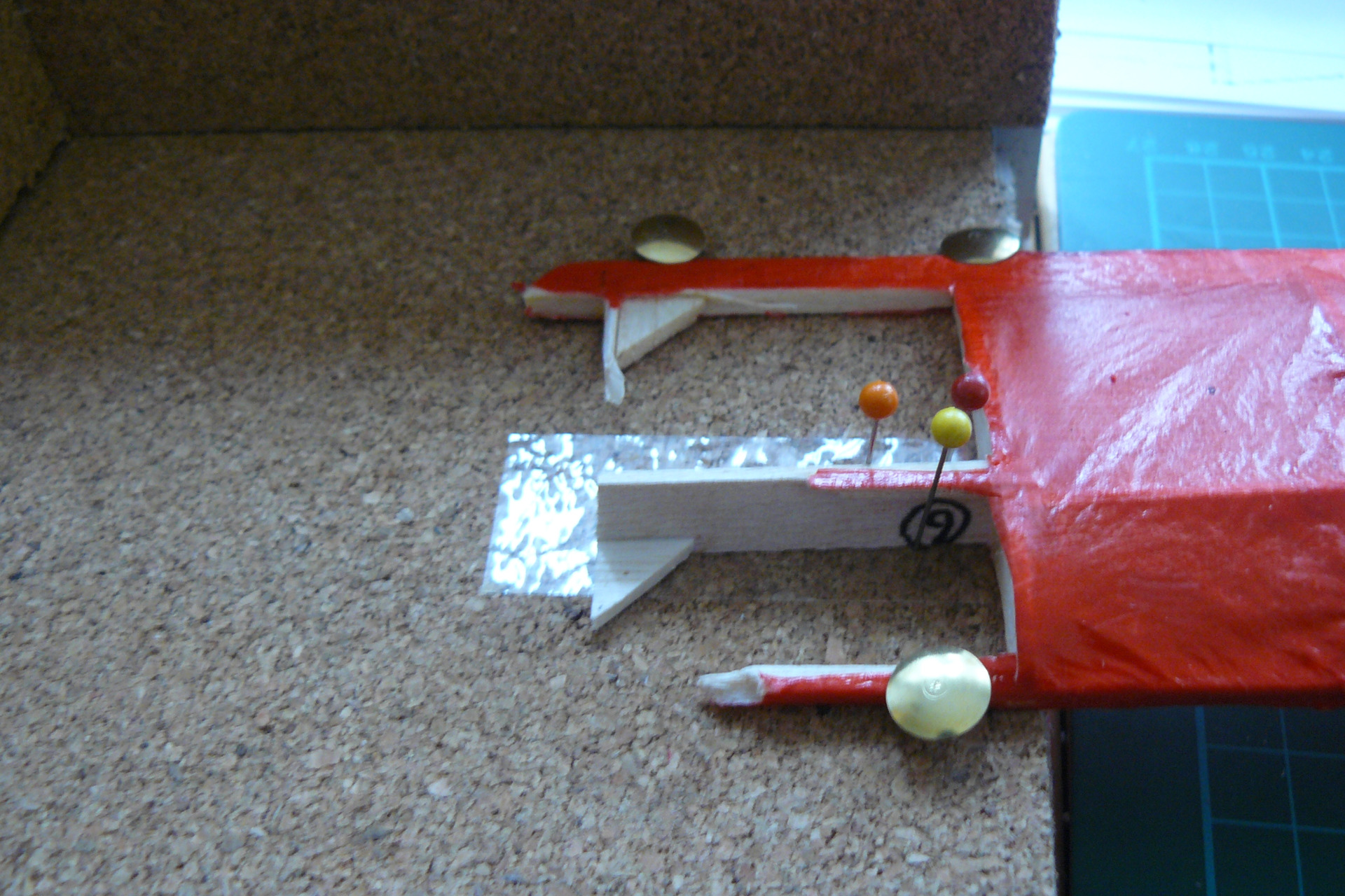

28 Sep 2024 17:43 - 28 Sep 2024 17:44 #28 by Magpie
I am very prone to bashing into things, I regularly knock over the jar of water I soak the brushes in.
I have been doping the wings again today by doing both the undersides first & leaving them balanced upside down on the centre section then doing each side separately, pinning them down with drawing pins until they are dry.
If I left 2 days between applications it would take forever (well 8 days).
The wings are so lightly built they change so easily. Maybe the dope soaks into the woodwork, they are in their final pinning now till the morning. The tips of the unpinned sides are resting on two 13mm blocks (= 26mm) with a sanding block on top to hold them down.
Last edit: 28 Sep 2024 17:44 by Magpie.
29 Sep 2024 00:09 - 29 Sep 2024 00:10 #29 by Quorneng
Replied by Quorneng on topic SE5 KK-OZ1320
For my super light weights working on the principle that the ribs themselves wouldn't bend I used to dope both top and bottom surfaces but leaving the very edge of the LE and TE un doped. Then left it to dry with the entire LE and TE supported on full length wood blocks with the LE and TE pinned or weighted down. With care the edges could be doped later once the doped tissue was fully dry.I also used a damp tissue method if using water proof (model span) tissue. The tissue would be just laid on the surface of the water and quickly removed. It was then glued onto the structure using a fine perimeter bead of PVA glue. The object was that the damp tissue did not shrink tight until the PVA had stuck the tissue to the balsa.
The rear part of the wings of my sub 250g all foam EDF Canberra were done like that.
 No dope because of the foam but when painted with light coats of emulsion it was wrinkle free and water proof.
