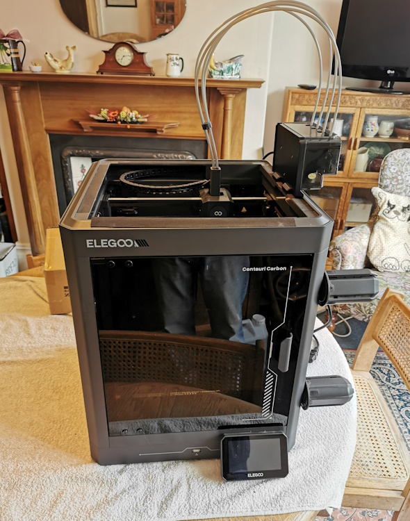

My Centuri Carbon printer needs a lid to keep the dust out.
Could have bought a version of the multicolour upgrade that included a big injection moulded lid but it raised the price 30%!
There are various self printed versions of a lid but they have to be in multiple parts that require a total printing time of over 24 hours and use up a complete spool of filament.
In addition if you want to be able to see inside they require acrylic panels to be added.

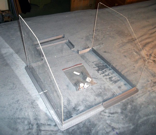

My model plane philosophy is to not print a complete subject but build using sheet (Depron in my case) and use printing to make small complex bits. Why not apply the same for the printer lid? Acrylic sheet panels cut to the required shape along with complex printed brackets and small nylon bolts and nuts to hold all the bits of sheet together. Lots of hours designing the brackets and cutting the acrylic (I have the time!) but only 25% of the printing time and use of filament.
Progress so far.
When complete it should simply drop into place in the same location as the original flat glass top panel.
Although my upgraded printer now has 4 spools which can be selected on command but so far I have not found how to insert a "change filament" command in FreeCad. I can select which one of the four filaments are to be used but only just prior to the actual "print" command on the printer. A true "multicolour" print is beyond my software capability at the moment.
