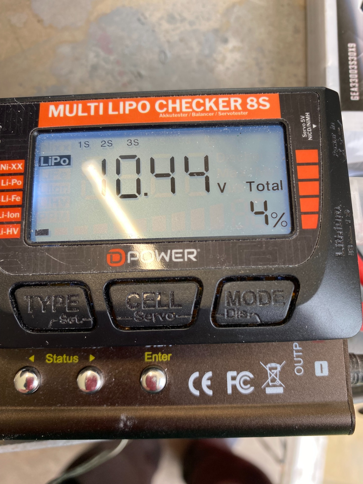

I have a new lipo charger that tells me the lipo is fully charged
And a new battery checker that reads the the same lipo is at 4%

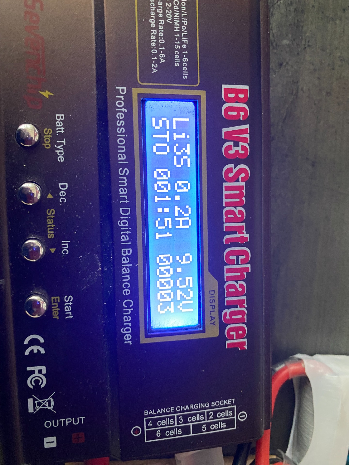

Yesterday 18:10 - Yesterday 18:19 #6 by THE BLACKBIRD
Replied by THE BLACKBIRD on topic Electrickery
Cannot find the instructions so iv been on YT and found 3 vids, one in tagalong 1 in Indian and the other silent
Its set up ok i think
And it works for 15-16 seconds and then cuts out saying it is full
The checker still says 4%
 [attachment=31580]IMG_2443.JPG[/attachment
And on my three 4s lipos it just say connection broken before even starting
Photos in the wrong order
You dont get this with a DLE

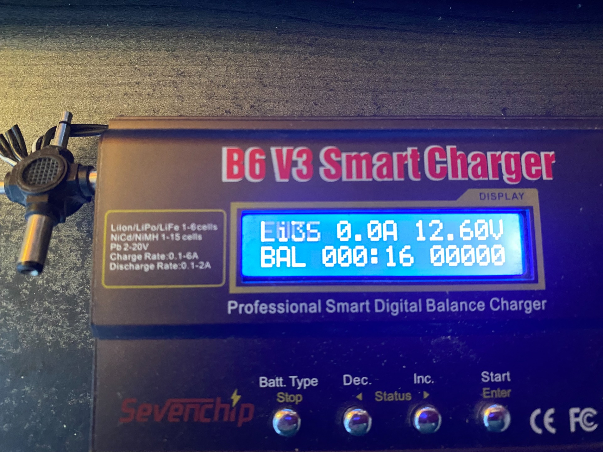

Yesterday 22:33 - Yesterday 22:36 #7 by SimonC
Replied by SimonC on topic Electrickery
I use very similar 4 button chargers and from your pictures I can't see anything wrong with the way you have it connected and the screen info looks correct.
I can only think of two scenarios.
If when using another charger the cells take a reasonable charge then that B6V3 is at fault.
If that LiPo does not charge on any charger than the one (or both) cells are kaput!
Just point
On both my 4 button (they have exactly the same button headings) when the charger is actually charging if you press the RH "setting" button the display changes to show the individual cell voltages during the charge via the balance plug.
The charging dplay
The display after pressing the RH Status button
Pressing the button cycles between the two displays
If you charger does the same it shows what the charger thinks the cell voltages are rather than the battery total.
On my chargers I cannot find any parameter I can set that would cause the charger to stop at 10.44V when on a 3s LiPo setting.
I hope this helps

Today 02:24 #8 by THE BLACKBIRD
Yes my charger is the same when pressing that button
