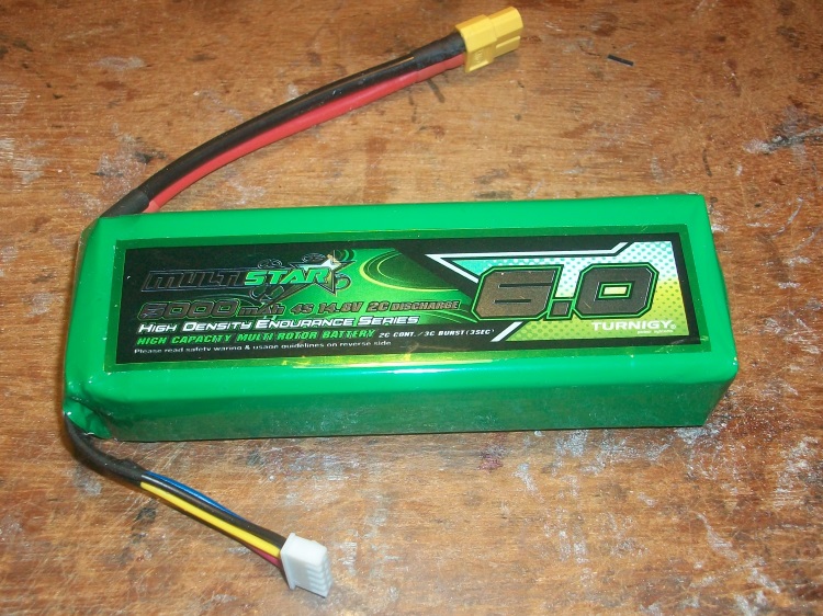

The 6Ah 4S 2C 'Multi star' battery.
It weighs 358 g
A 2S version should weigh 179g maybe a bit less as it will have a much lighter wires and a tiny JST battery connector rather than an XT60.
My 5Ah 2S 15C battery weighs 209 g
So the Multi Star is 15% lighter and has 20% more capacity! :P
We shall see. ;)

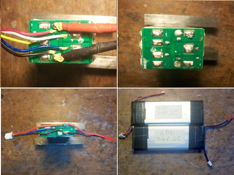

With a bit of "Don't do this at home" the 6Ah 4S has changed into two 6Ah 2S.
The 4S battery was supposed to weigh 364 g but it was actually 372!
So a 'half' would nominally weigh 186 g.
As I used much thinner wires and a smaller connector my conversions came out at 174 g each.
That's 17% lighter than the 5000 mAh I have used up to now and that showed the Endurance II could fly using just 1 A.
The lighter battery should give a bit more lea way so 6 hours duration is on the cards. :woohoo:
