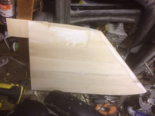

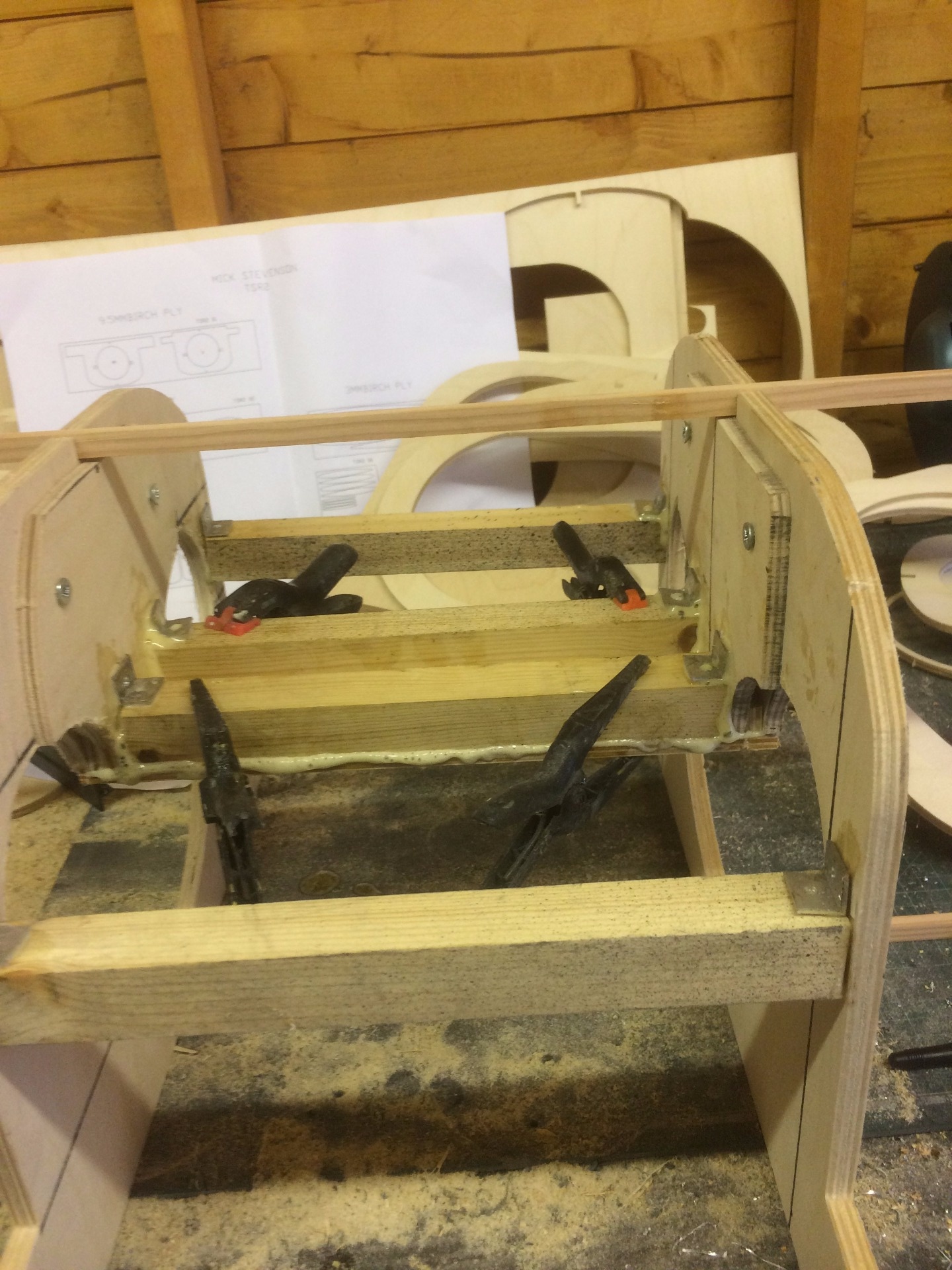

Balsa is all 1/8 thick
All ply is 10mm birch
Thanks: Klipkopwildlife, Quorneng, old fart, crash happy

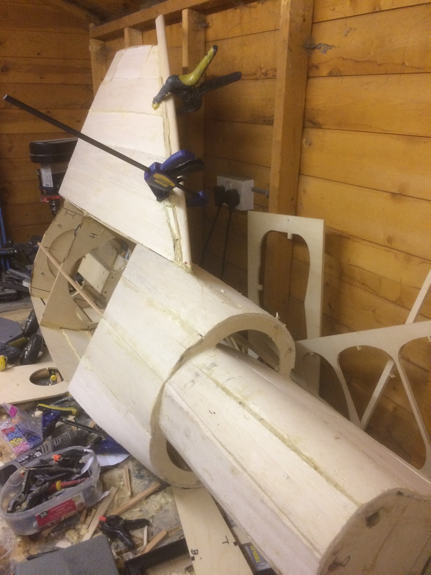

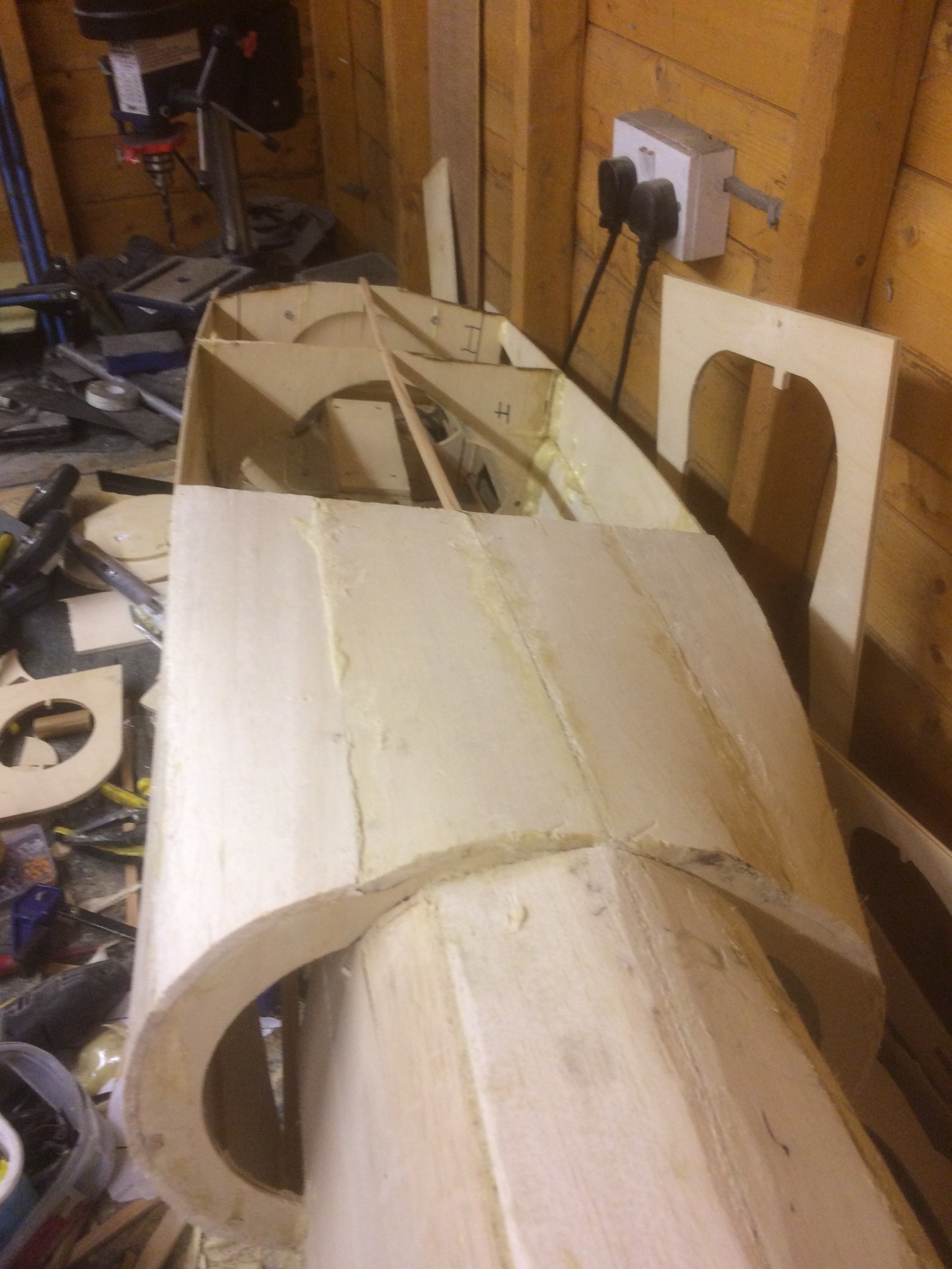

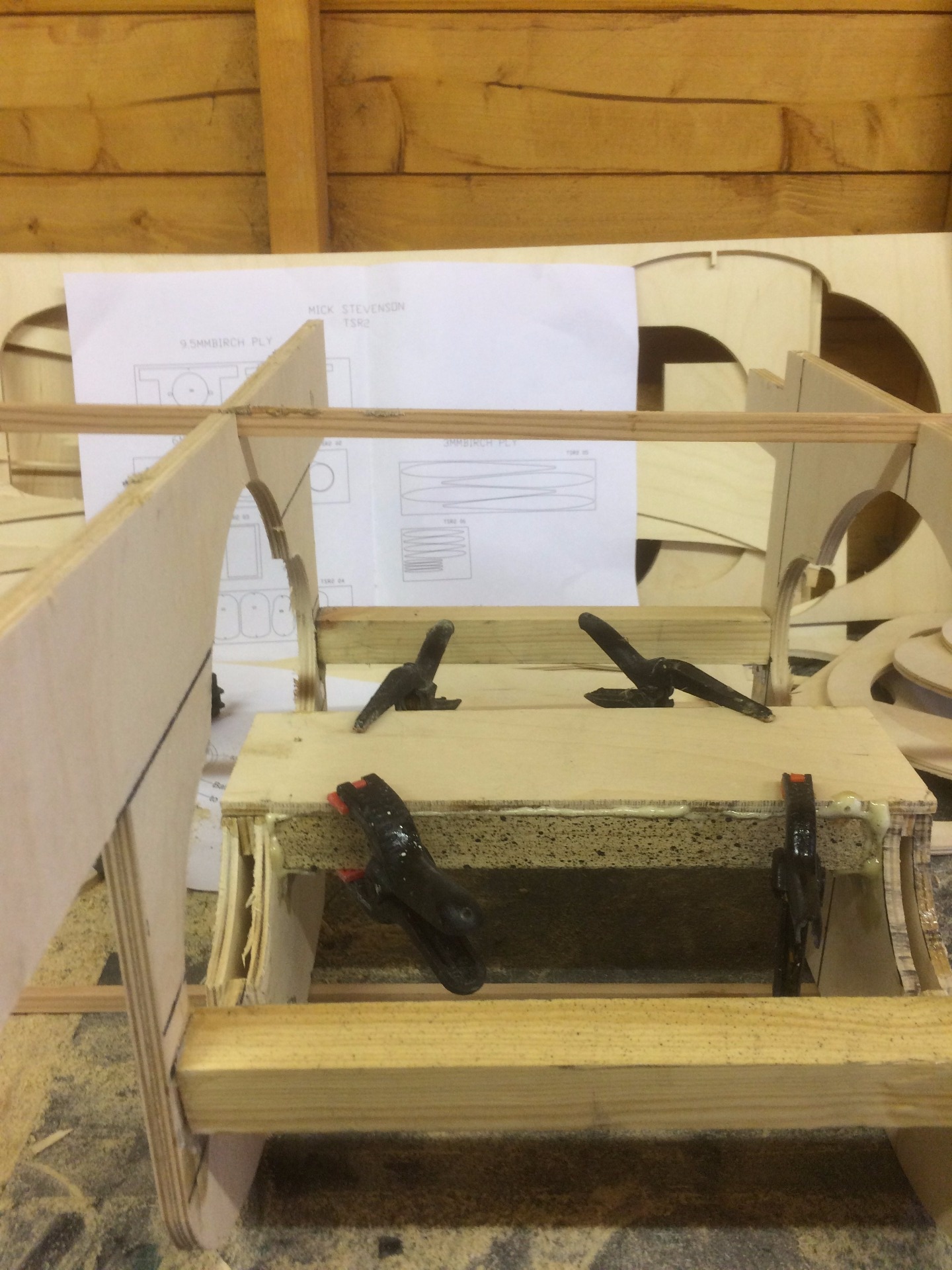

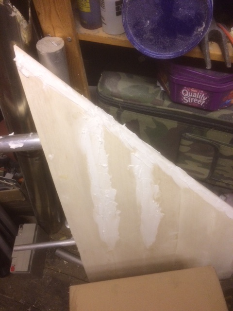

As you can see, haven`t done much but the model is the largest iv`e done and it needs qualification after each stage
Thanks: Quorneng, crash happy

Hi Mr Bond. I would be interested to know what glue you are using ? I can't really see much from the photos.
It is quite large isn't it ! :)

Hi Crazy
I use a mixture of glues
for not seen area i use gorilla glue
it`s waterproof, it expands by 4x
strong and takes 2 hours to set
super glue with kicker
for quick and easy gluing
very quick and little used
hysol
sets like rock
takes 12 hours to set
epoxy 50/50 (slec)
30 minutes - 5 mins to set
so the glue i use the most is gorilla glue but i do use some glues for different reasons and places
Thanks: Eric, Klipkopwildlife, Quorneng, crash happy
