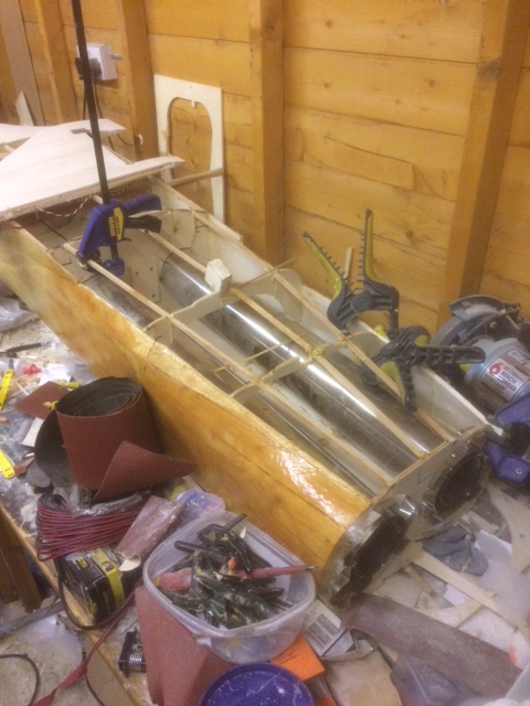

18 Nov 2019 10:17 #19 by bond007mas
Replied by bond007mas on topic TSR2
As you can see, the underside is laminated. Now i intend to fit the fin and aileron mounts, after they are done i can do electronics then seal the engine bay.
When fitting the fin i will use carbon fibre rods and balsa blocks, the fin will be fixed permanently so i have to get it right.
The way i fix it is i get the wing mounts either side and measure to the table, adjust and fix, that`s the fuz fixed, i then fix fin to roof of shed with plum bob and glue

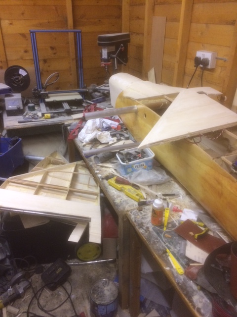

18 Nov 2019 11:40 #21 by bond007mas
I am doing something totally different on this build.
On all working surfaces the servo directly moves the surface. You have to use a very powerful servo. I've got 50kg torque Servox .
No horns or rods but all clean surfaces, just like the real thing
pics to follow
18 Nov 2019 12:16 #22 by Eric
Replied by Eric on topic TSR2
If roll control on the TSR is the same as the Tornado - done by the tail feathers, not by surfaces on the main wing, they would be called elevons - a contraction of elevator and aileron.
Surfaces directly driven - no pushrods - the same method Quorneng uses on his ultra-lights.
You will need to have provision for fine trim adjustments, though! :)

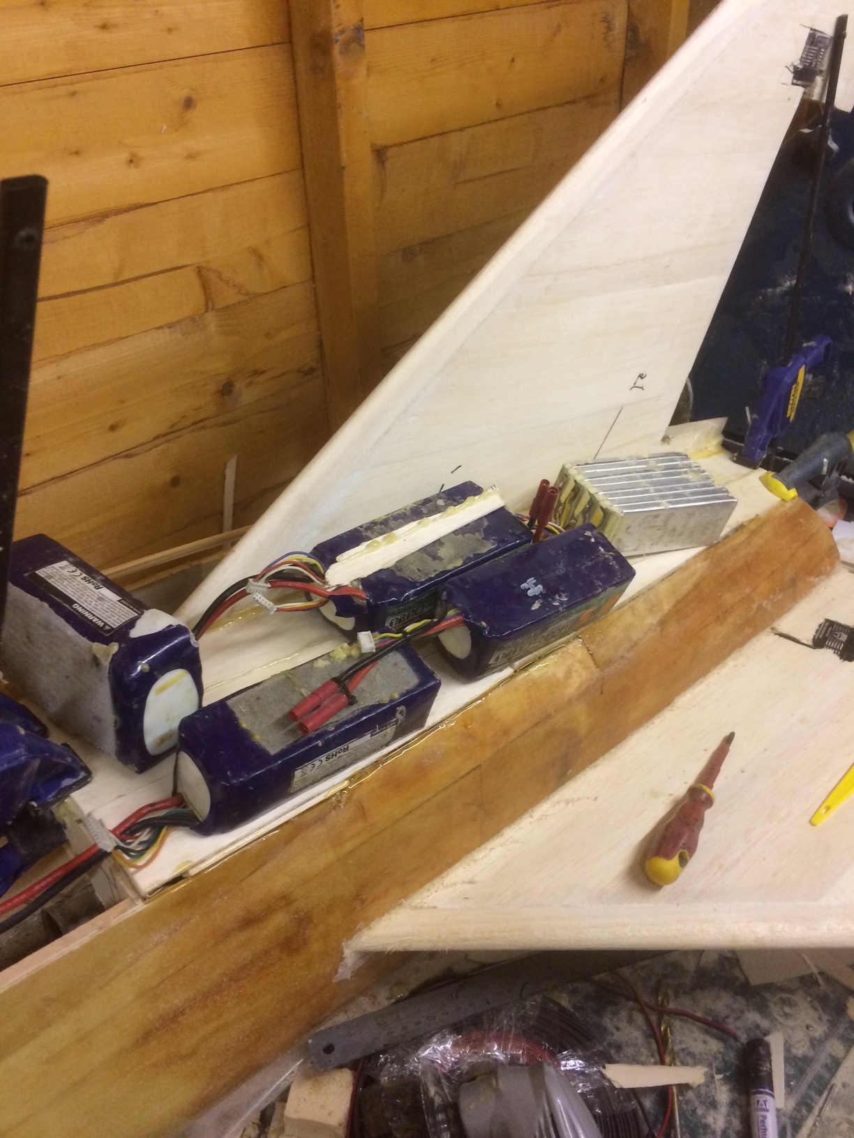

25 Nov 2019 16:22 #25 by Eric
Photo's duplicated.
And those lipo's look a bit puffy. Keep an eye on them!
  • bond007mas
25 Nov 2019 16:53 #26 by bond007mas
They have been like that for 12 years, but i will keep my eye on them Dad
25 Nov 2019 17:01 - 25 Nov 2019 17:12 #27 by Quorneng
Replied by Quorneng on topic TSR2
12 years. Wow!
There not puffy, they just got a bit 'portly' with age. :P
Last edit: 25 Nov 2019 17:12 by Quorneng.
