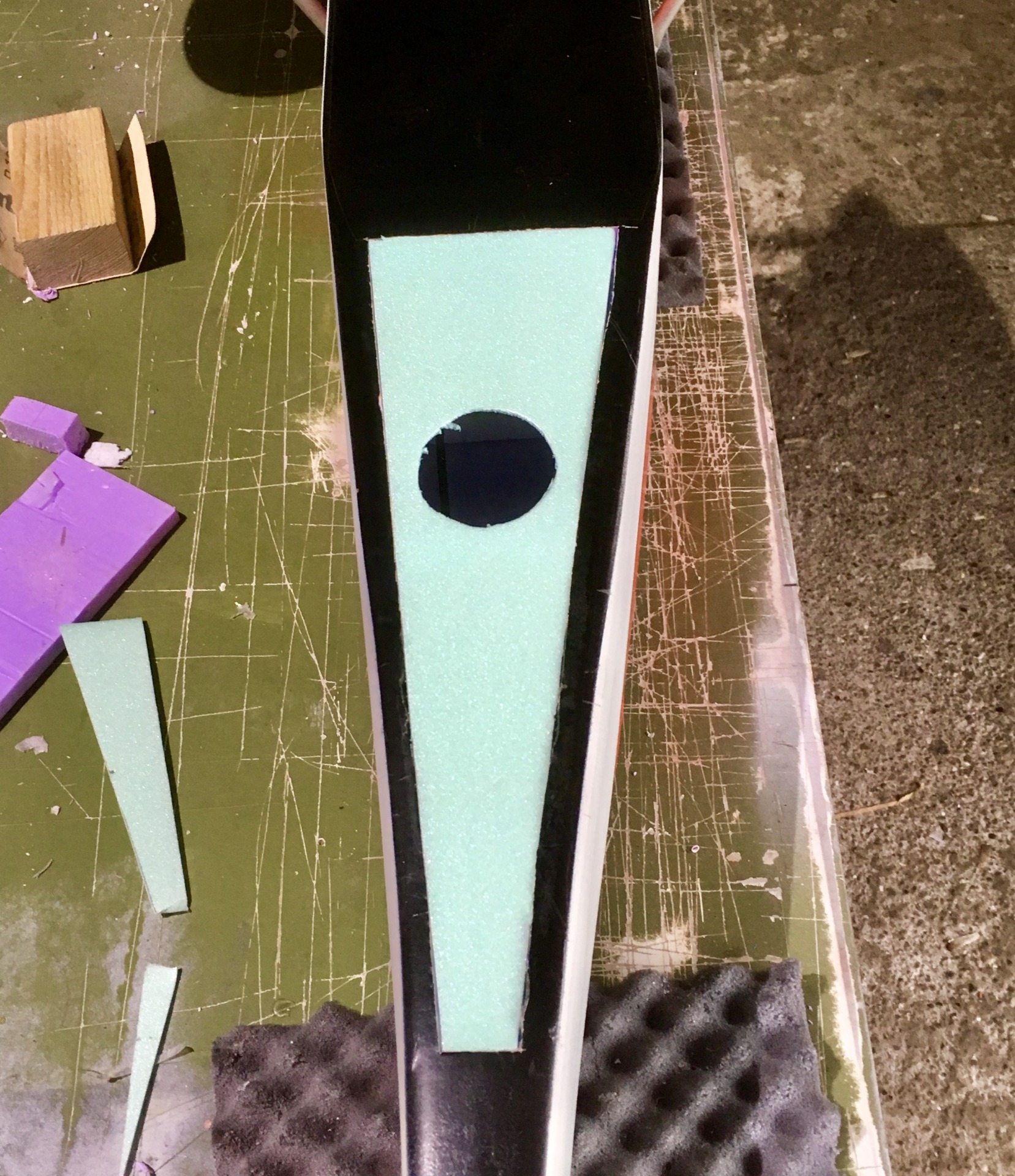

Crash, it looks like you've got about a 5:1 tail moment advantage, this means you only need to alter the tail weight by about 30gm. Any other solution will only add weight. Can I suggest cutting serious lightening hole in the tail feathers, leave maybe 10% all round, then cover with Solar film or some such. Do the moving surfaces as well, then you can attack the fuselage sides, leaving maybe 20% all round. On the subject of holes, round is OK, rectangular is better with rounded corners and don't elongate beyond 60/40, length to width.
01 Jan 2020 10:15 #65 by crash happy
Replied by crash happy on topic The Jekyll or Hyde

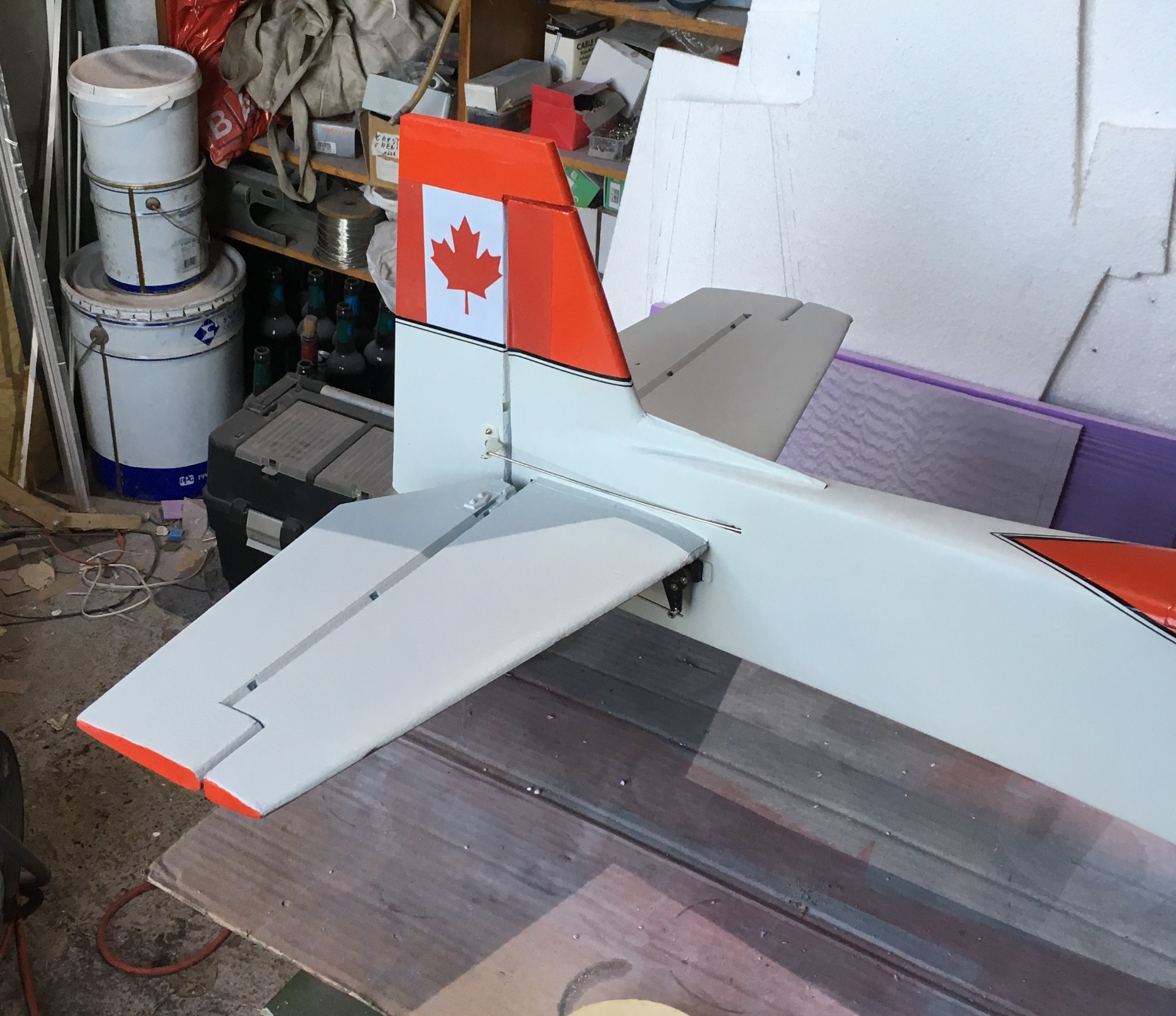

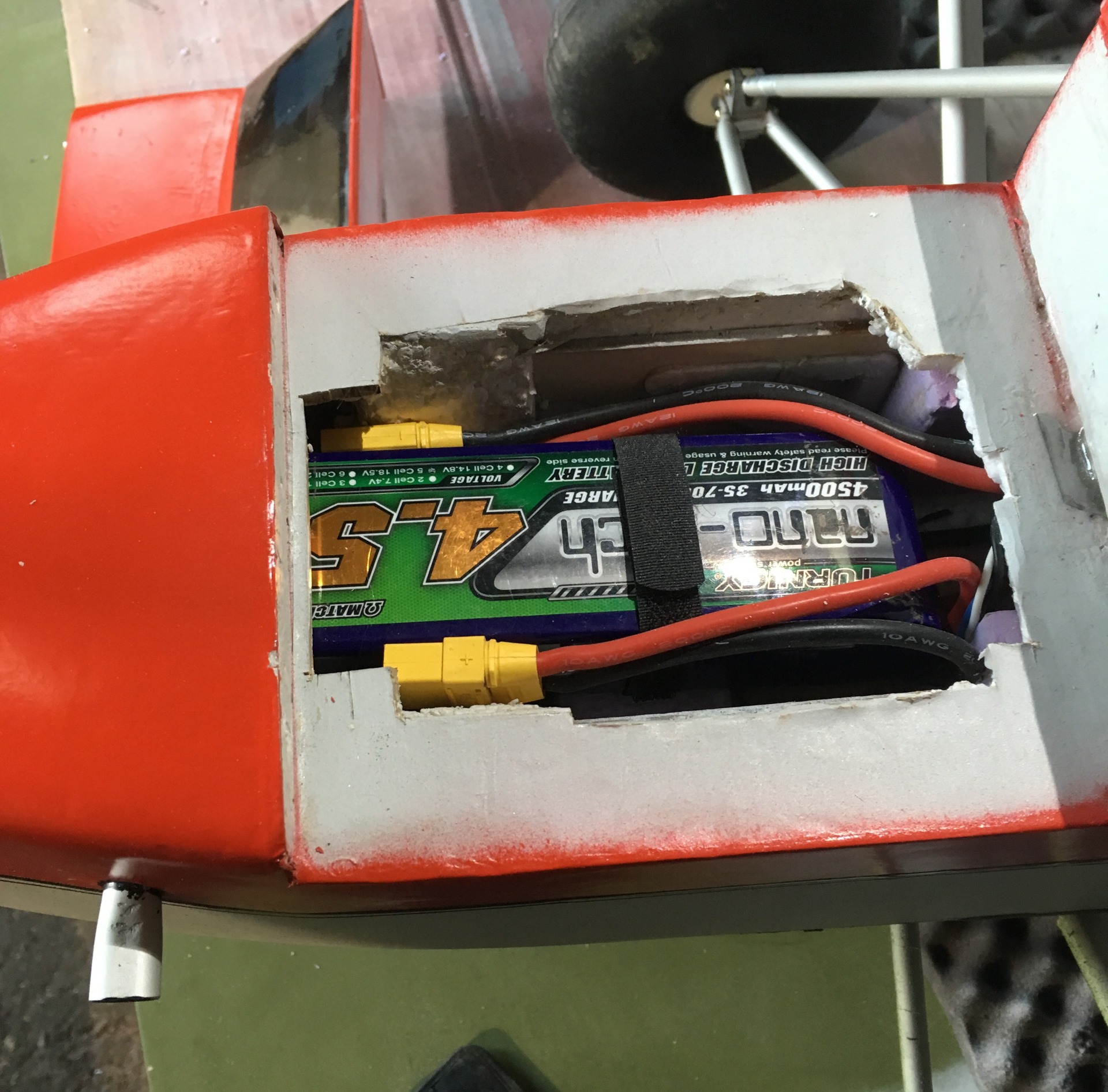

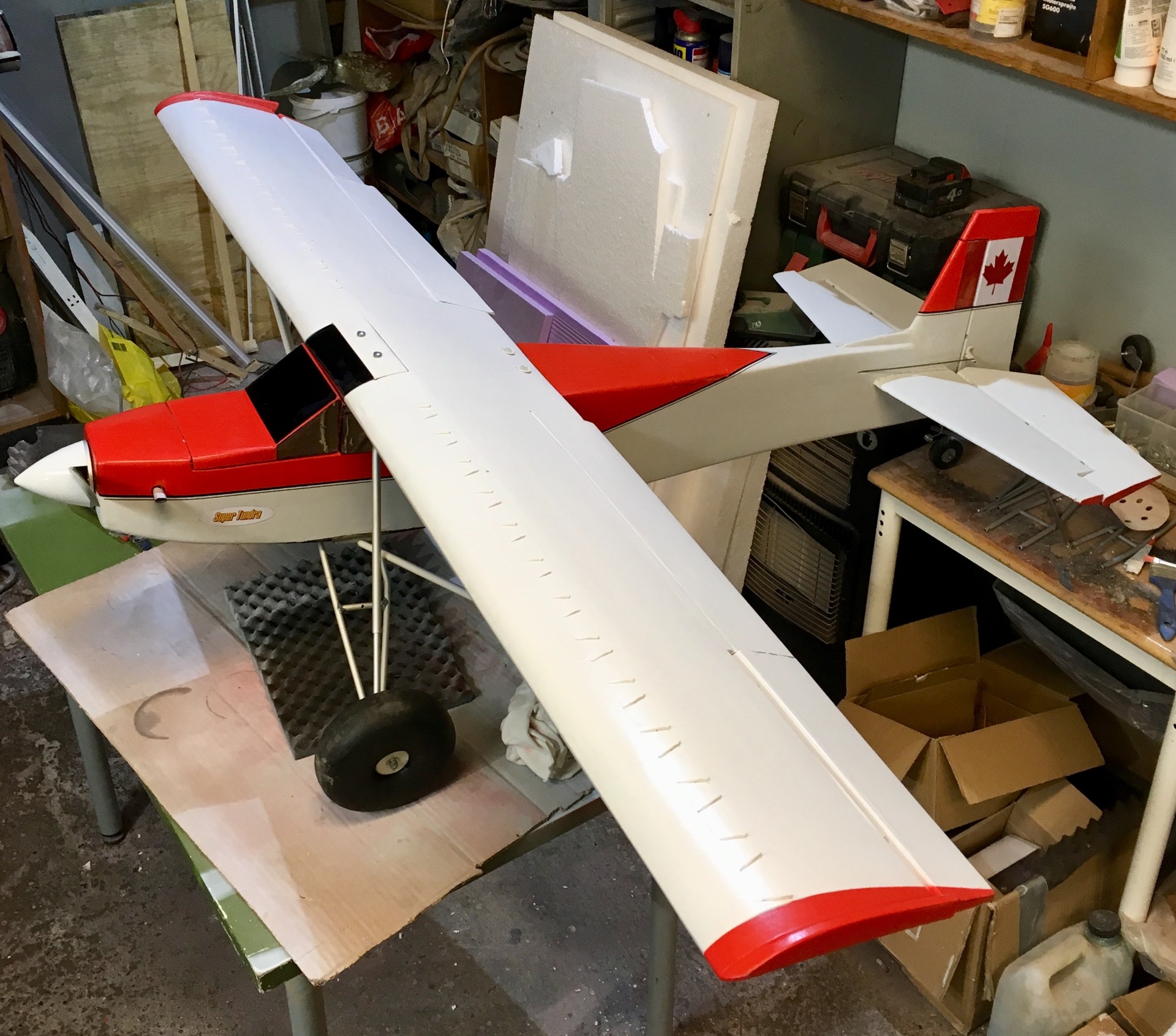

Klippy, first may I wish you & all a happy new year. Thank you for the thought, unfortunately it has come to late as I have already cut the rudder & vertical stab down in size. The whole tail section was salvaged from the Edge, which being designed for 3D had huge surfaces.My original intention was for a STOL & the rational was that I would need large surfaces at slow speeds to maintain control. Due to my inexperience ( or not being that bright) the high wing loading means this is no longer an option, ergo, no need for a huge thick rudder sticking way out the back. This combined with moving the landing gear 15 mm forward & gaining 5 mm in the battery compartment means I now have a CG of 28% with 30 grams at the back of the motor mount. I did cut three air holes in the rear underside of the fuz instead of one. The end result although not so aesthetically pleasing is hopefully more functional ! :unsure: Pictures to follow.
01 Jan 2020 15:33 #66 by crash happy
A few pictures of the modifications. From this; To this; Shame I didn't see Klippy's post first, but it's done now. The battery can't go any further forward than that. I have used Paul's idea & added Pilatus style dummy exhausts. The way it's going it will end up just as ugly too ! :S

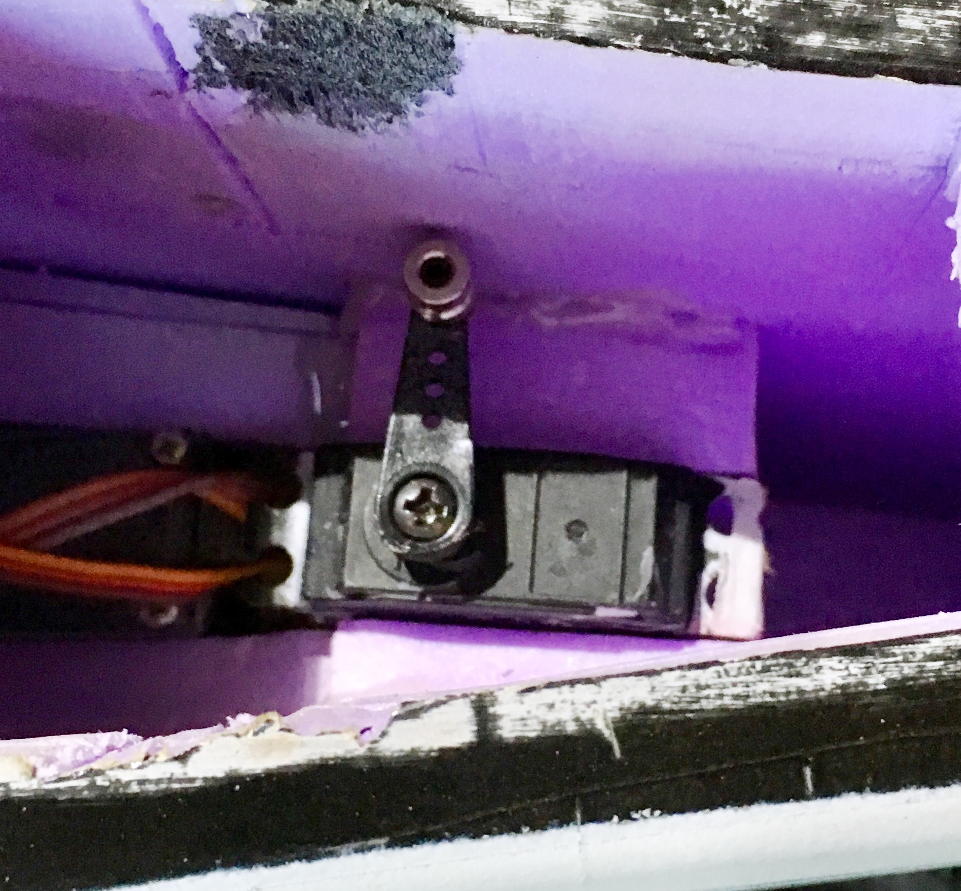

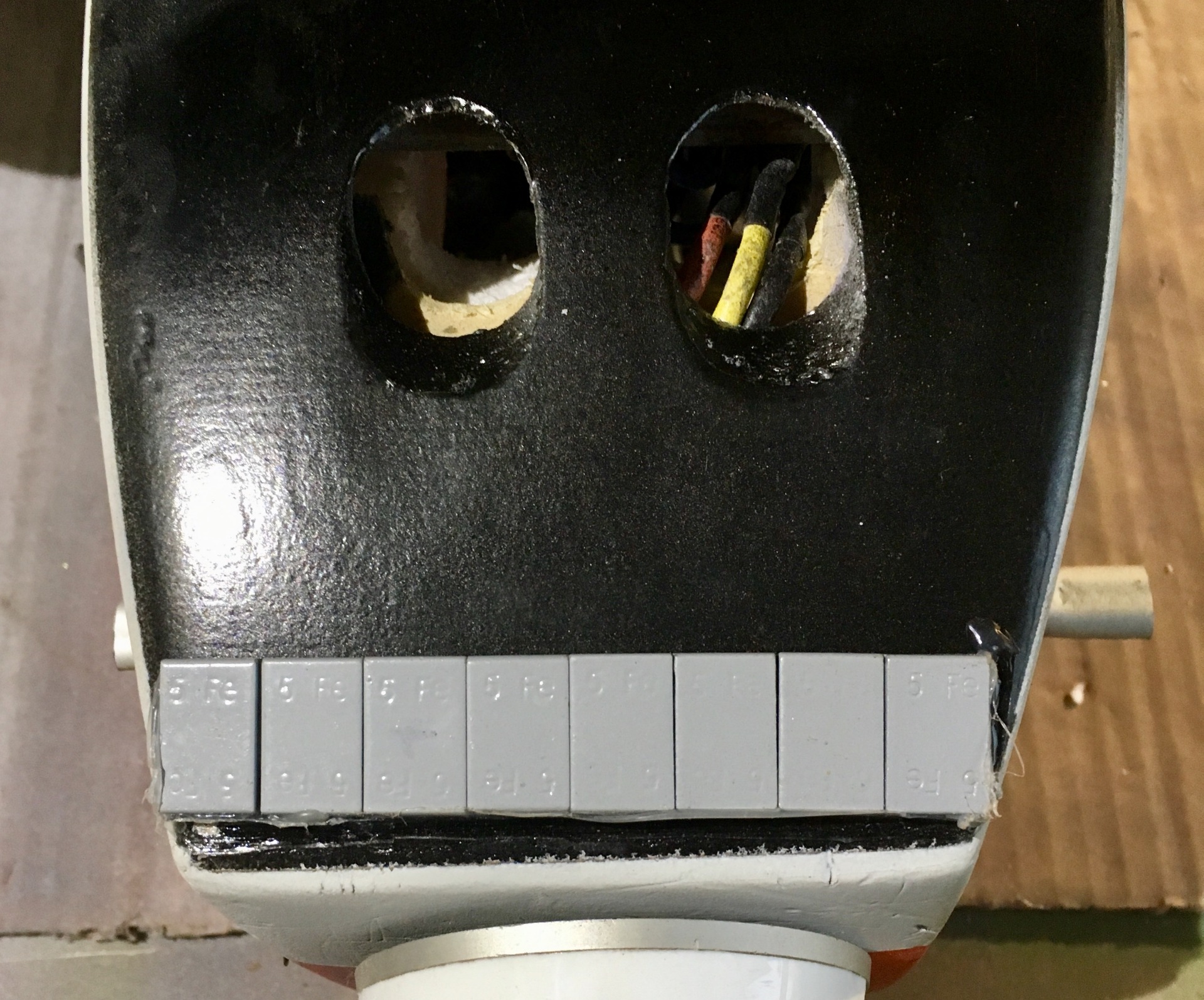

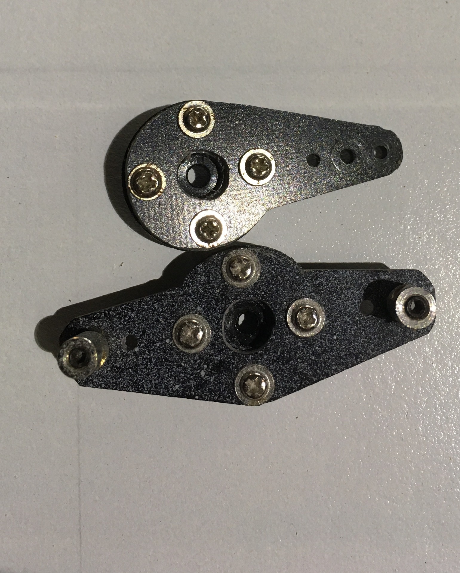

Alterations are slowly progressing. The elevator servo has been moved forward by 300 mm & mounted internally under the rudder servo, as suggested by Klippy. Access for adjustment through a cut-out in the bottom of the fuz, once set this will just be taped over. The rudder was originally push - pull with dual servo rods, this is now reduced to one as the rudder is considerably smaller. Servo arms have been changed for lighter nylon ones. The two 60 mm steel screws attaching the back of the wing to the fuz have been changed for nylon. I would have changed the ones at the front, but can't source any long enough. Small details but when added together they have made a difference. 30 grams behind the motor mount has been removed & 40 grams added at the bottom of the nose. The result is, slightly nose heavy with the CG at 28%. I am hoping this will be fine for the test flights & depending on how it behaves I can remove 5 gram segments as necessary. Last job ( when my daughter has borrowed some more tooth picks from work) is to extend the VG's to full span. Then I think it's ready to soar gracefully into the air, or not, as the case may be !:woohoo:

All the mod's are now completed. I managed to source some stronger springs for the landing gear. The struts have been enlarged from 6mm internal & 8mm external to 8mm & 10mm respectively, with the springs internal. Quite a lot of time was spent getting the optimum ground clearance, travel & compression correct. It was worth the time & effort, I'm very happy with final result. The vortex generators have been extended full span of the wing. Lemon Stab Plus RX has been set up, calibrated & checked three times ! All I need now is some really nice weather for the test flight. It could be a bit of a wait ! :whistle:

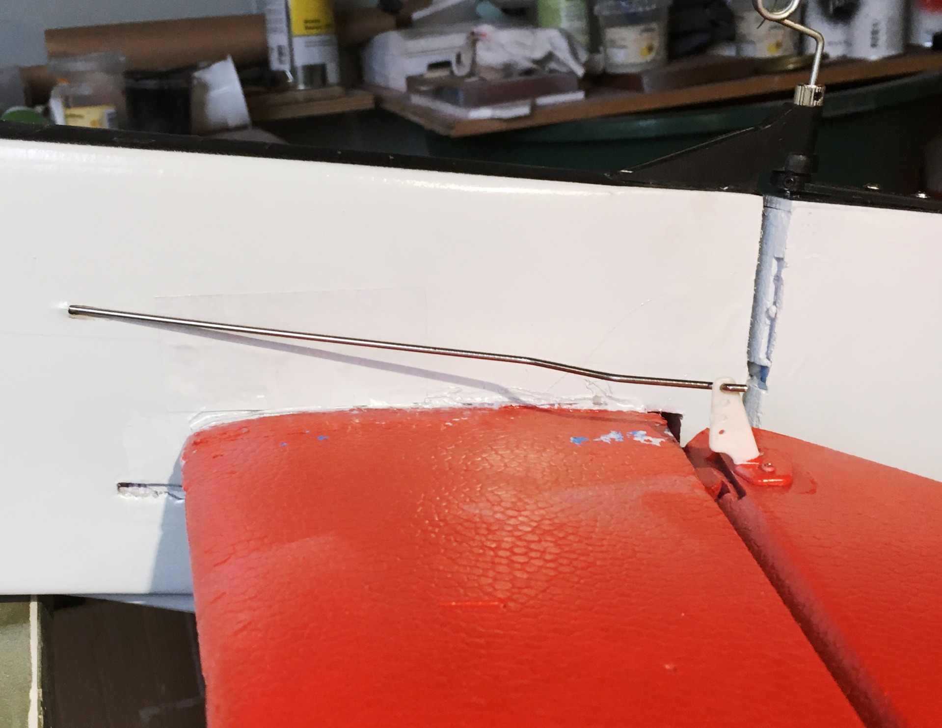

The first job was to move the rudder & aileron servos forward into the main body under the wing. They were originally about half way back in the fuselage 430 mm behind the CG. The reason being, at the time I had no tubes long enough for the control rods. Any longer & they were bending. Now I have a source of carbon fibre tube, this was the first issue to address.
With the addition of a 3 mm fillet to the underside of the fuselage, this has reduced the weight by 11 grams. A small saving I know, but from 430 mm behind the CG it should mean I can remove a lot more weight from the nose.
