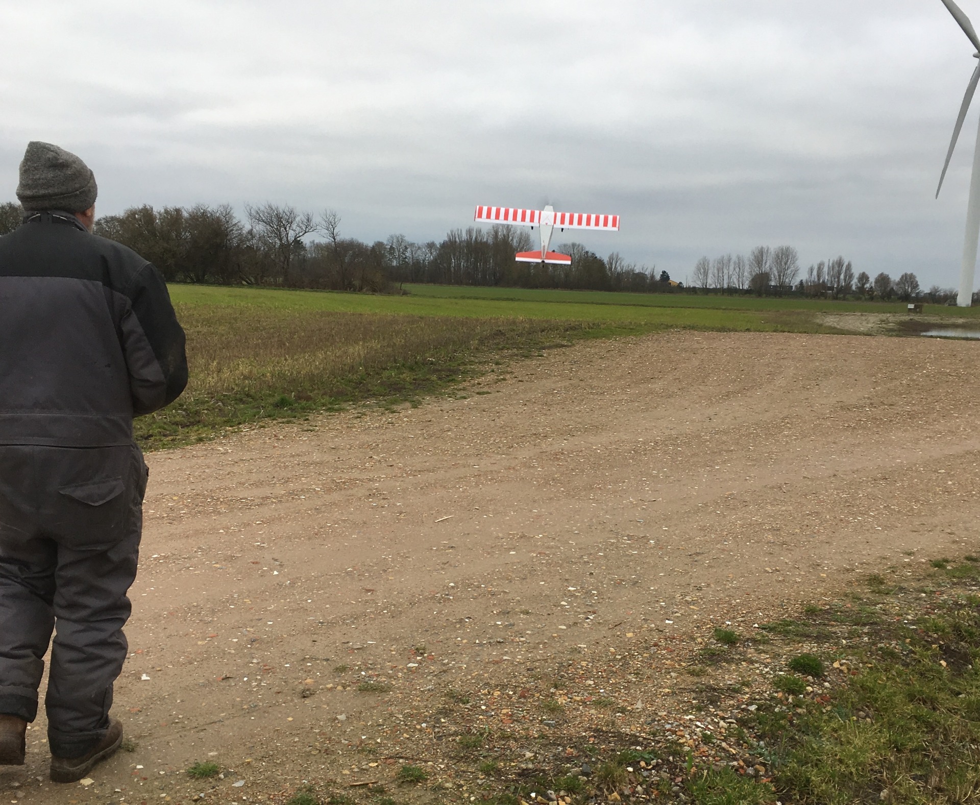

Perfect flying conditions here today, so decided to test fly the Tomcat before I finish the paintwork & detailing. The first flight was very successful. Nice gentle, if some what nervy take off. Got it rolling with about 50% up elevator & eased the throttle forward until it lifted off, no flaps. It flew surprisingly well ! I had to trim it quite a bit as it seemed to constantly want to turn left, but apart from that no major issues. Went through all the flight modes on the lemon stab ( gyro off, on & auto level) & it did exactly as stated on the tin. Power off glide ratio in auto level was amazing, it just kept floating & I didn't even use the flaps! In fact I'm starting to think they are unnecessary. Flight duration of 6 mins with a good, all be a bit short landing. I don't like walking too far ! :lol:

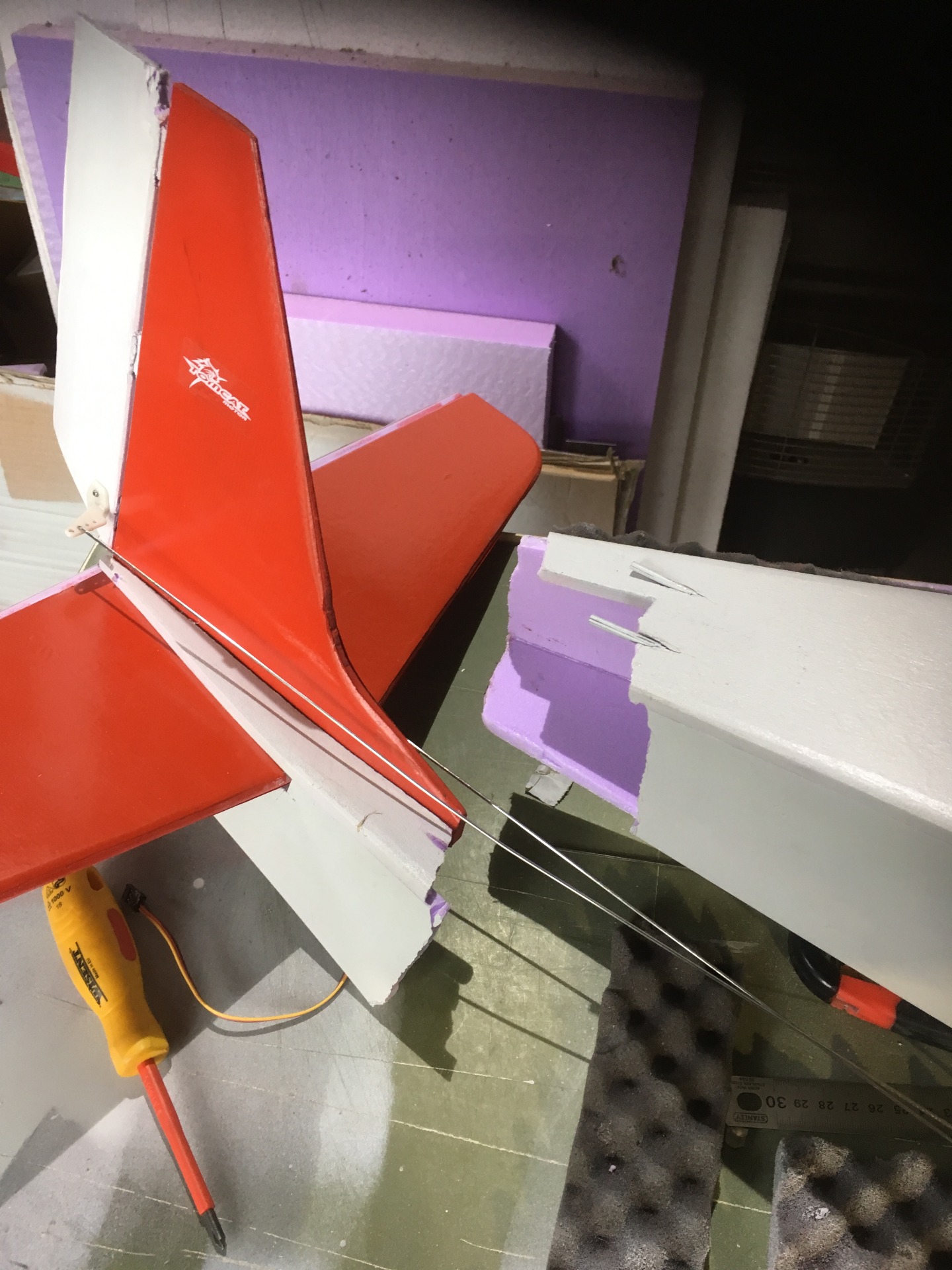

Second flight started well. Full throttle take off with just about full elevator & it went straight up in a very short distance! :woohoo: About 4 mins in I was switching between rates with the gyro in auto level & everything was fine at first. Then it became more & more erratic & only intermittently responding to my inputs. I just cut the throttle & managed somehow to get it down to about 10ft before it went down in fortunately, a very soggy field. Apart from the tail parting company(easy repair) & a lot of mud, the damage is very light. :)
The main problem now is, have I got a faulty receiver, or is it something to do with switching rates whilst in auto level ? :( By the way, it was well in range.
