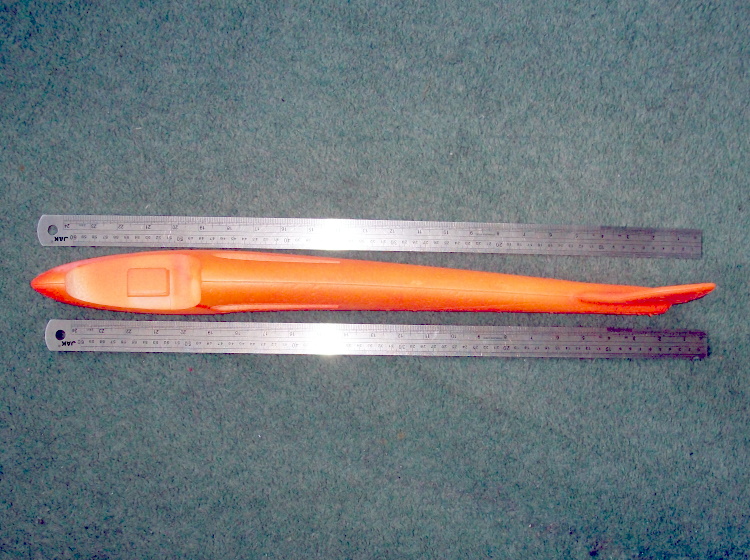

It is quite well moulded although of course nothing is particularly true and square!
A banana fuselage.:ohmy:
And the fin has a big kink in it too.
The wings are almost identical in shape.

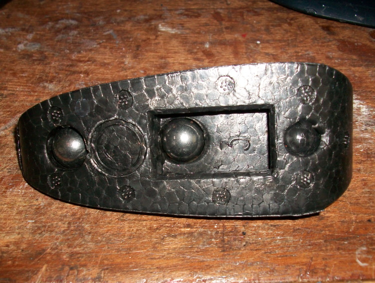

The canopy has two large steel balls in as ballast.
Together they weigh 32 g.

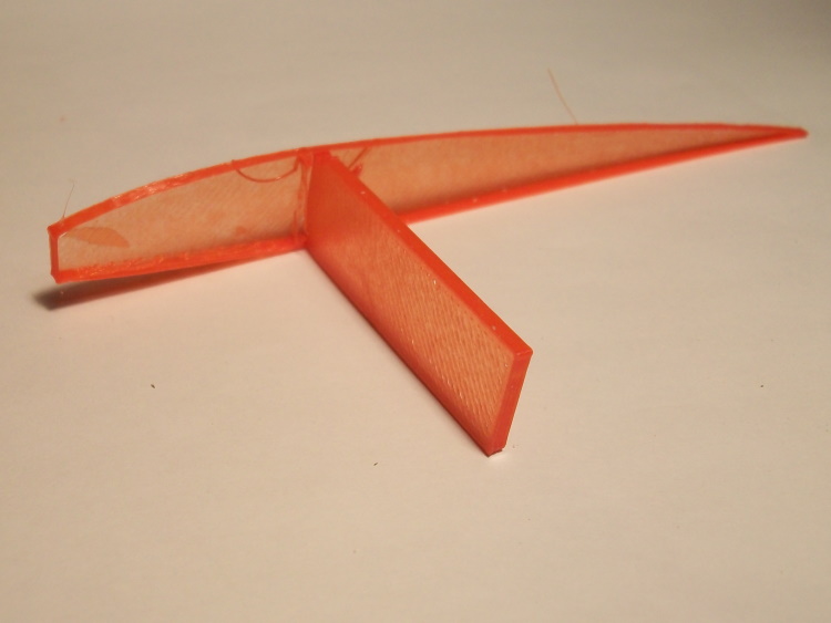

I estimate a 2mm Depron skin alone will be strong enough with no specific reinforcement so decided to print the ribs and the shear web between them.Two very light pieces just repeated as many times as required to achieve the span.
Together it weighs 0.75 g. There will be 9 units in the complete wing.
Although primarily a shear web when all are glued together the it will act as a significant 'spar' in its own right.
Each segment is glued in turn onto the Depron lower skin.

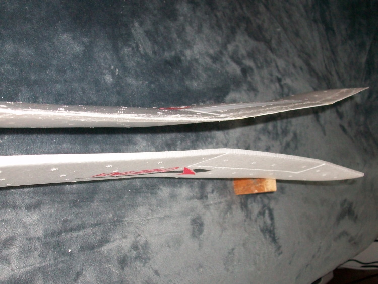

The RH wing glued to the centre section with the trailing edge extensions added and the aileron cut out.
The TE extensions made from 2 mm Depron top and bottom but sanded in their inner surfaces to give a fine trailing edge.
A 'before and after' trailing edge comparison.
Although the Cheetah TE at 4 mm is significantly thinner than the 6+ mm on the Lidl I still think a proper trailing edge improves the glide performance and the modest increase in wing area it creates can be helpful, particularly for the fixed fin and elevators.
