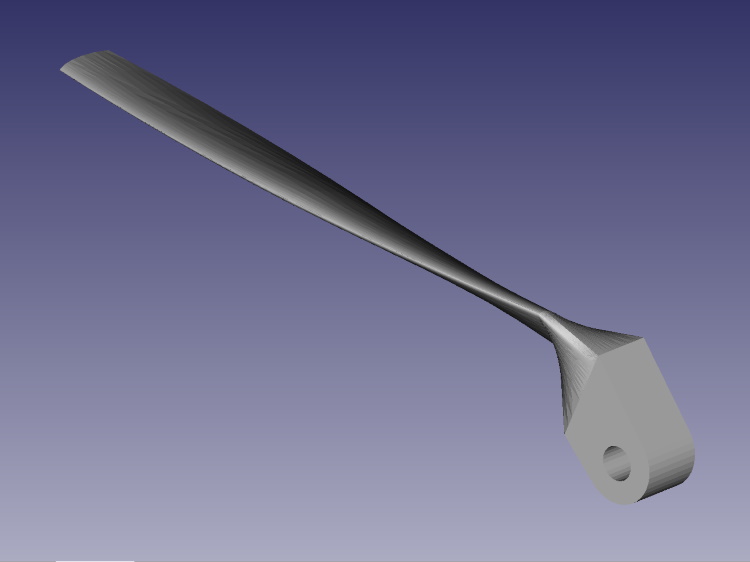

Looking through Thingyverse I found a STL file for a 6 x 3.5 folding prop blade that I might be able to use.
Not that I am in favour of printed prop blades but it is only a 50 W motor. ;)
The HK folding prop hub that the fuselage is sized for uses 4 mm thick roots whereas the STL file creates a 5 mm and the root shape is all wrong too however the blade itself looks reasonable so this morning I wondered what could be done.
The blade is printed with the root parallel to the bed so by scaling the Z axis by 80% and leaving X and Y unchanged the root ends up 4 mm thick. The pitch of the blade is also reduce so it is now roughly a 6 x 3.
You cannot edit an STL file so I was stuck with the wrong root shape but being simply too big it was nothing that a bit of work with some files can't overcome.
According to my jewellery scale it weighs 0.774 g making it 0.052 g lighter than the HK original.
Now whether I will be able make another exactly the same is another matter. :woohoo:

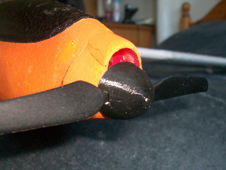

The complete printed folding prop.
6" proved to be a bit too much for the motor so 1/2" has been cut off each tip.
Works fine and actually folds closer down to the fuselage than with the HK blades however to be sure for the maiden at least I will use a fixed 5x3 as it generates a bit more thrust. ;)

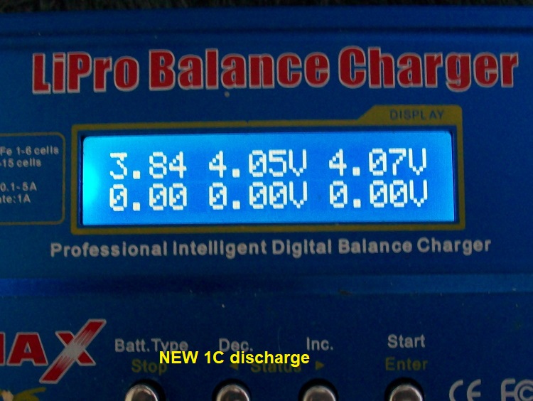

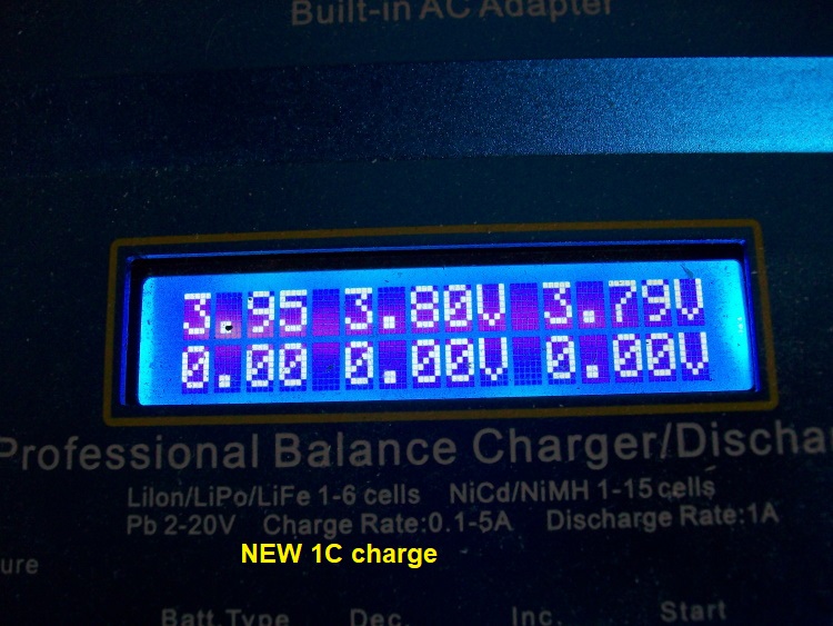

The only problem is the new battery is exactly the same! :woohoo:
1C charge.
1C discharge.
Just in case it was a charger issue I used my other B6 with exactly the same results.
So now the task is to see if it can be 'resurrected' with a full balance charge. I did not do this before as I wanted to put in a claim before doing anything to the battery.
We shall see but of course if it proves possible it will likely work on the first one as well. ;)

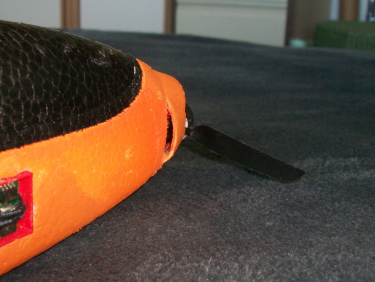

An intake above the spinner.
And 'cheek' outlets on either side.
More a chipmunk than a Cheetah? :P

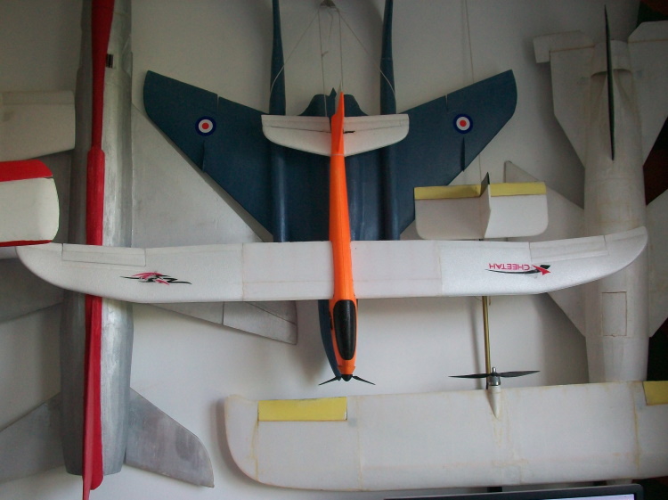

More to protect it from 'hanger rash' than anything else the Cheetah is now 'wall hanging'.
I am so short of space that it is having to share a hook with the Sea Vixen. :P
23 Apr 2020 11:58 #66 by paul d
Replied by paul d on topic Cheetah
My fleet hang as well.

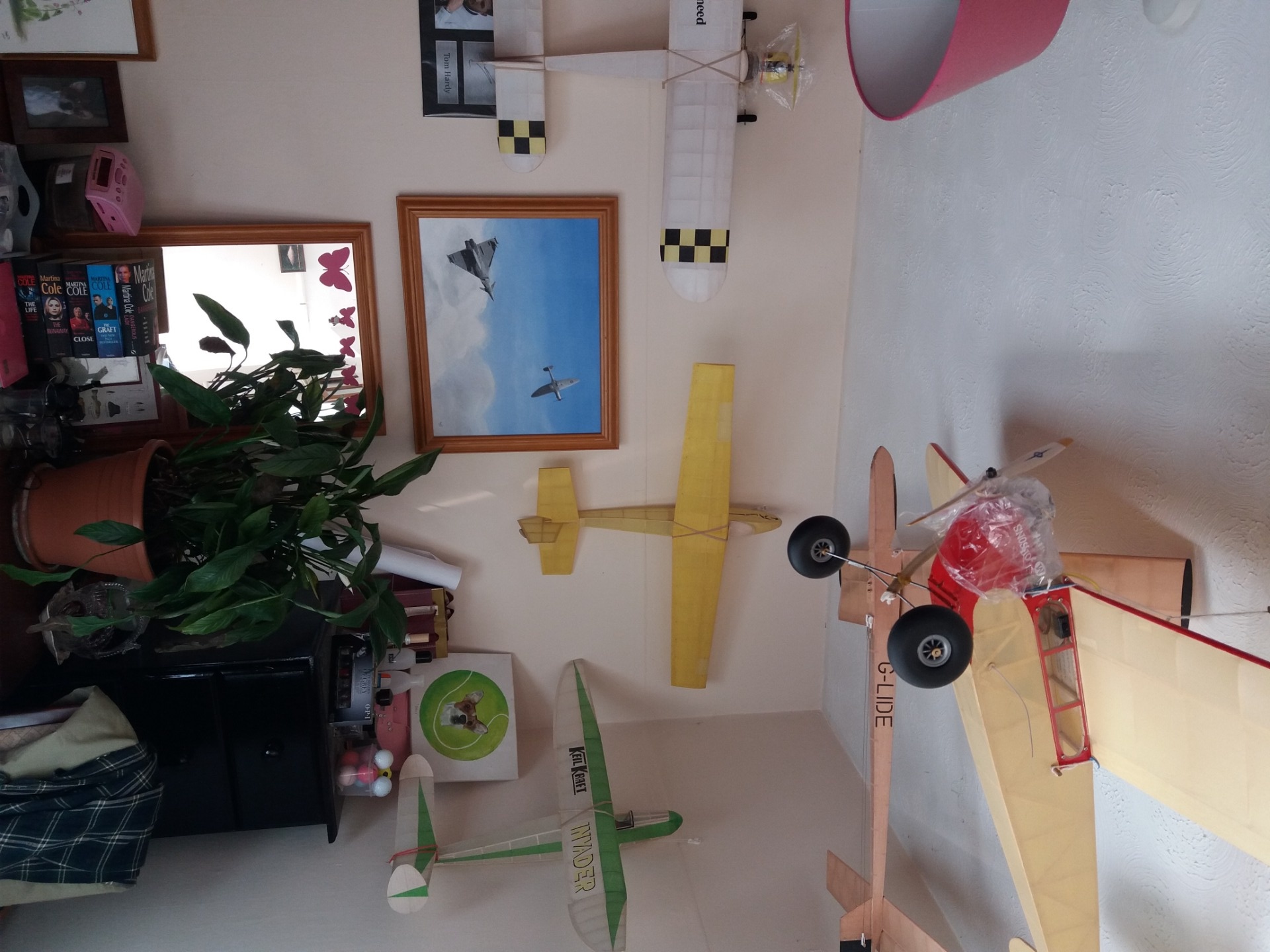

23 Apr 2020 11:59 #67 by paul d
no idea why that picture is 90 degrees out but there you go!
24 Apr 2020 09:07 #68 by Flytilbroke
Replied by Flytilbroke on topic Cheetah
Ok Paul, you got me :whistle: I thought you were doing it all from lying down :P
