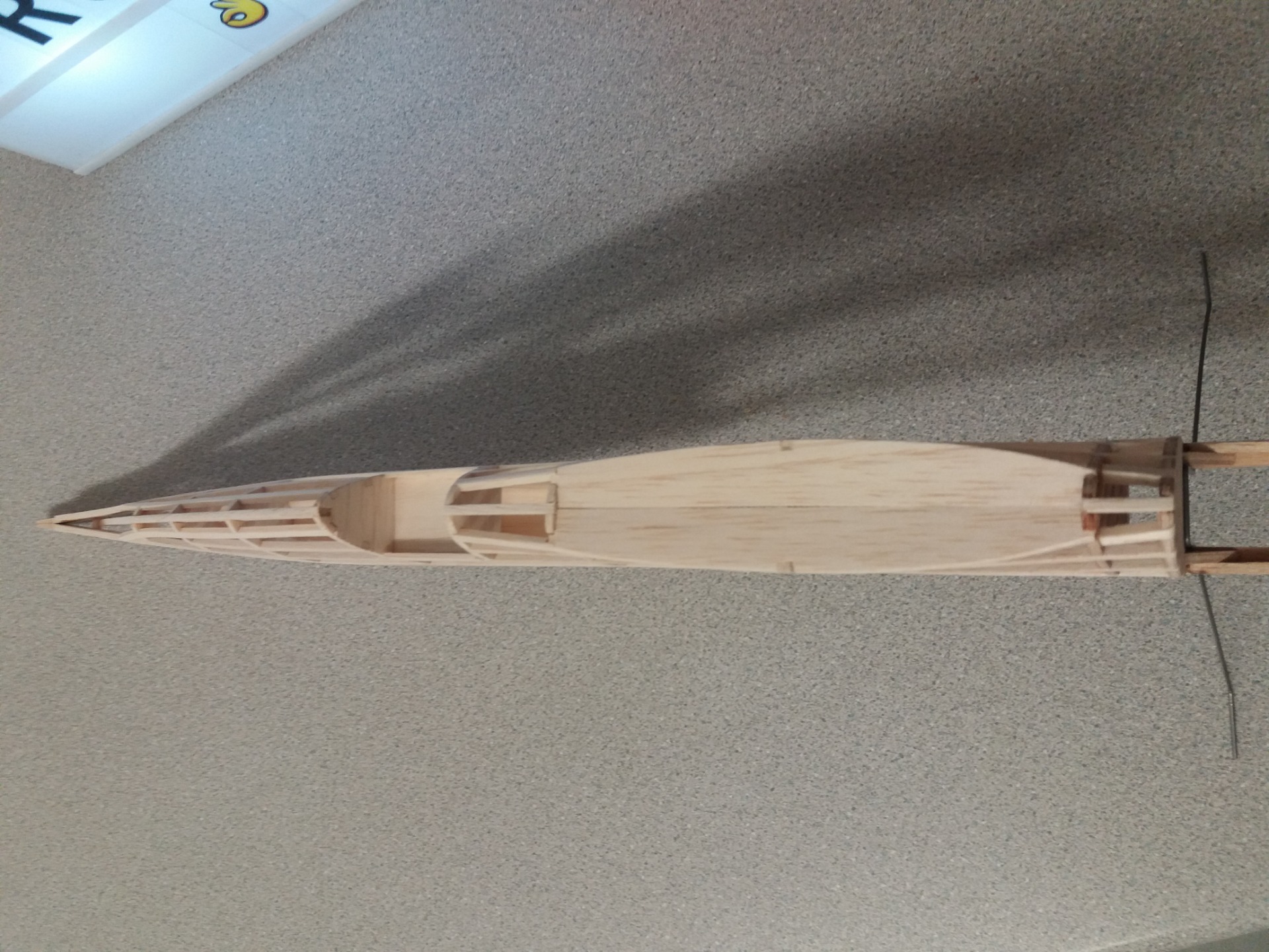

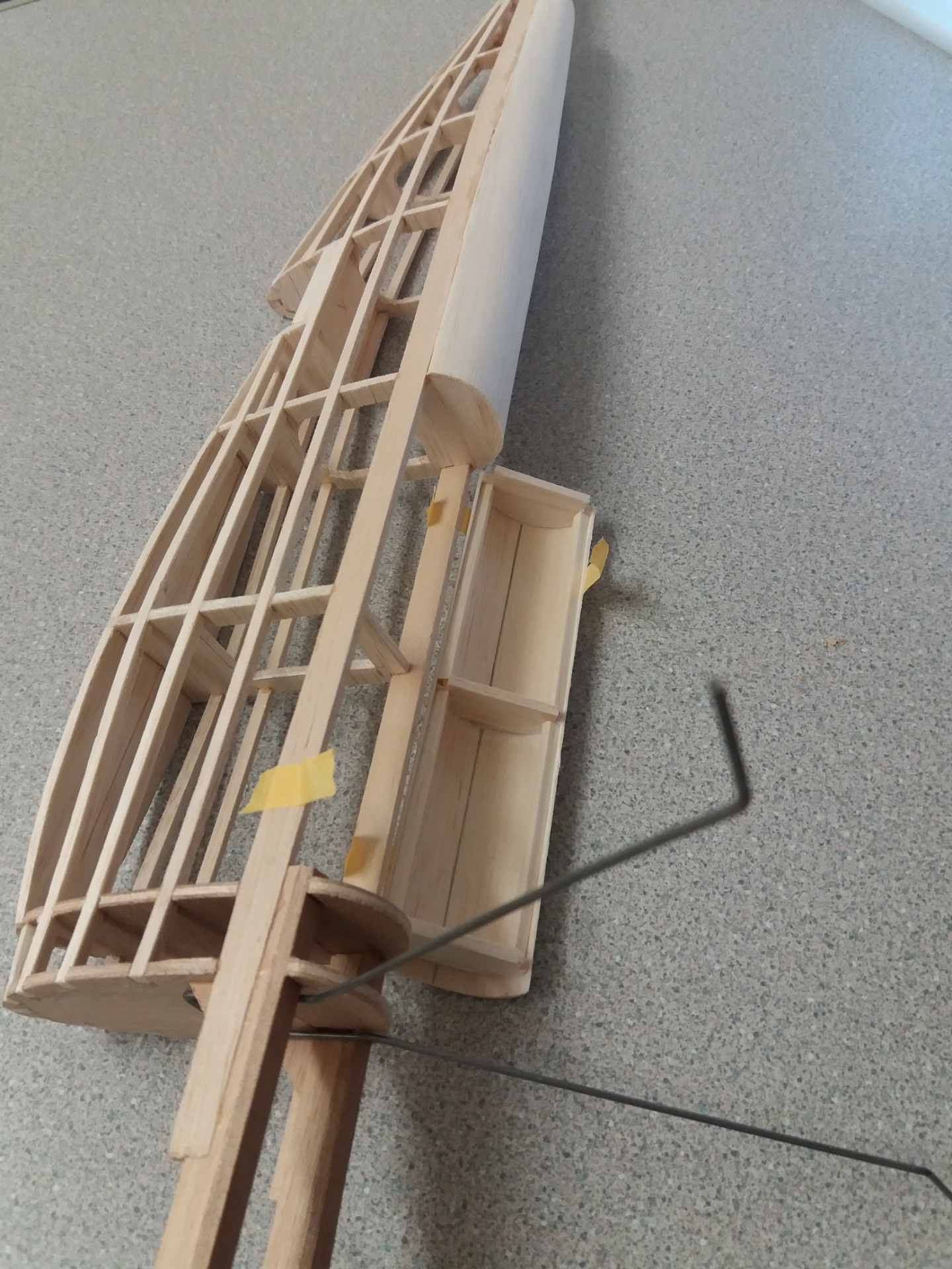

Made some progress! you'll see from the pictures how slim the fuselage is, went with Q's suggestion and sheeted the lower half, need to add some ply gussets around the bearers and firewall but I can't do that until the undercarriage wire is fixed ( wire shown is just a temporary mock up in 1.5mm, having trouble getting any decent 14swg piano wire locally).
since clearing up for the day I've realised I havnt attached the cockpit coming!
A interesting build so far, pictures don't show it but there's barely a straight piece of wood in it, reminds me of a thirtys tether car.

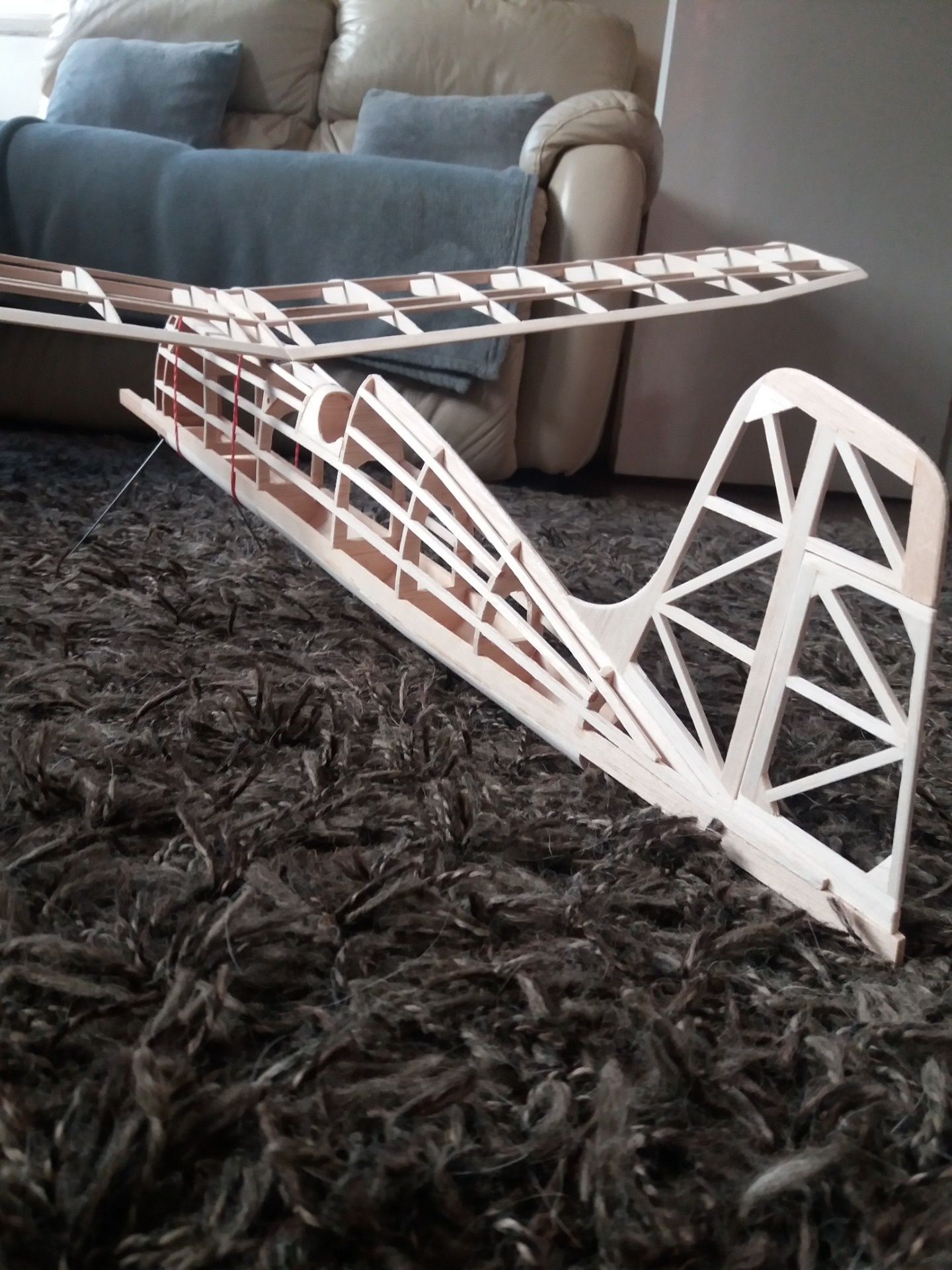

A little progress....but I've got on a problem...using the angle template as drawn on the plan to set the angle of the root rib has resulted in the dihedral under each tip being 2" rather than the 2 1/2" shown!
Need to think about that One, ignore the rough fin etc..all needs sanding to shape.
Thanks: Klipkopwildlife, THE BLACKBIRD, Ralpharr2001
07 Mar 2020 14:09 #23 by Quorneng
Replied by Quorneng on topic Keil Kraft Bantam
paul
The problem is the angle difference on the root rib between 2" and 2 1/2"at the tip is small, about 1 degree.
My suggestion is either:
Leave it as is. I would not expect it to make much difference on a high wing anyway.
or
Very carefully sand the meeting faces of the root ribs a touch to increase their effective mating angle.
Will there be dihedral braces on each spar?

07 Mar 2020 15:02 #24 by paul d
Replied by paul d on topic Keil Kraft Bantam

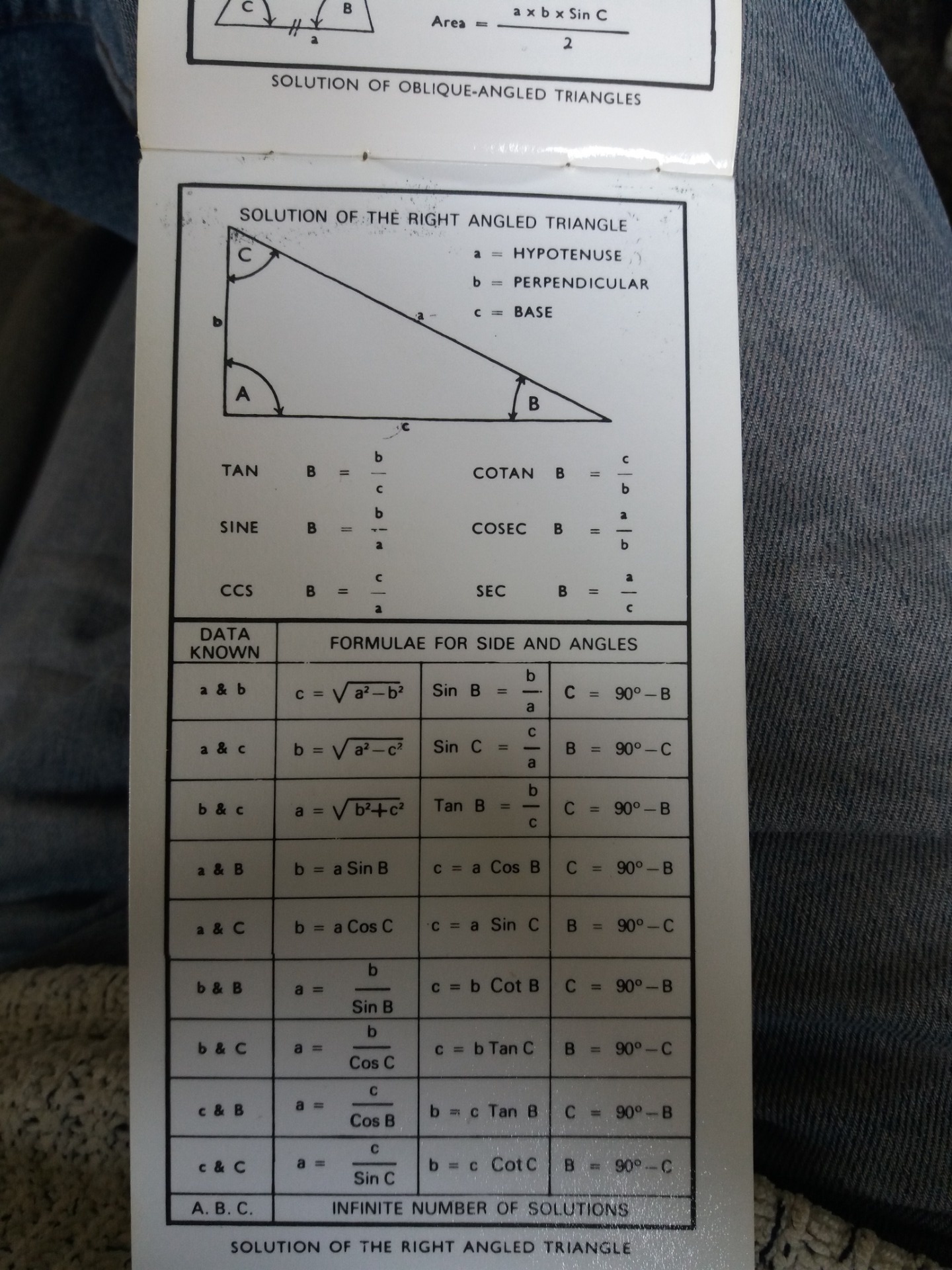

Yes Q there are braces, being as the plan is from the kit there not actually drawn up just marked on the wing plan so I've had to use a little "Pythagoras therum" and trig them out and 2 1/2" dihedral under each tip gives a angle of just about 7 degrees at the root where as the template measures around 84 degrees from the horizontal.
Since my last posting I've realised the template drawing on the plan actually shows it in use ( supplied in the kit?) rather than claiming to be a accurate drawing so ultimately it's my fault.
I will give the ribs a little sand and see if I can win back a bit..
Just in case the above mention of Pythagoras goes over anyone's head you may find the pic below interesting, I used to use trigonometry a lot when I worked full time and sadly find it quite interesting..
taken from my "Zeus precision" book
A useful little book to have around.
07 Mar 2020 15:58 #25 by Quorneng
Paul
If you have the braces correctly set to give 2 1/2" then you could simply not glue the root ribs together and simply rely on the braces. If you think about it gluing the root ribs together does very little for the actual strength of the wing. It is the spars and their braces that transfer the forces from one wing to the other.
The only reason to glue the root ribs together is to resist the effects of the tissue tension so just a bead of glue along any gap between the root ribs would be plenty strong enough although such a process it might offend the purist.
Of course the 'purest' way is to not glue in one of the root ribs. You then set up the 2 1/2" dihedral under each tip, sand the spar ends so they exactly meet top and bottom and only then glue the last root rib in place. It will be at the right angle. ;)

08 Mar 2020 17:32 #30 by paul d
Well the sun was out this morning so it was on with the shorts and out side for a sanding session, sorted out the lack of dihedral last night, I took Q's suggestion and sanded the root ribs, only needed a couple of thou, when I measured it yesterday I didn't take into consideration the the tip blocks are undercambered when finished to match the ribs, by the time I had tickled the root ribs and carved the tips I had my 2 1/2" dihedral under each tip!!!!
Next task is the cowl, plan calls for stiff card ( that'll last 5 minutes) or aluminium sheet but I'm going to try 1/32 ply....watch this space...
