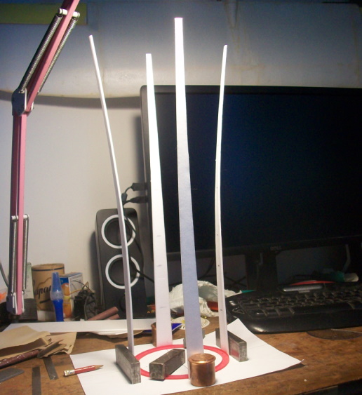

The start of vertical plank construction of the rear fuselage.
It looks a most unlikely way to do it but it does work - honest.;)

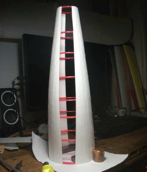

Success!
At this point it is rigid enough to be handled which makes things a bit easier but the down side is each plank now requires more and more 'shaping' to get it to fit neatly.
Next bit. The four formers for the shorter uninterrupted section of the forward fuselage.
The nose and tail beyond these sections will have to be only part built to give access to install the ESC, rx, elevator servo & battery box in the nose and to add the tail plane and fix the elevator pull/pull wires in the tail.
The EDF pulse jet will be added last.
Well that's the plan. :P

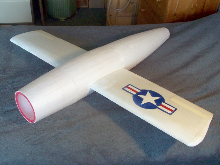

The rear fuselage planking complete.
The first former has been removed, important to do this before the POR get really firm, as it was only required for construction.
The next step is to join it to the centre section.

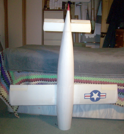

23 Oct 2020 14:14 - 23 Oct 2020 14:15 #23 by Quorneng
Replied by Quorneng on topic V-1 Rebuild 2020
Free flight V-1?
Hmmm. Of course the original was in effect gyro stabilised. It did not fly straight, or even remain truly stable aerodynamically. It had no dihedral but it did have the advantage of the majority of its weight (fuel + warhead) symmetrical about the fuselage centre line with a low roll inertia (the pulse jet perched on top gave significant 'fin' area but was relatively light) so it managed with a small rudder to provide roll corrections.
Apart from any aerodynamic stability issues a solid rocket in place of the pulse jet, particularly in a free flight version, will put weight where it is not really wanted.
I will follow your project with interest.
The fuselage tail section and tail plane.
Access on the underside to the elevator horn
Nose section next.

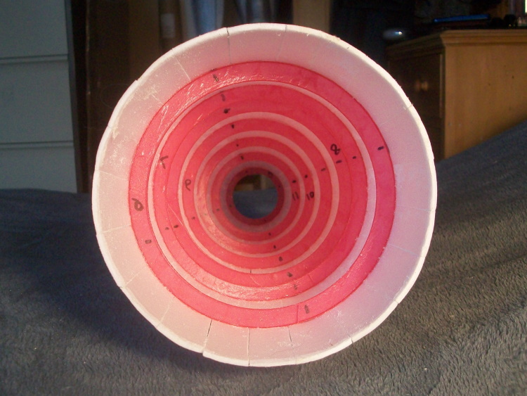

24 Oct 2020 14:18 - 24 Oct 2020 14:19 #25 by Quorneng

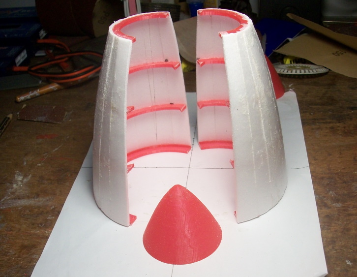

It now actually looks like an aeroplane. ;)
Although the nose section was planked vertically in one piece like the rest of the fuselage its formers were printed in two halves and were just POR glued together. This allowed the completed nose to be split in half once the planking was complete.
The lower half will be glued to the fuselage to give somewhere for the 'electrics' to be installed. The top half will modified to incorporate the battery hatch and will eventually be glued in place to restore the full strength.
Next step is to build the front support and fin for the EDF 'pulse' jet.
Last edit: 24 Oct 2020 14:19 by Quorneng.

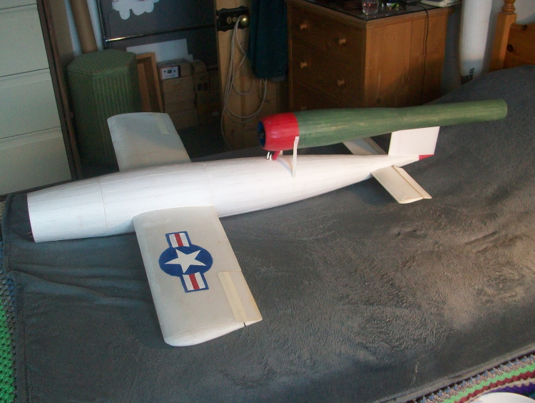

Getting there! The 'pulse jet' glued in place.
It is temporarily braced with masking tape until the glue sets.
The EDF itself is supported by a substantial printed 'strut' that goes right down through the fuselage and transfers the thrust onto the face of a fuselage former. It and the EDF wires will be surrounded by an streamlined cover.

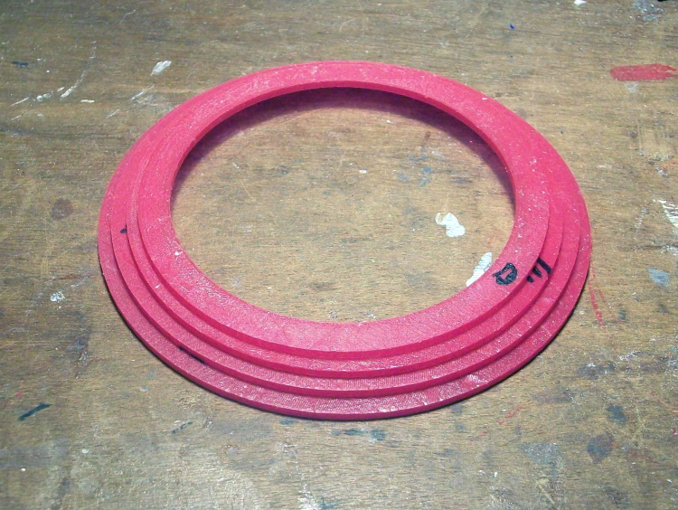

26 Oct 2020 16:49 - 26 Oct 2020 16:50 #27 by Quorneng
The EDF mounting complete and the 1/2 shell nose section in place.

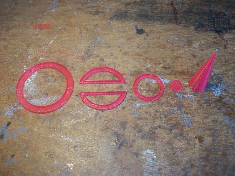

Working out how to install the 'electrics' in the nose is proving to be quite a challenge as the printed formers are almost impossible to modify in situ. The problem is the battery and the ESC both require a specific size hole to be cut in the skin and the formers get in the way.:(
The best solution has been to redesign and replace the required formers - thank goodness for the relative ease with which a glued in former can be removed.
Two of the original semi circular nose formers adapted to support the battery box and the ESC.
The elevator servo and rx need no hole in the skin so only require simple supporting in the nose - I hope. :P
Last edit: 26 Oct 2020 16:50 by Quorneng.
