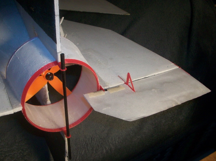

Replied by Quorneng on topic V-2 with wings rebuild 2021
Agonising slow progress. The first of the new control surfaces with a pull/pull horn. The others should be quicker.
The area of the surface in the prop wash can be cut back if required.
The vertical rod will link the top and bottom rudders as well as carry a small 'rudder' surface in the prop slip stream.
Last edit: 14 Dec 2020 18:18 by Quorneng.

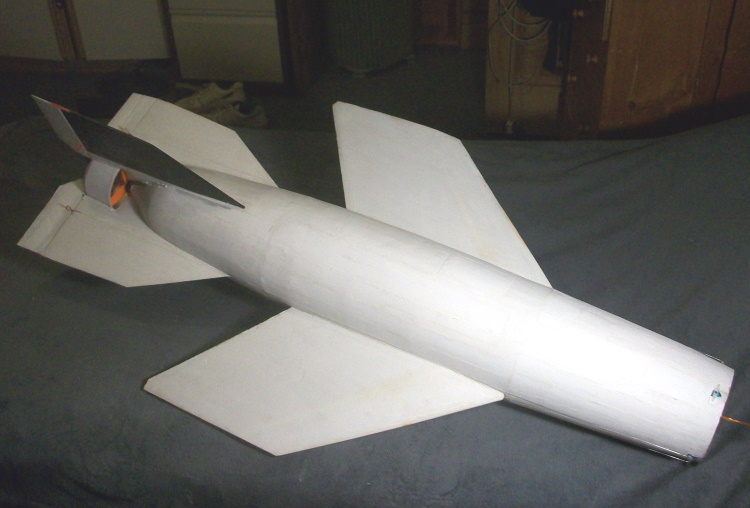

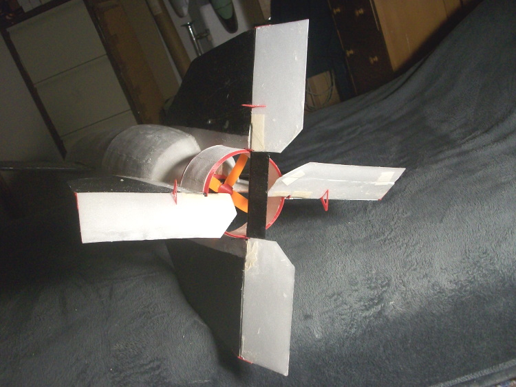

15 Dec 2020 21:30 #81 by Quorneng
All four control surfaces done well I suppose it is only three really. The top and bottom rudder are fixed together.
Servo and pull/pull lines next.
I suspect the mid bulge of the fuselage will require the lines to go through a guide.

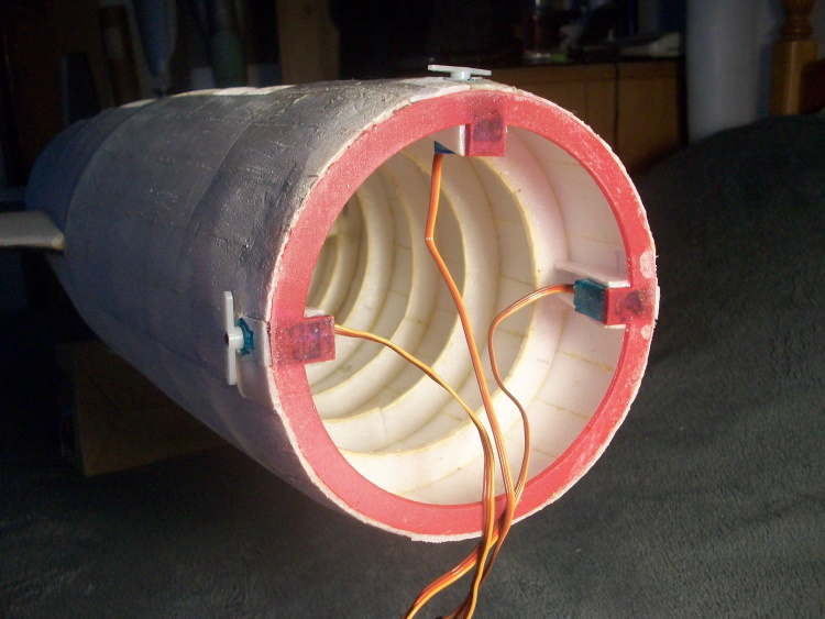

16 Dec 2020 16:53 #82 by Quorneng
The three servos mounted in a specially prepared fuselage former.
They are mounted 260 mm further forward than in the original installation so helping to achieve the required CofG. The servo is now 1070 mm from its control surface. :woohoo:
The first elevon connected using 20 lb nylon monofilament line.
The surface has a big deflection so that the 10%? gyro action should a strong effect. It could of course result in a spectacular gyro controlled crash.
At least with external lines it is relatively easy to change which hole is used in the servo arm. ;)
Thanks: Eric, Klipkopwildlife, paul d, crash happy

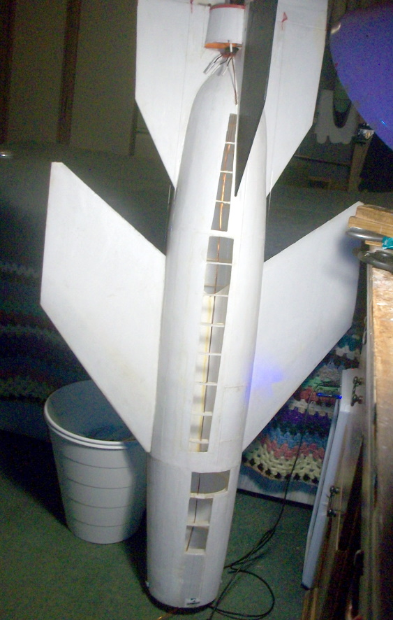

19 Dec 2020 18:07 #90 by Quorneng
Top skin all made good.
Now I have to wait for the Lemon 'stab' rx to arrive.
For CofG reasons I expect it will have to be in well in the nose along with battery.
