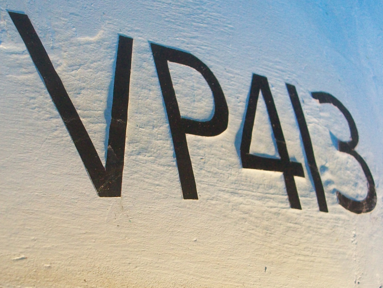

In the course of the latest repairs (29Mar22) the repainted areas required a light coat of clear acrylic spray to restore the finish to match the rest. Whilst doing this I noted the under side decals (hand cut paper) had a tendency to lift. They are stuck on with Pritstick which works well but the edges of the paper are still 'open' and the underside can get wet with a belly lander.
So I decided to give the decals a heavier spray to help seal the decals completely but it proved to be a big mistake. The extra spray started to dissolved the underlying foam! :woohoo:
The paint surface and the paper were not effected so result each character now stands proud of the surface on a raised 1 mm pedestal exactly following its shape. .
Now if you wanted to achieve this effect......
Overall it probably won't effect its flight performance much but it does look odd and of course the characters are now much more vulnerable to scrape damage in a belly landing. The exact opposite of what I was trying to achieve.
Drat and double drat. :woohoo:
I fear a big new skin 'insert' will be required and those letters took ages to cut out.

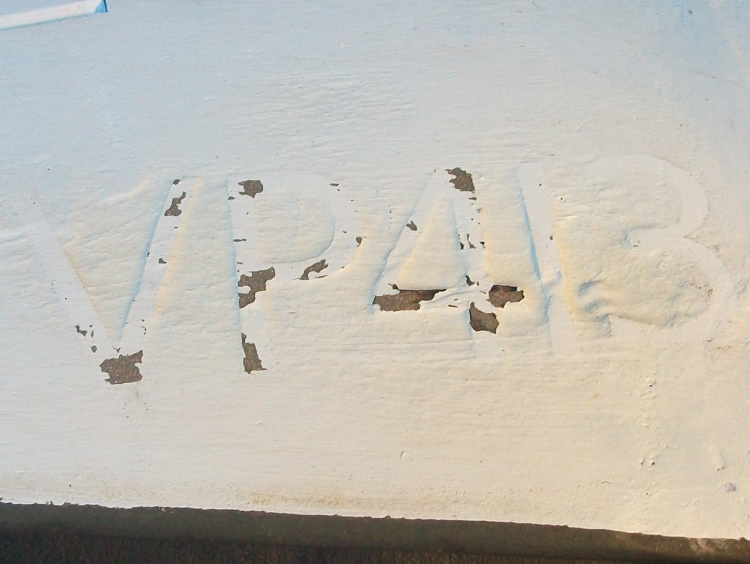

With the decals removed the 'pedestals' resulting from the foam collapse become clear.

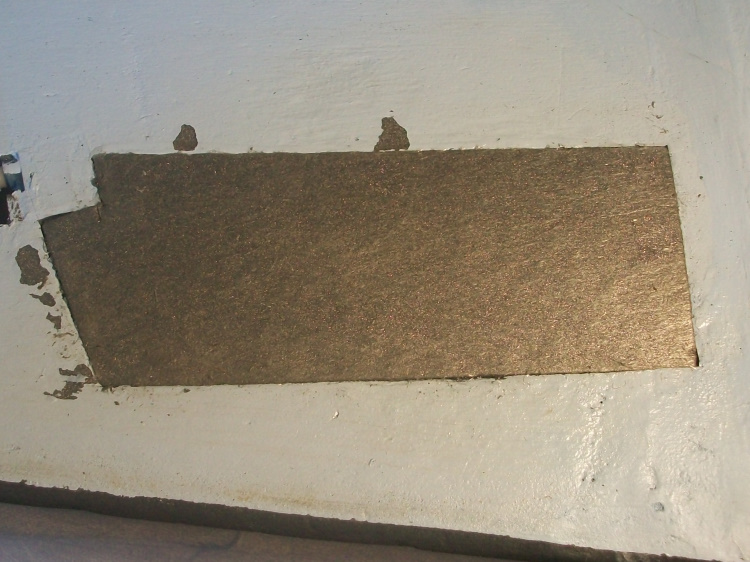

Nothing for it but to cut out the damaged skin.
Not that easy as the skin was very well bonded to both the foam shear webs.

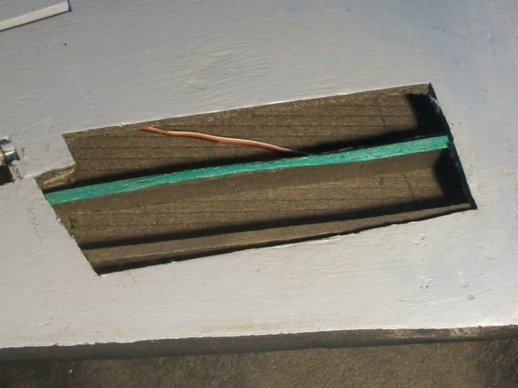

This bond is very important for the ultimate strength of the wing so it is vital the replaced skin is bonded to the shear webs equally as well.
