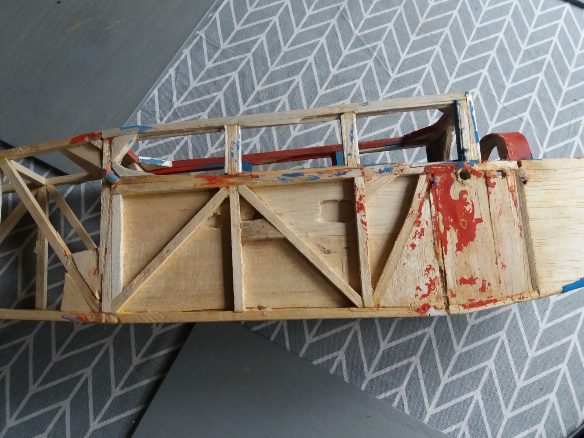

Had a few spare hours today so made a start in getting some off the excess wood out of the fuse.
before:
After:
Not sure what the idea of all the internal sheeting was about, the structure is perfectly sound ( bit scruffy) without it.
before:
After:
