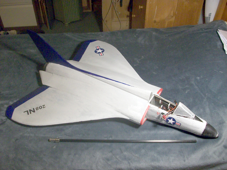

23 Aug 2022 21:37 - 23 Aug 2022 21:40 #33 by Quorneng
Replied by Quorneng on topic Douglas F4D Skyray
Slowly putting it back together.
I finally solved how to change the prop.
First it needed a long 8mm socket extension. Long enough, actually a carbon tube, to reach the prop nut from an inlet!
Once undone the 4 blade prop just fitted through the RH inlet but not the LH one. :huh:
The next problem was how to place the prop on the motor shaft. Solved by undoing the motor bolts and manipulating it through 90 degrees so the 3 blade prop could be fed through the exhaust & coaxed onto the shaft. The motor was carefully turned back to face forward.
The prop nut was glued into the socket and the extension fed down through the inlet. With the motor held directly facing the inlet the prop nut was screwed down. The motor was then bolted back in place on its mount.
Unfortunately this was not quite the end as the whole process had to be repeated to extract the 3 blade as the tips had to sanded down a touch. It was about 1 mm bigger diameter than the 4 blade one and that was already a very close fit in the duct! :woohoo:
The three blade is a 3045. Just showing off the zoom on my new camera. Those are 2 mm raised numbers.
As hoped it absorbs a full 10A on the 1000mAh 4s, which is twice that of the 3035 4 blade, showing 154W and a lot more thrust. ;)
Now to fill and finish off the paintwork - again ready for the next crash! ;)

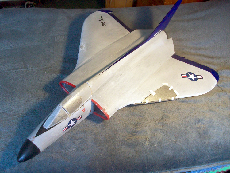

30 Aug 2022 15:54 #36 by Quorneng
After flying into the dreaded willow plantation at the DVMFC on the 27th.
It is now structurally back together.
But the major impact on the left wing ripped off the LH elevon and in so doing stripped a tooth in the servo so it will have to be cut out and replaced.
The biggest worry is there might not be enough 'free' servo wire to make a solder joint and to heat shrink.
As the Skyray is now getting a bit dog eared I am seriously thinking about building another blown up by 1.358 to give a 36" span. This would then be at the same scale as the XPS Hawker Hunter and others. It would also allow true a true scale inlet and exhaust to be used.

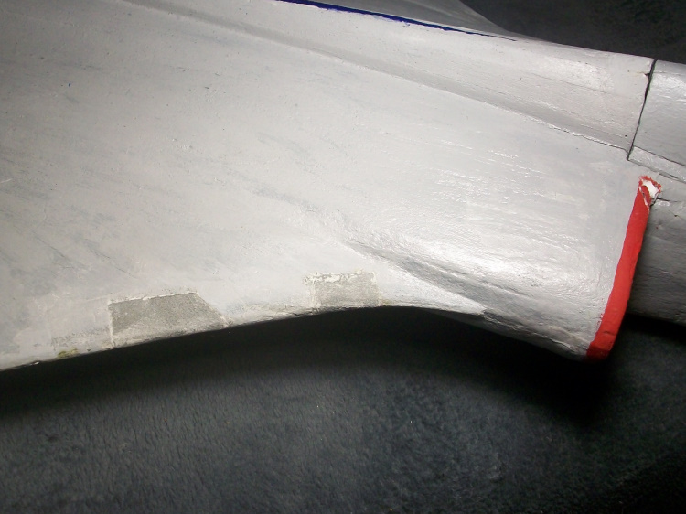

As reported in "Been flying" the Skyray is under repair after flying through the top of a tree.
There is another similar repair on the other wing but such inserts do not compromise the strength of the plane.
The Skray is now officially "a bit tatty". :(

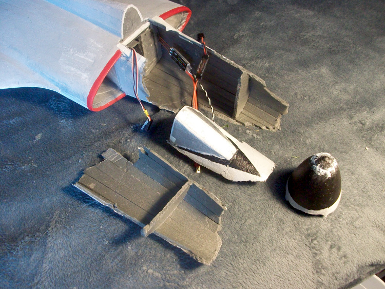

22 Sep 2022 13:20 #43 by Quorneng
After the 20Sep22 crash I intended to not bother to repair it again and to build something else.
But I changed my mind due to the complete lack of damage beyond the destroyed nose.
First job was to 'make good' the broken end of the fuselage.
The battery goes into the hole.
At the same time I have replaced the OPTO ESC and UBEC with a 20A ESC with BEC and "external" heat sink to simplify the wiring inside the cramped cockpit space. Its been tested.
The receiver will be replaced as well.
Now I have just got to summon up the enthusiasm to build a complete new nose section. ;)

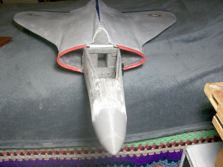

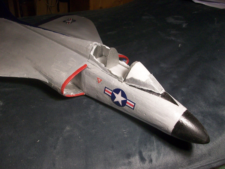

25 Sep 2022 21:26 #44 by Quorneng
The new nose built & added to the fuselage.
The 20A ESC with cooling fins is in place.
Still quite a few bits to be added for the existing canopy to fit properly.
To completely avoid the radio issues it has had up to now I am toying with using a so far unused 35 meg Corona rx. It is 'synthesised' so it needs no crystal.

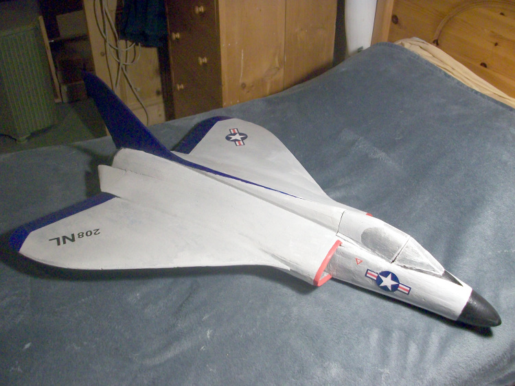

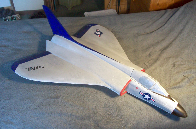

01 Oct 2022 22:43 #45 by Quorneng
The Skyray is all back together and painted.
And it does have a 35 MHz rx with the aerial running down the top of the fuselage spine, up the leading edge of the fin and the remaining 10" dangling off the top. ;)
Still needs the decals adding on the cockpit sides but the colour printer has stopped working.
