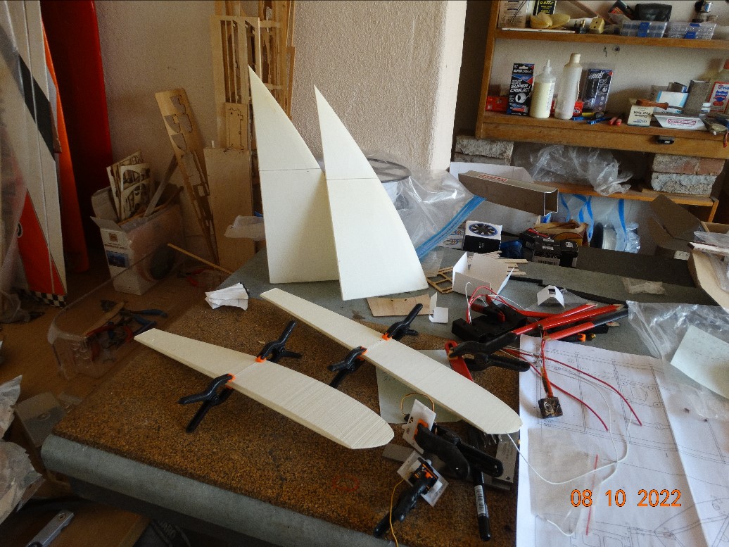

I've started gluing parts together.
Outer wing panels and ailerons
10 Oct 2022 08:51 #32 by Eric
Replied by Eric on topic Plane Print Seagull
I hope you've made lefties and righties! [badass]
10 Oct 2022 08:58 - 10 Oct 2022 08:59 #33 by Klipkopwildlife
Replied by Klipkopwildlife on topic Plane Print Seagull
You betcha, although it is a bit idiot proof, there are even markers that will match up when you get it right.

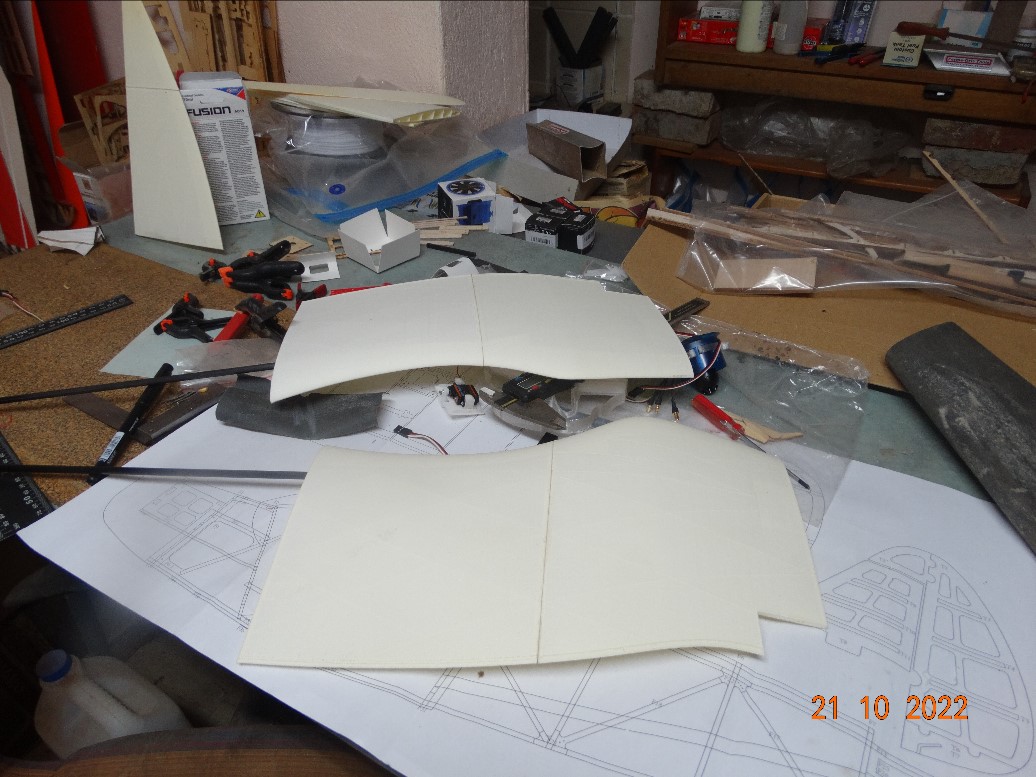

21 Oct 2022 18:07 #38 by Klipkopwildlife
My life isn't my own at the moment but I did manage to look at gluing the wing panels together.
The small slots you see take small PLA tabs to aid registry. As you can see there's also a 6mm carbon tube that goes through the inner panel and 100mm into the 2nd panel.
The lines are only microns of overtravel where the inner supports are located, they'll sand out (I hope).
At this point I noticed that the tube in the port inner was super tight. Then I realised the panel itself was very heavy. Further comparison showed the Starboard inner panel at 21gm, the port inner at 33gm, oops. I've had to print another.:(

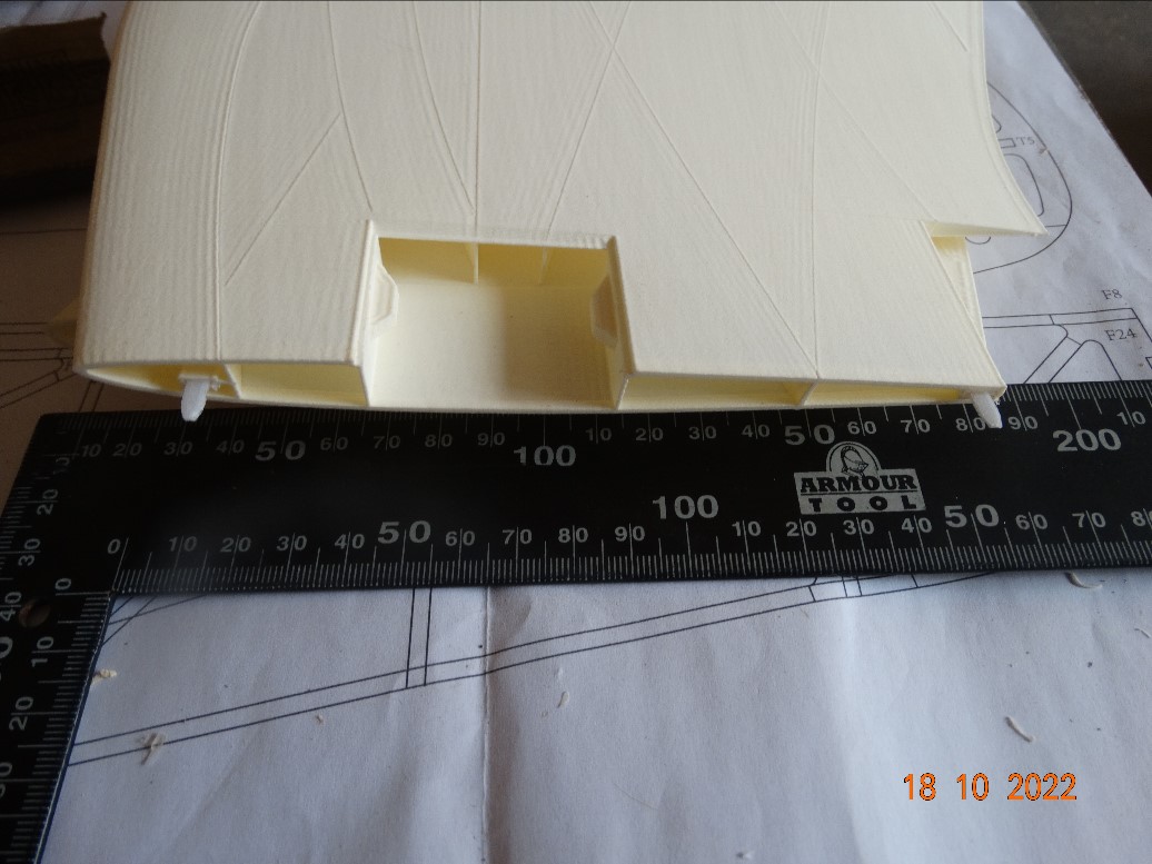

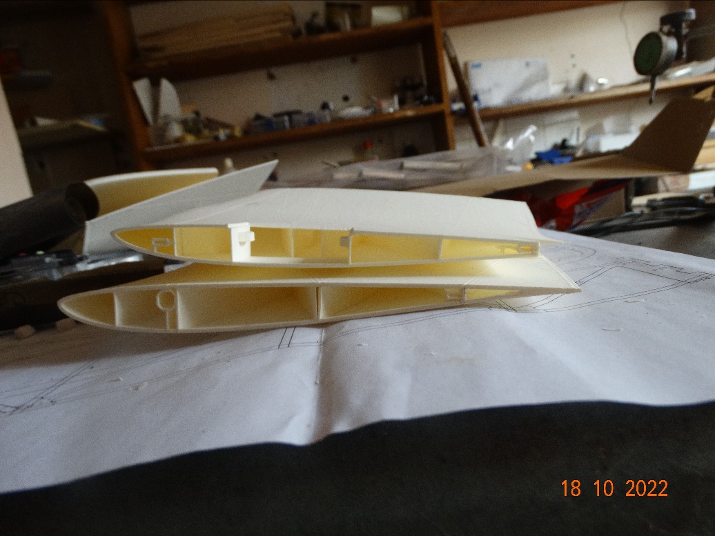

22 Oct 2022 10:33 #39 by Klipkopwildlife
That's the inner panels glued together.
It remains to be seen if I can get the carbon rods out, the manual says don't glue them!
I've already glued the outer 2 sections together, glue the halves together next.
