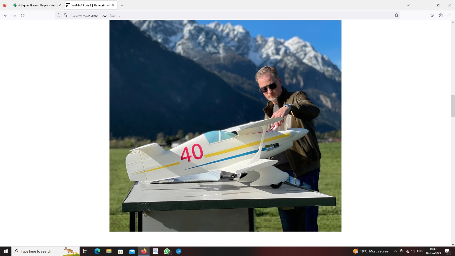

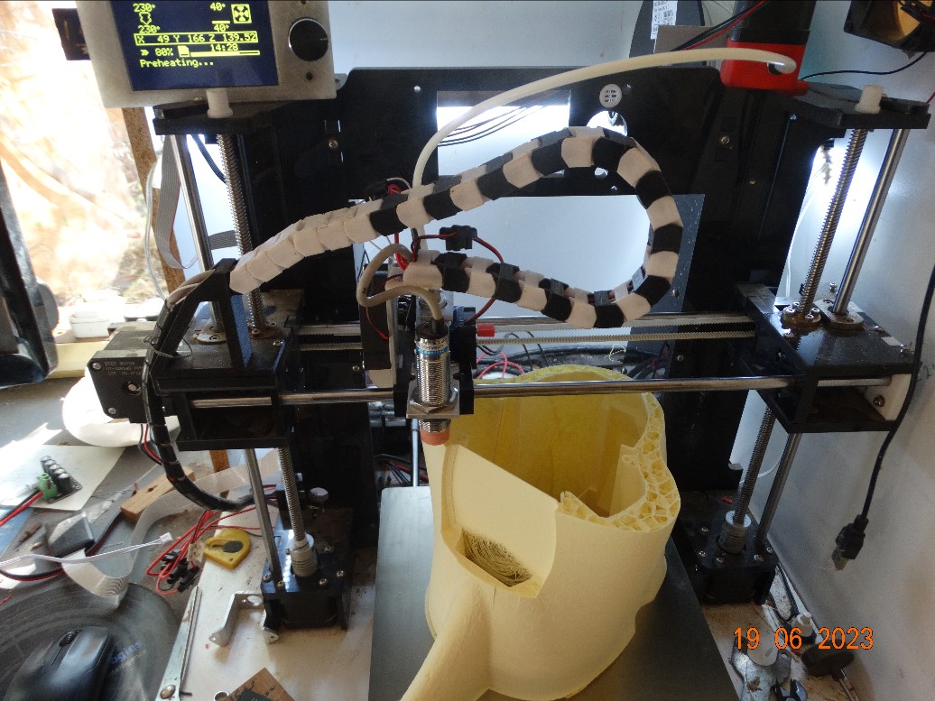

As you may know, the Rise Nano is a Plane Print model, when they offered me a 15% discount on this I couldn't resist.
I'm a sucker for large models, Biplanes and "T" tails
Over 14 hours into the print and another 5 to go, and it's not the largest part!

19 Jun 2023 09:46 #2 by Quorneng
Replied by Quorneng on topic Wanna Play II
Impressive but that's a lot of faith that nothing will go wrong during such a huge print!
19 Jun 2023 17:37 #3 by Klipkopwildlife
Replied by Klipkopwildlife on topic Wanna Play II
Since I discovered that I had assembled my extruder drive incorrectly and the pressure spring was way too tight I am now at the stage where I switch on, load my settings, plug in the memory card, press the button and go. The last 3 weeks I've been doing longer and longer prints. The longest print on this plane is 22hours! The 19hour print I got lucky, I noticed the load shedding change gave me a 20hour uninterrupted window so went for it, it might be a while before I can do the 22hour one!
I managed to resist the temptation to get up in the night and check it!
Thanks: Flytilbroke, Quorneng, THE BLACKBIRD, jon.in.swansea

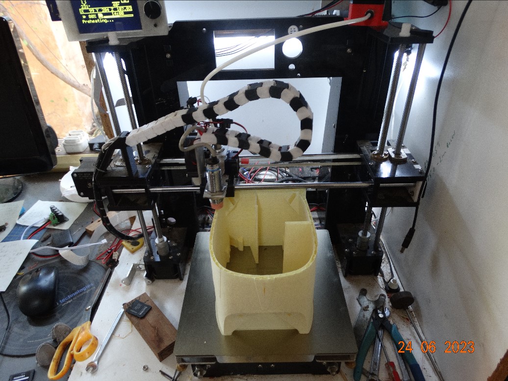

24 Jun 2023 12:32 #5 by Klipkopwildlife
I had another window of opportunity, this is 14hrs into a 22hr print.
After the Nano this is going to be big!

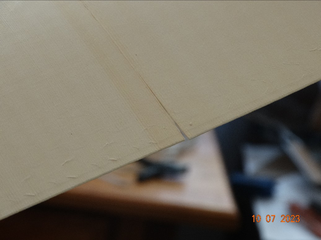

16 Jul 2023 11:58 - 16 Jul 2023 11:59 #11 by Klipkopwildlife
If you look at the failed print picture you can see the trailing edge has pulled away from the bed, here's a better view
It's about 4.5mm
I had similar problems with the Nano wings but not to a great extent.
Easily solved with gap filling Cyano.
Last edit: 16 Jul 2023 11:59 by Klipkopwildlife.
16 Jul 2023 12:11 #12 by Klipkopwildlife
I'm stalled on the wing printing, we are currently 4.5hrs off and 3.5 on, grr
So I've started to glue things together,
The edges to be glued are lightly sanded and interconnections inserted,
Add Cyano and push together.
16 Jul 2023 13:56 #13 by jon.in.swansea
Replied by jon.in.swansea on topic Wanna Play II
I tend to include a 3-4mm brim when printing LW-PLA, especially for parts with some height.  I have yet to have had a pull up.  And the brim pulls off easily and 10s of sanding and all is go.
16 Jul 2023 14:18 #14 by Klipkopwildlife
There's the thing Jon, it's got a 3mm brim, I'll up it to 5mm, I have to wait for a 12hour window before I can test.
