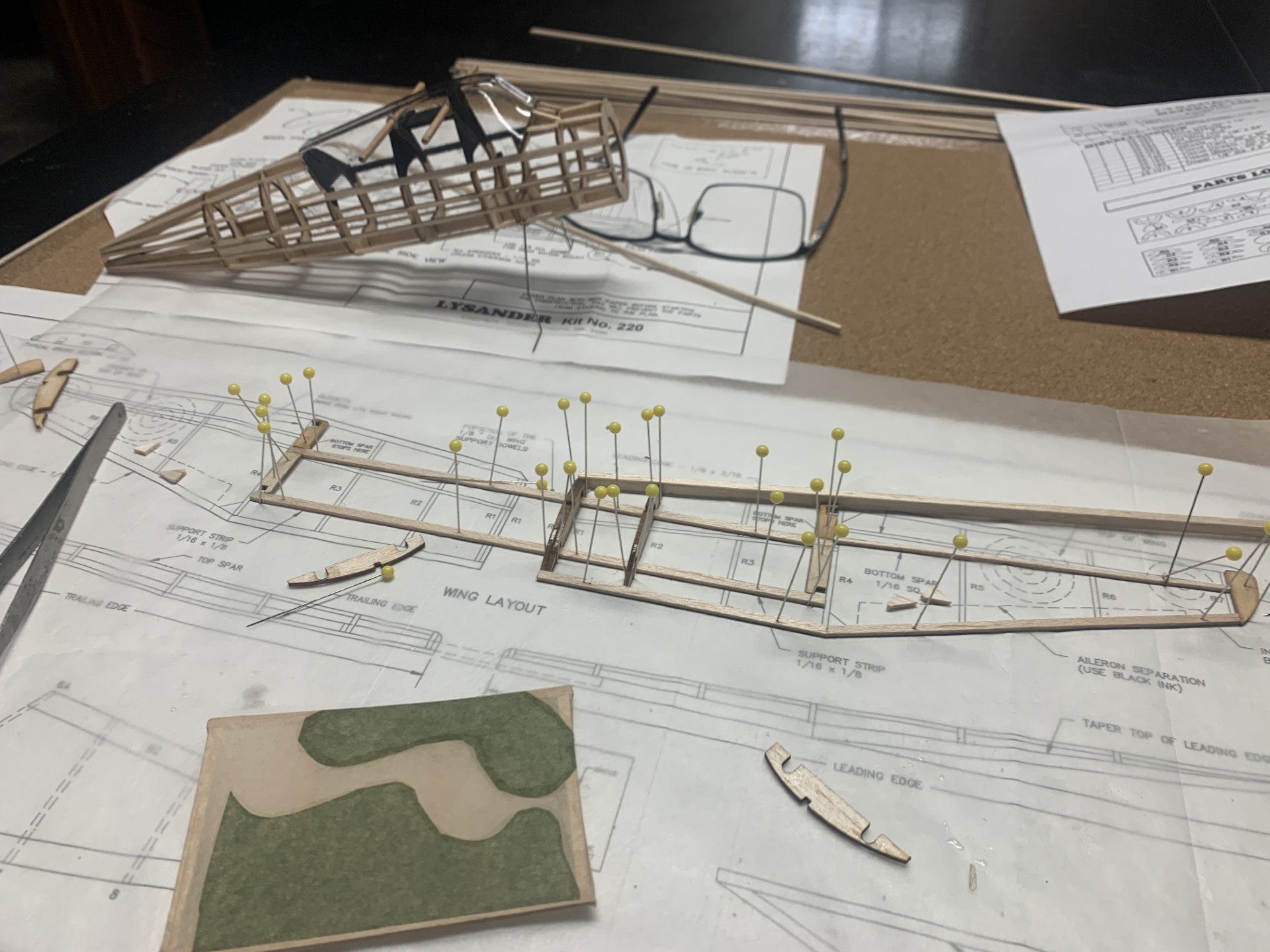

i have the fuselage structure complete. i have done a camo test panel with two colors of tissue that i think will work.
just starting on the wing which i am building in one pc just to try to keep them the same and will cut apart after.

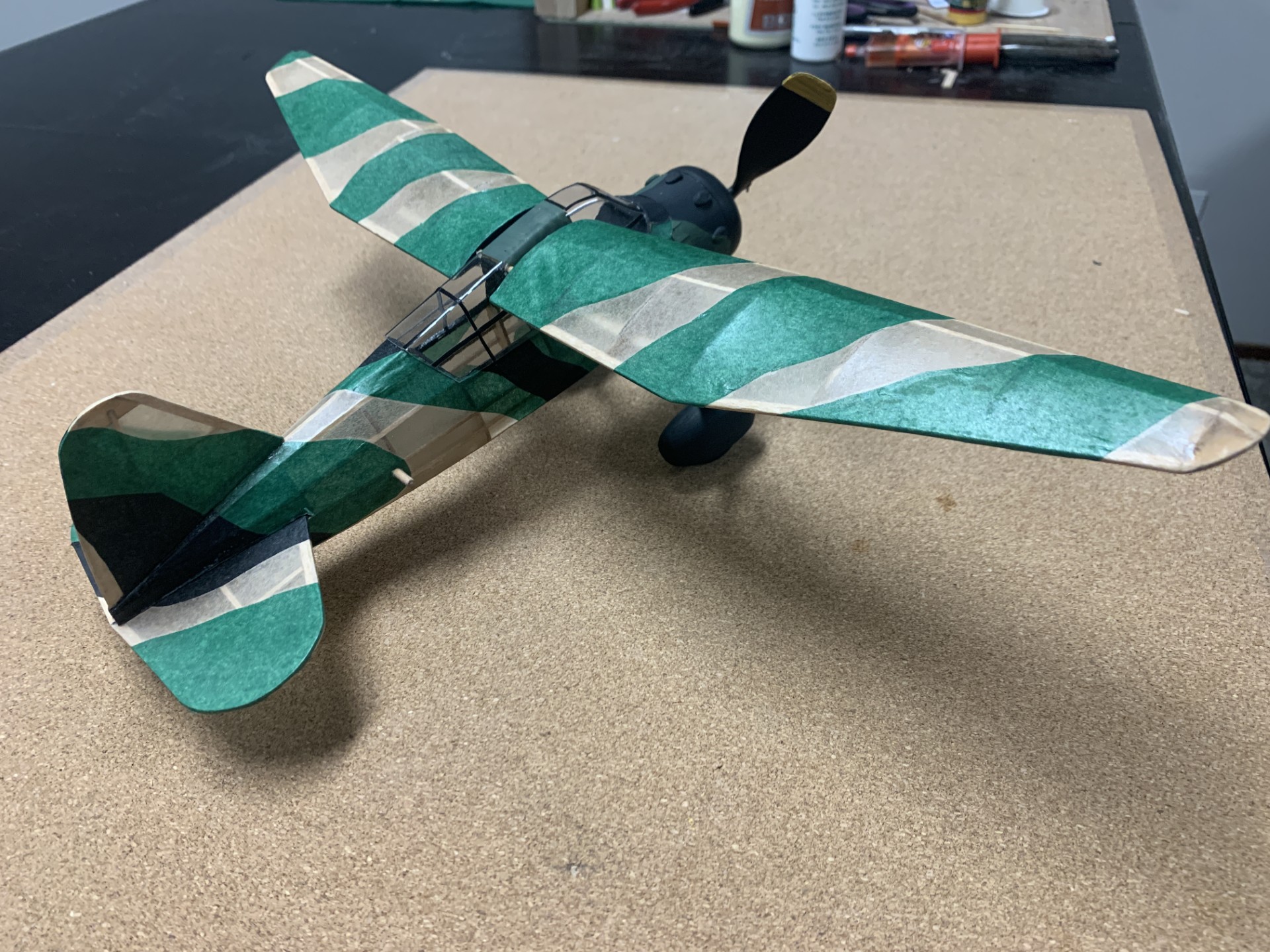

For the camo i put on the light color tissue first and then shrunk it with water, Then I cut out camo shapes. i just laid the camo cutouts on the previously covered surface then with a small paint brush and a watered down solution of carpenter's wood glue i carefully brushed the solution around all the edges of the camo, (a thin line just to stick it down). then i water shrunk it again, i did the third color the same. but the third color is three layers thick and some of it didn't shrink as well. i don't think i would do 3 colors again. the issue with the way i did it is, a thin glue line is visable, i don't think it distracts from the effect.

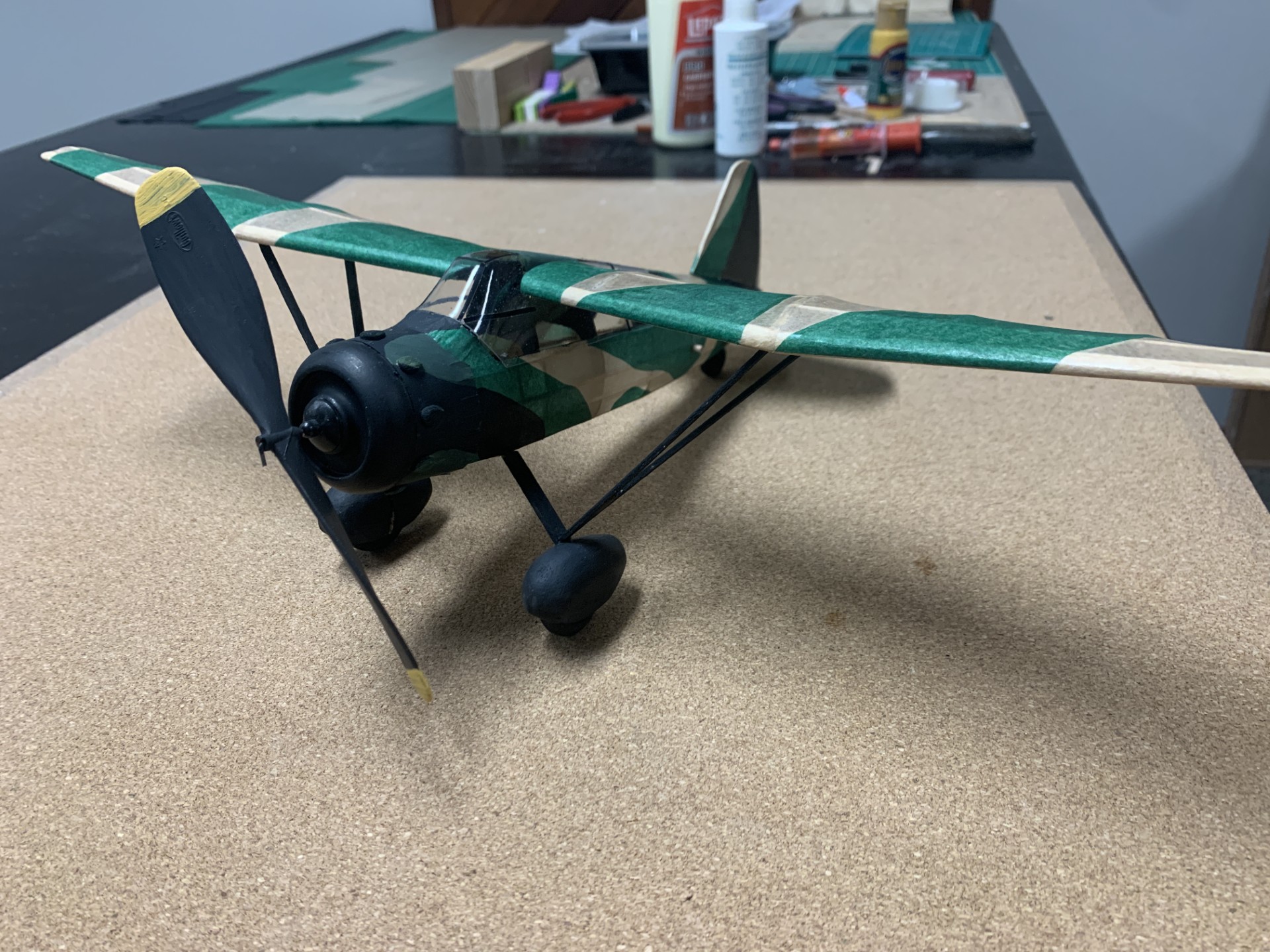

The wings. i pre fitted the canopy. i pre fitted the wings. then i pre fitted the canopy and wings together. lots of fitting and adjustments to get them to sit correctly. then when i was ready to glue the canopy down i put the dowels through the canopy, slide the uncovered wings onto the dowels. then with the dowels, wings and canopy centered as an assembly i was ready to put that assembly onto the fuselage. i put a dab of 5 minute epoxy on the top fuselage platform rite where the dowels would sit. then holding my breath and all puckered up i put the canopy assemble onto the fuselage. (i sat and held the whole thing in my hands until the glue set, it took longer than 5 minutes) once the epoxy dried i slid the wings back off and covered them. final assembly, i CA'd the dowels to the end wing ribs. it took me a long time to think of how to do that and keep it looking good. there is no way to that i know of to get those wings to sit perfectly horizontal. it is all glued together and i think it came out pretty good.
The cowling, i cut out the paper section, rolled it up and taped it together, slid it over the front, fitted it, then glued it, it wasn't too bad.
I saw the issue you had with those inner wing ribs and addressed that rite off the bat. i carfully detached them from the sheet balsa, laid them on wax paper and soaked them with CA glue so they are stronger.
